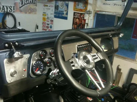

Got this rocker switch panel and a couple relays delivered for $115. Custom ordered Wednesday at noon and delivered at noon today. Not too bad. Bought it from wiringproducts.com

21 months later and she's alive! She started up right away the very first time. Pretty amazing feeling and very gratifying. It was a lot of time and money but well worth it. Hopefully we'll take it out for a spin tomorrow!
