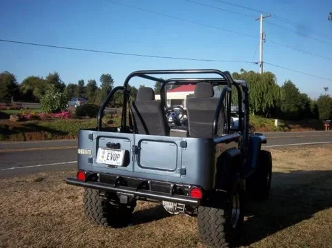

Some better pics. Still not quite done but at least I can drive it.
nice :cool:
not that like the steering wheel so much, but hey :cheers:
Alignment guy just told me my castor was -3.5 to -4 degrees. After reading other threads it makes sense why the 40 was all over the road at higher speeds.
Just bought some 6 degree castor shims from Orangefj45. That should help quite a bit hopefully.
