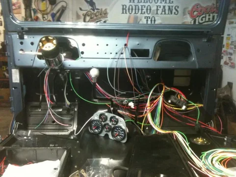

Got a bunch of stuff ordered. New warn hubs, ignition components, fuel components, steering column, and more. I'll probably swing by Metal Tech and pick up one of their clusters and led kits sometime next week.
Also ordered a 6 gauge set from Marshall Instruments. Has anyone ever heard of them? I did some research and couldn't really find any bad reviews. I'm having them change out the silver bezel on them to the black bezel. Looks a lot better I think.
SCX Blueline Performance Gauges.

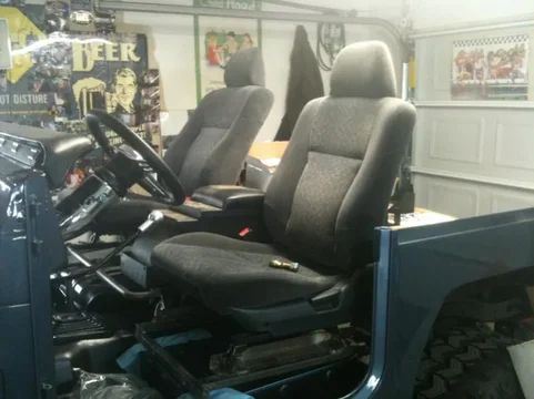

I think the next step is to find some seats, get them mounted, then install the steering column and figure out all of the linkage. It's going to be a tight fit.
Bought some seats today and got them all fabbed up. Taking the seat frames to the powdercoater tomorrow.
Also mocked up the steering column. Getting closer everyday. Here's some crappy cell phone pictures.
