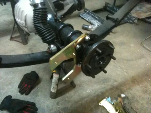

Doing the rear disc conversion. Trying to flair some brake lines and it's not working out too well. At all.
We may end up going that route. I bought 25' of line to do the whole system and a flair kit but they're not looking the best.

Single flared lines will never hold the hydraulic pressures in a brake system , they must be double flares at the correct matching angle to the fittings and line material. This is safety stuff , no room for hacking it here .
If you are having issues with your tool try the kit from Matco . $60-some dollars , much cheaper and way better than Blue Point or any other kit I've seen. Their kit has a c-frame that indexes itself on-center every time . No more off-center flares that leak or crack. I've had mine now for ten years and loaned it out quite a lot - still works perfect.
Sarge
Good to know.
The flair kit my buddy had didn't go to a small enough gauge so I bought another and the c-tool never wanted to stay straight. At least with 25' we'll have plenty of practice.
That's the issue almost all of those kits have . As you tighten the c-frame they can walk off-center and ruin the secondary flare . That design is also the reason why they break the little folding dies' tip off . I couldn't believe the difference the Matco's design makes and the quality of the flare it produces. They look as good as factory hydraulic flares and sure don't require overtightening the tube nuts to stop leaks !!!

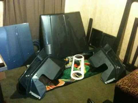

The tub is finished along with all the other large parts. I'm very happy with the color of paint and how well everything turned out. That raptor liner is some pretty heavy duty stuff.

Heres a pic of my buddies spare bedroom...
