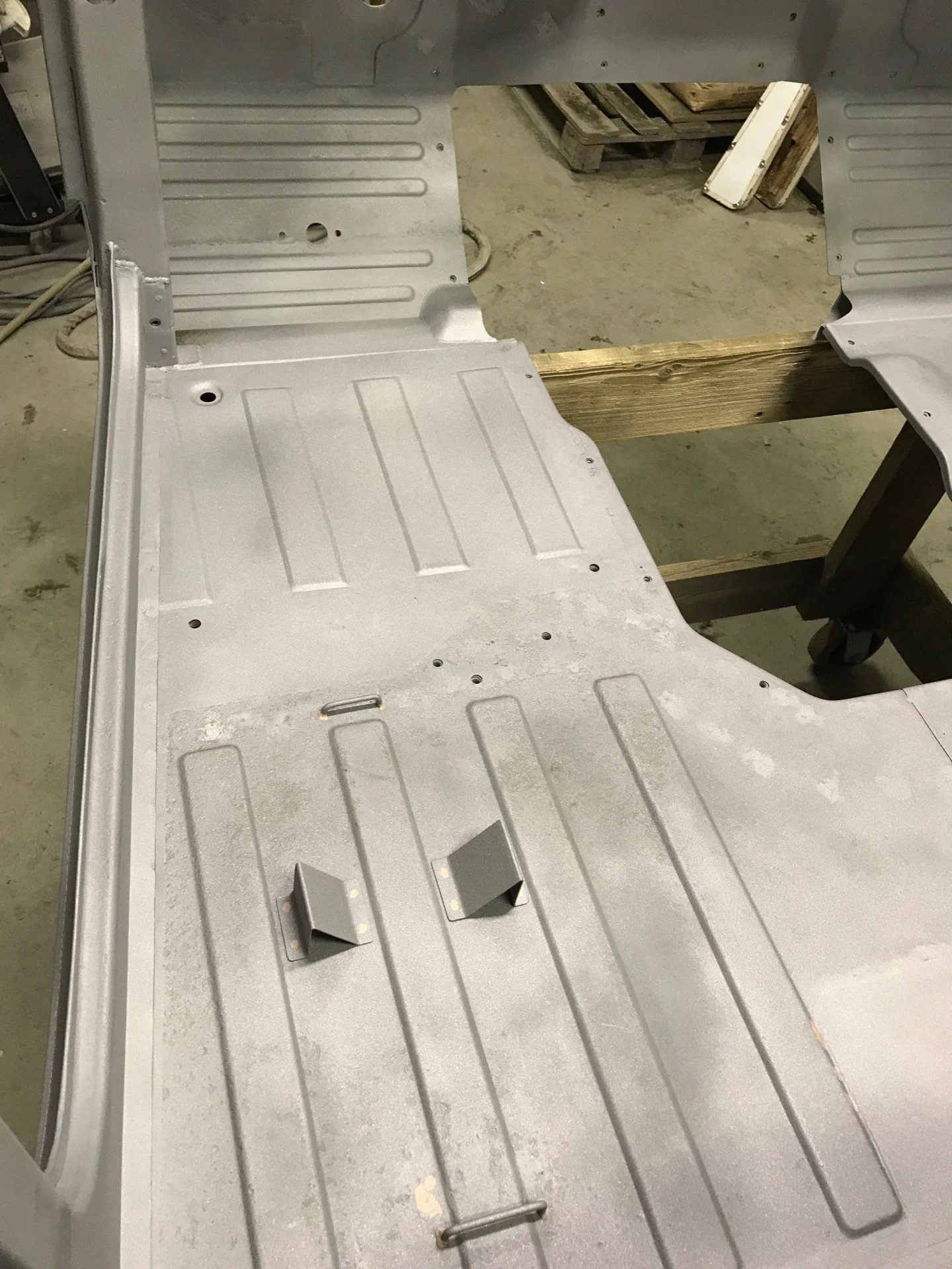

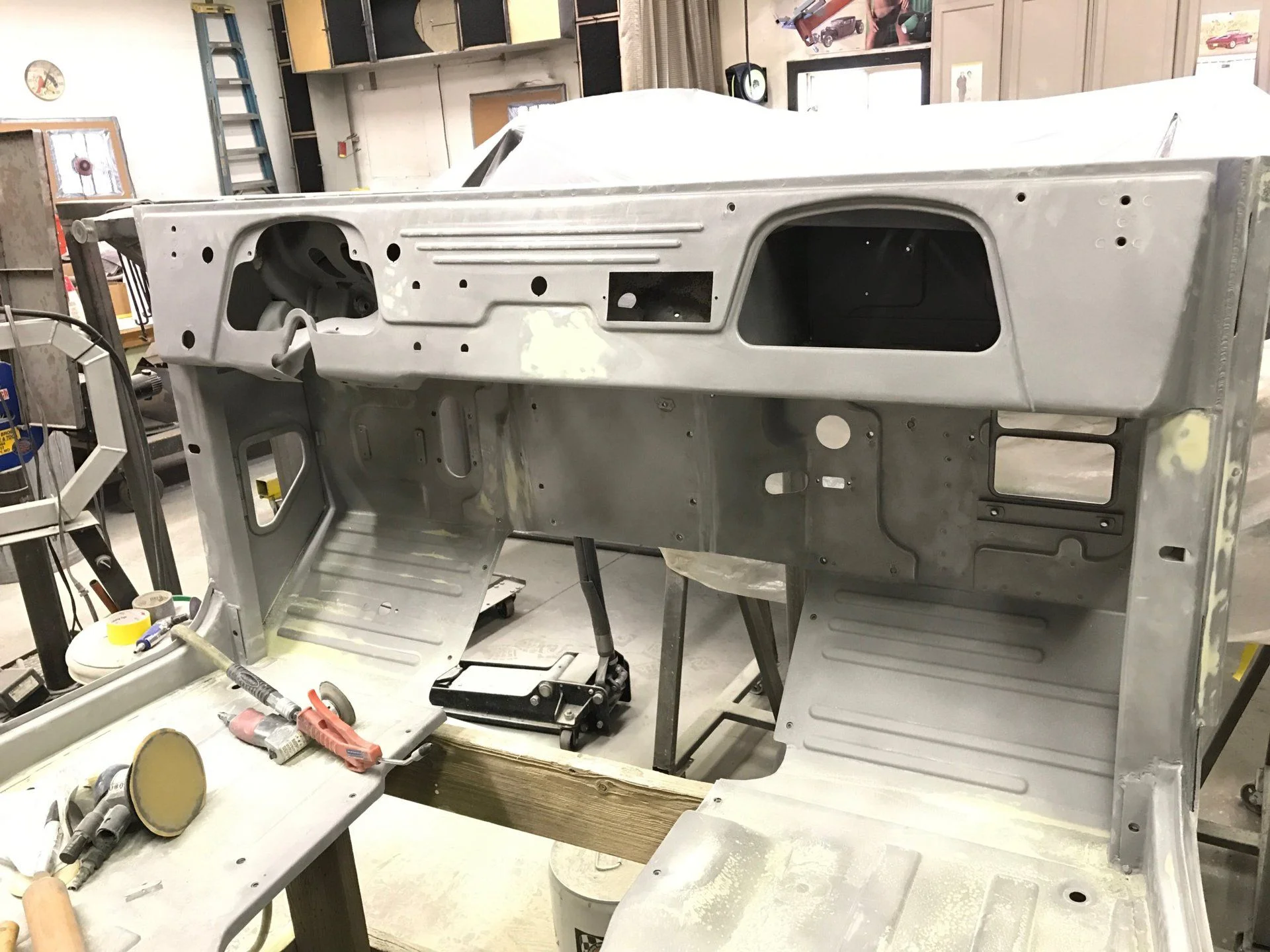

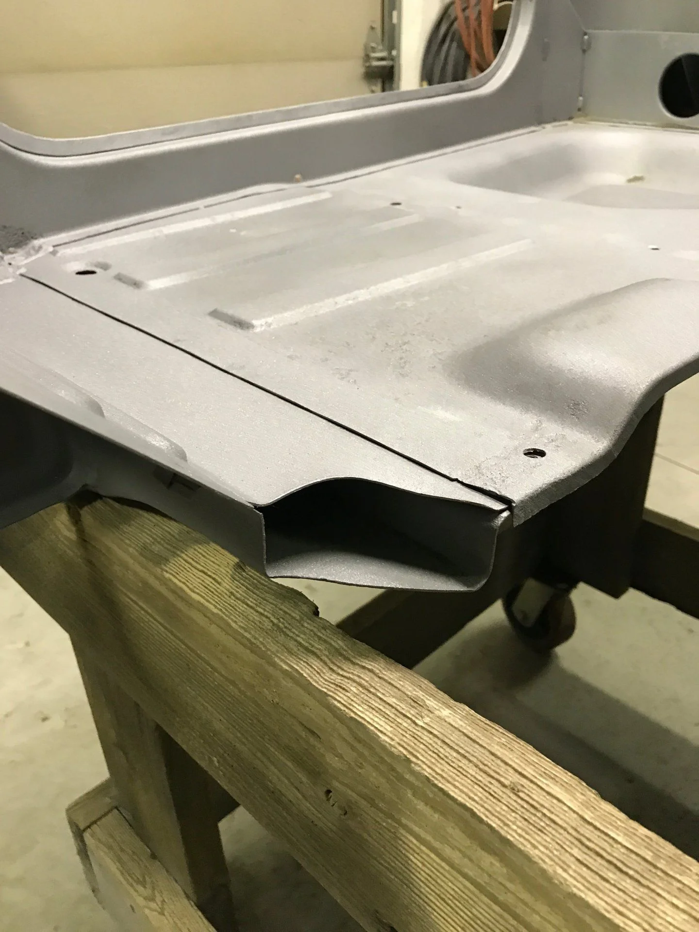

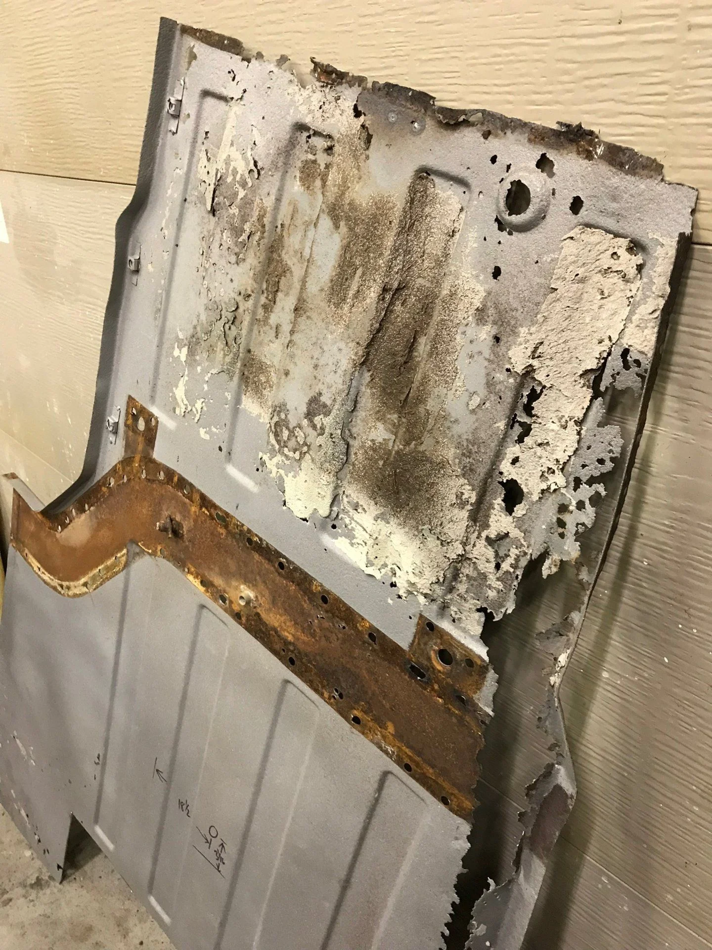

Tim used an 1/8th inch, 45 degree bead roller to make the raised ribs in the driver's side floor. They match closer to the original square-end ribs than the Real Steel panel which had rounded ribs. Before picture of the panel.

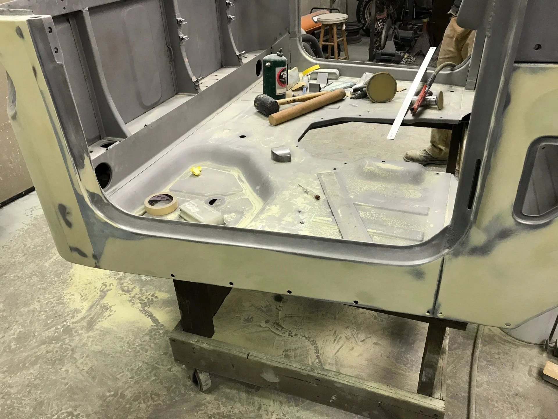

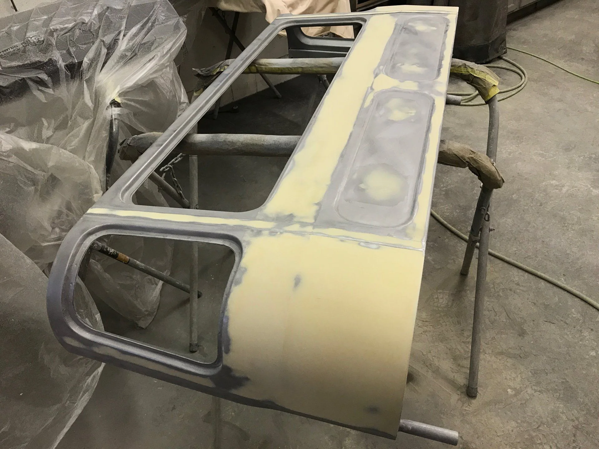

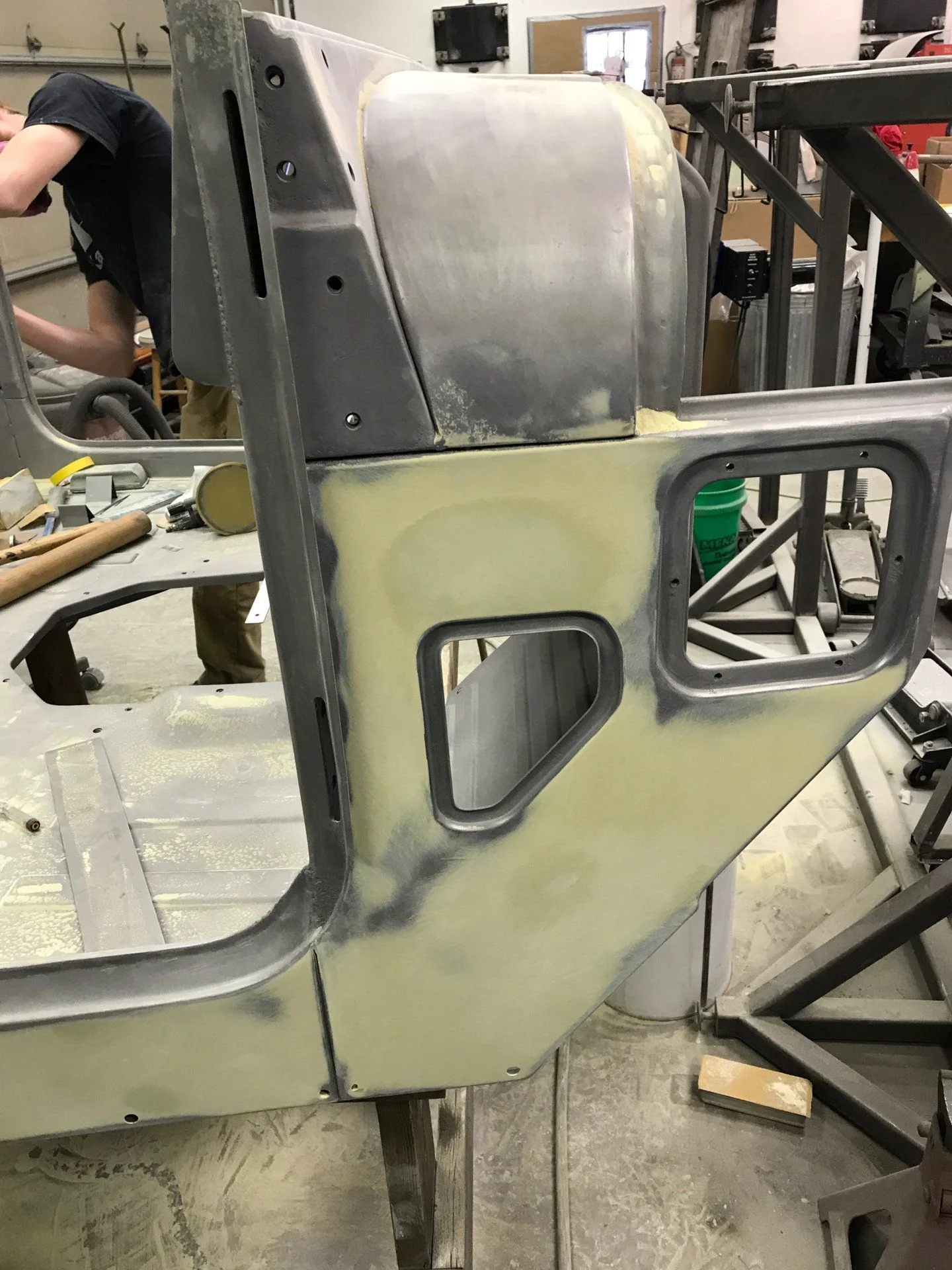

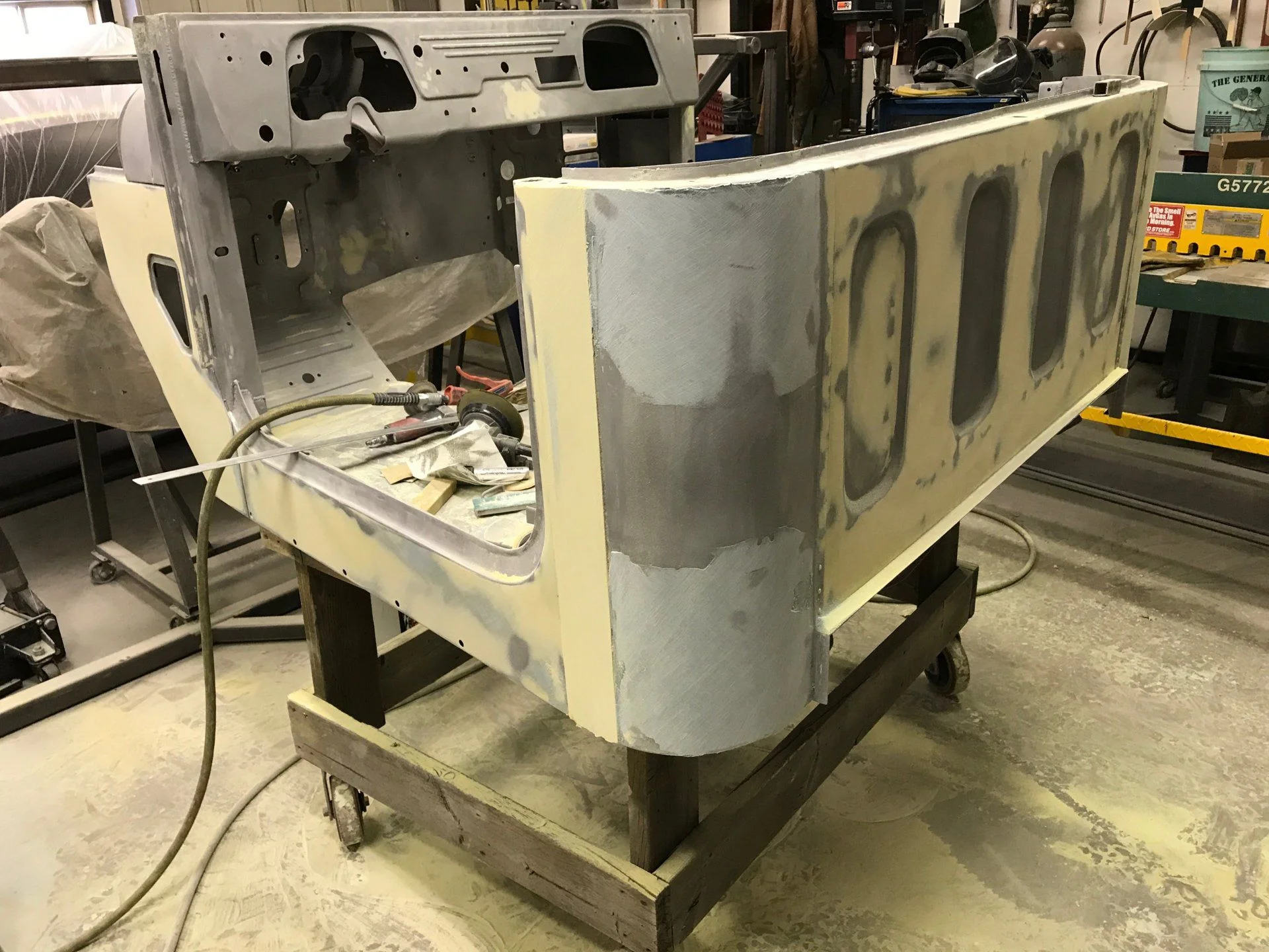

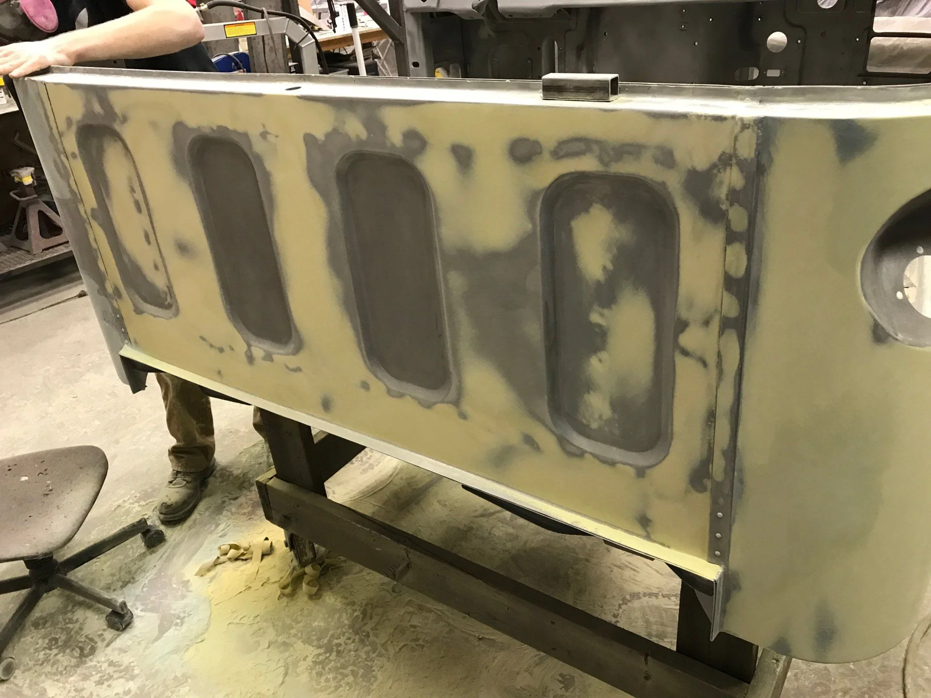

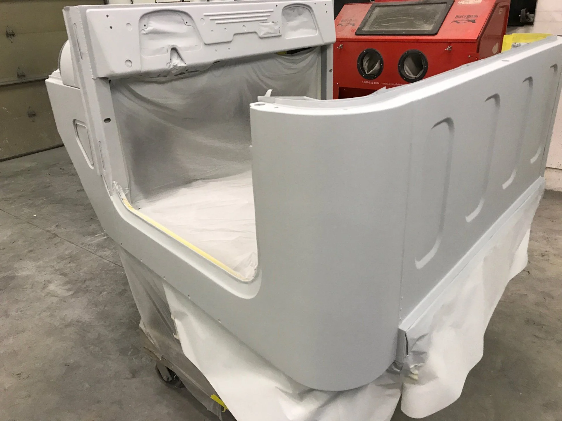

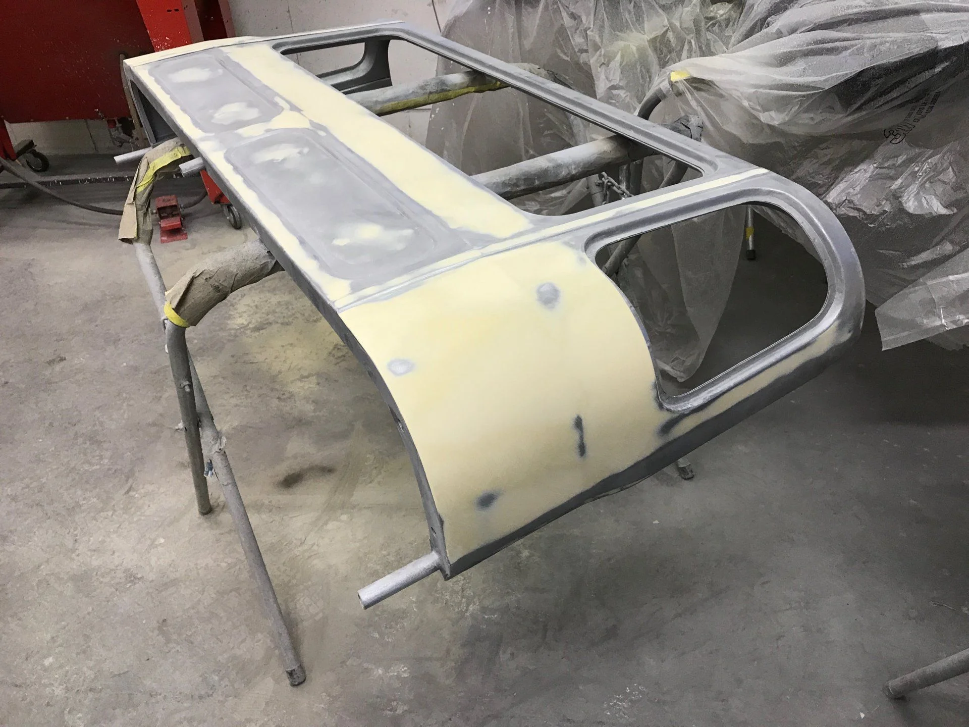

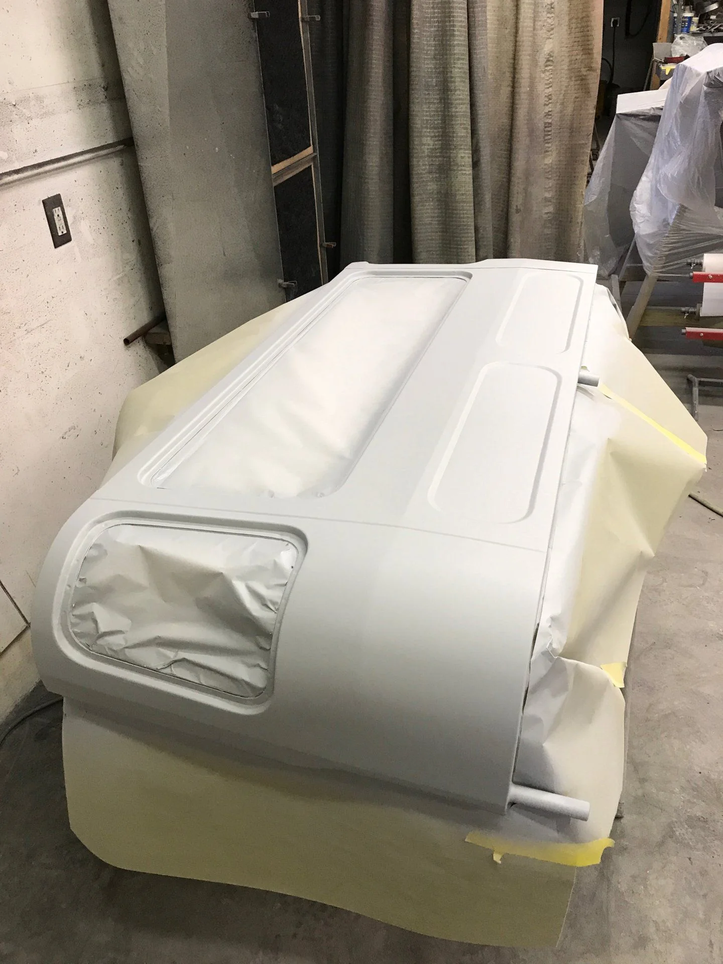

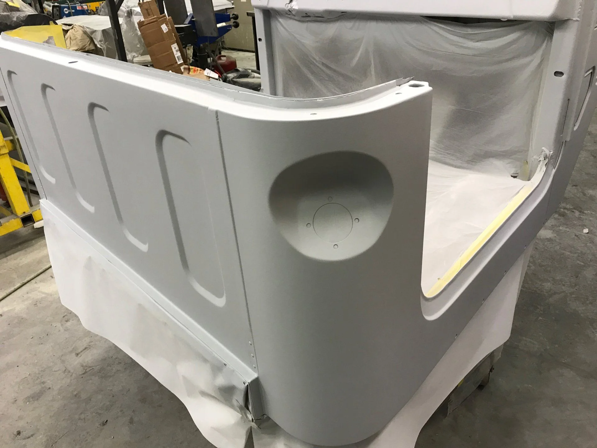

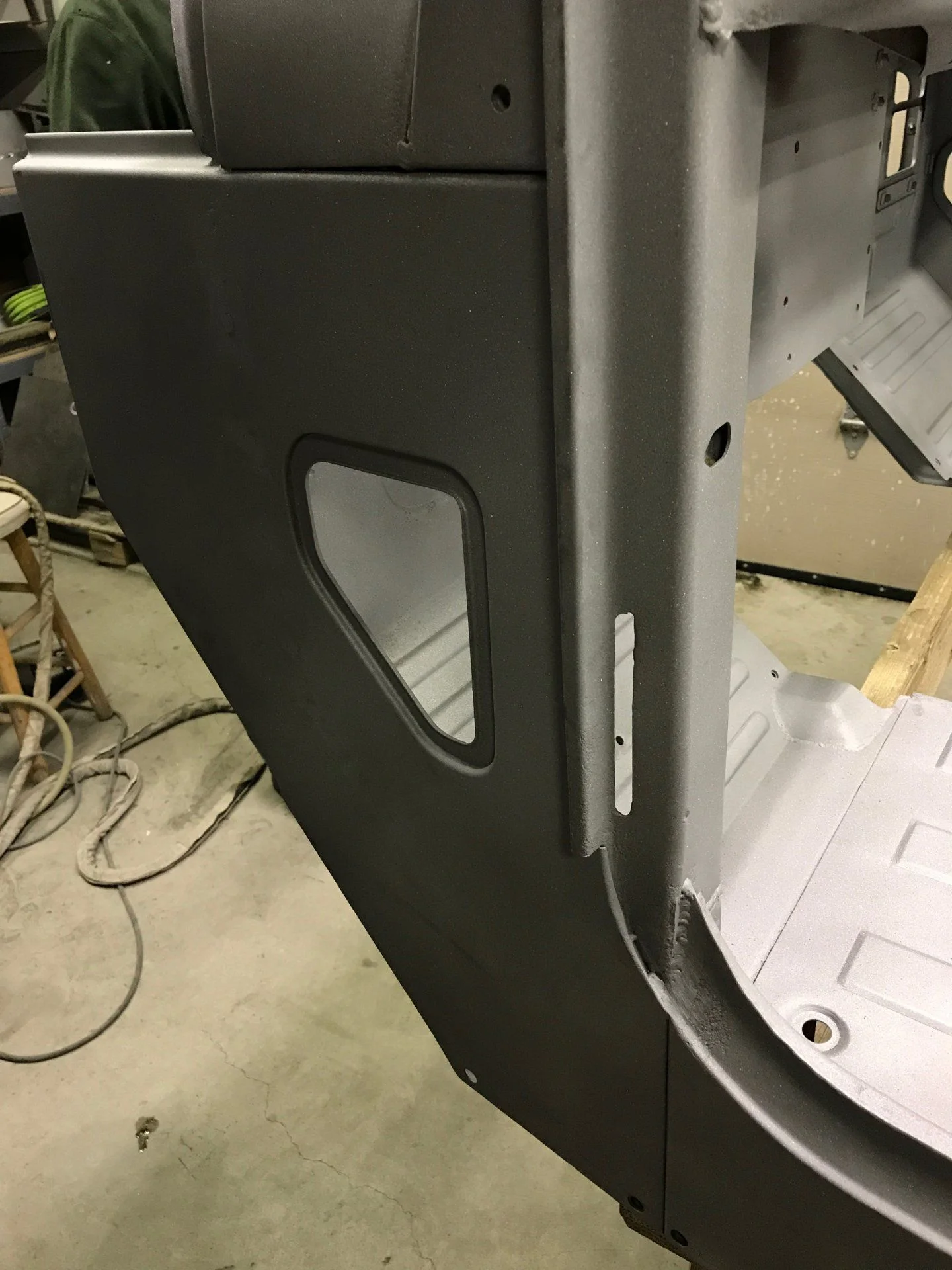

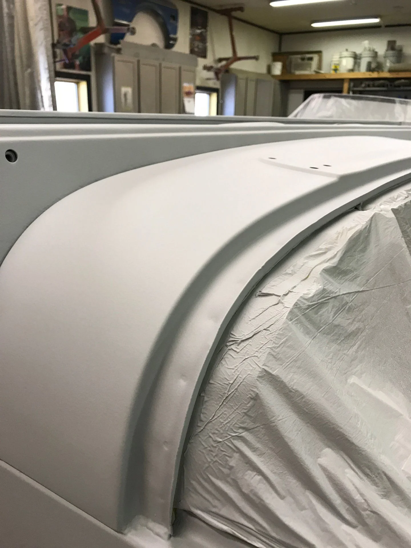

Tim is using Everglass reinforced body filler (gray) as the first coat on the corners and around the doors. This product is very durable and will resist cracking due to the stress from slamming the doors. The yellow product is 3M Platinum Plus body filler. The driver's side corner still needs a thin coat of the 3M product. Final prep today and then into the paint booth over the weekend for primer.

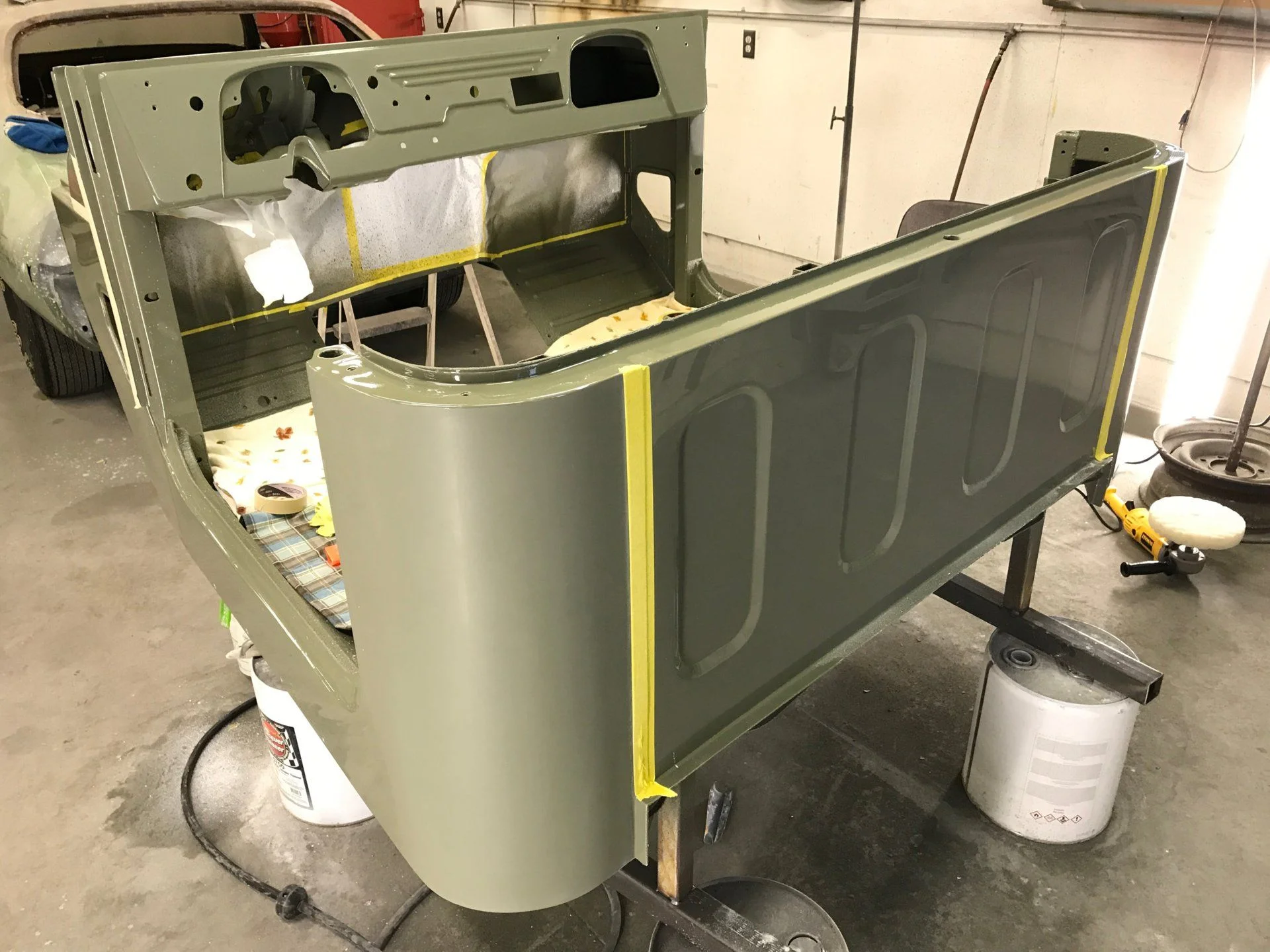

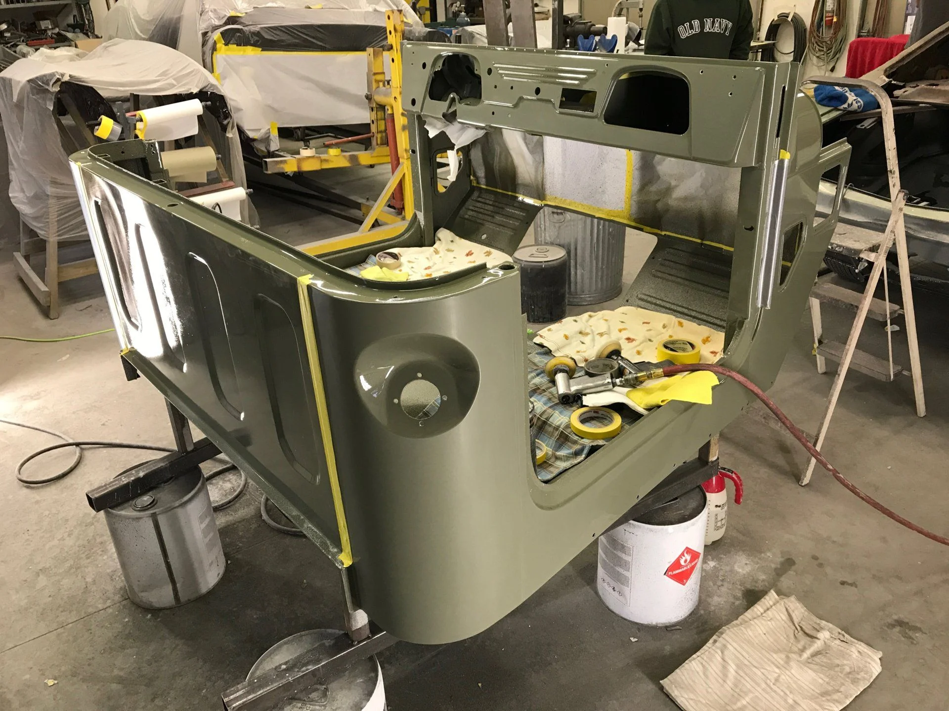

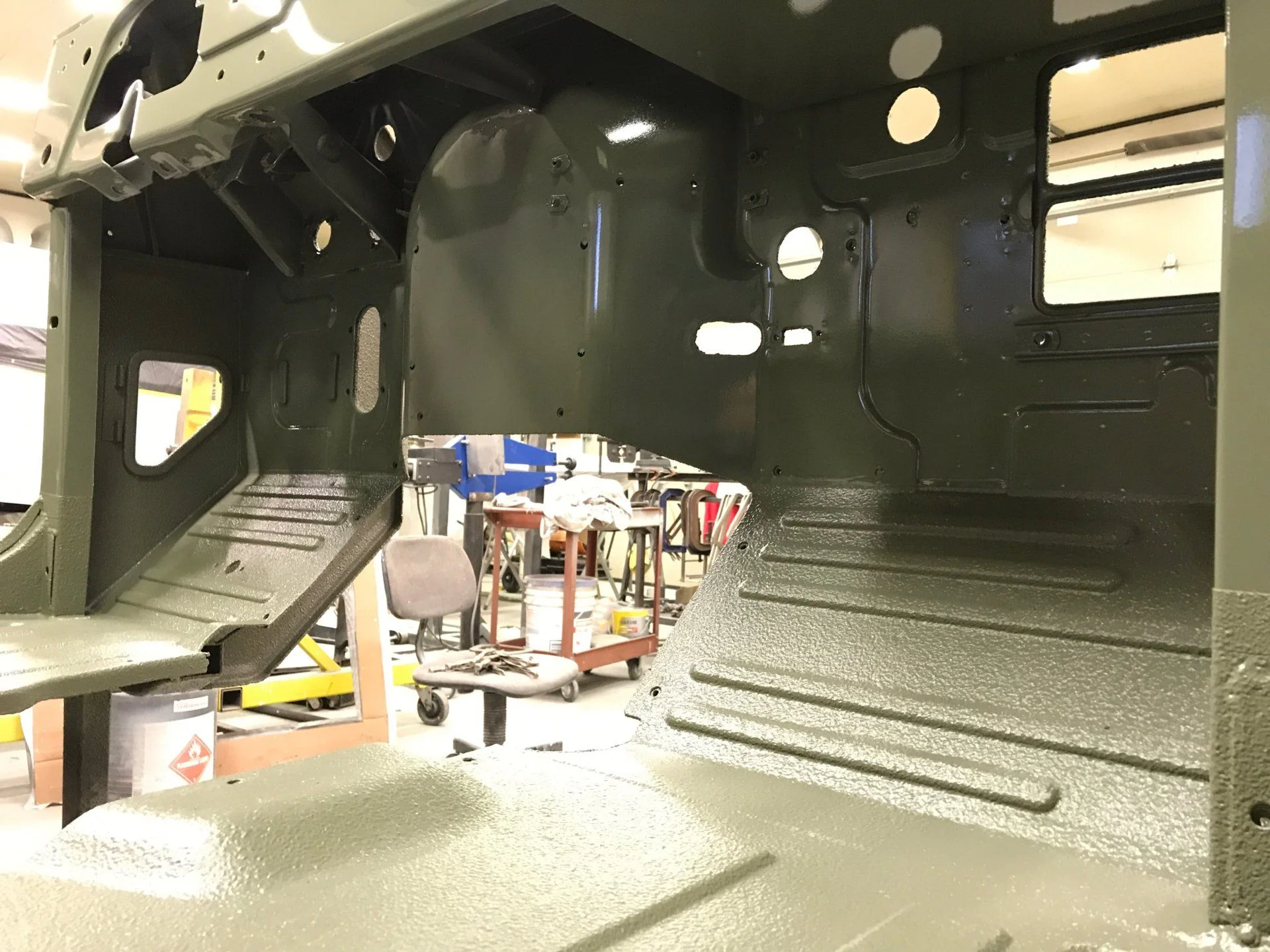

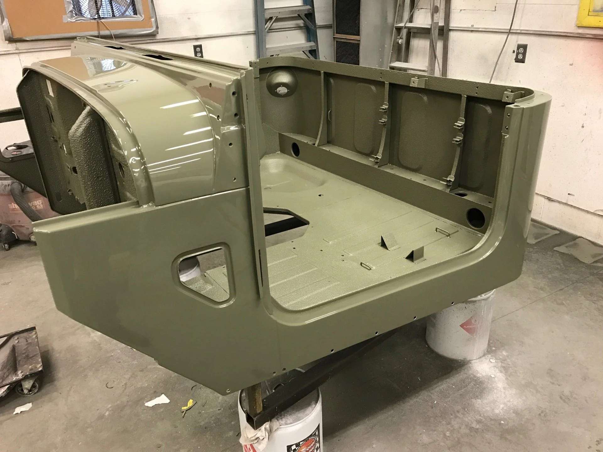

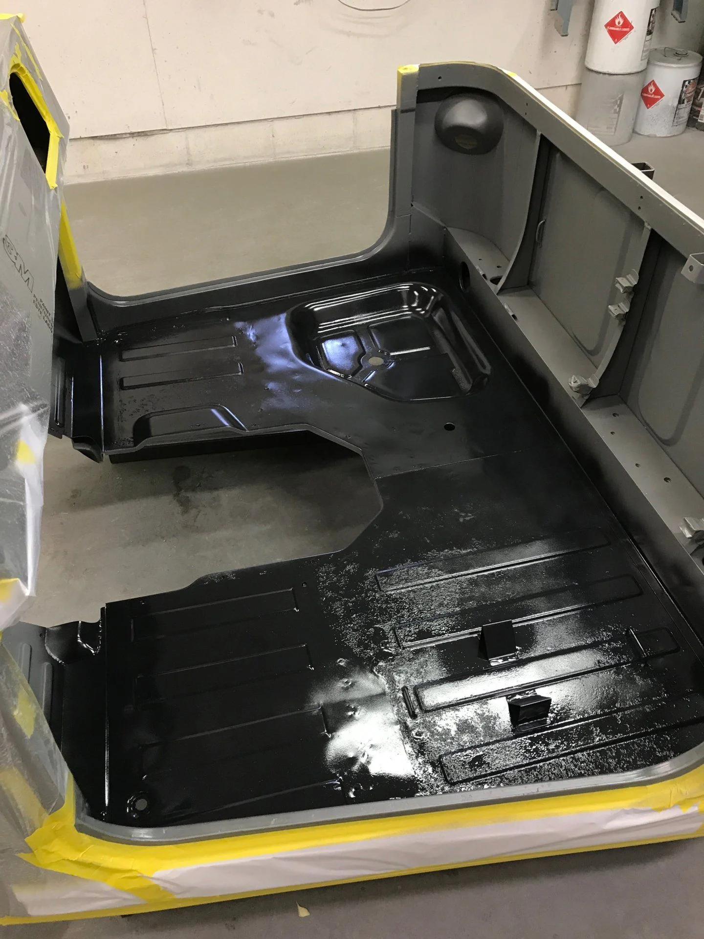

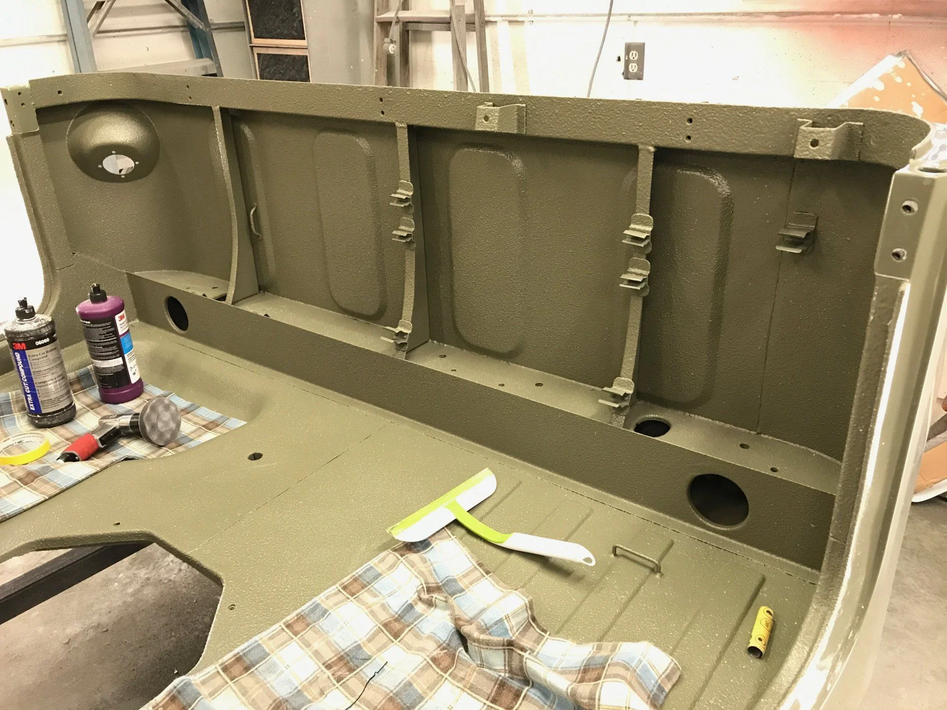

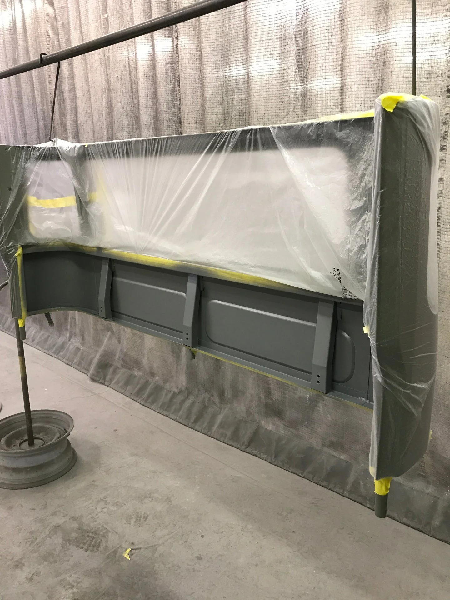

Paint is done! The Fashion Green is on. Missed getting some pictures of it going on. The primer is now on. Seam sealer goes on tomorrow. Then the Lizard Skin sound deadener. Followed by the LS insulation on Monday. Tuesday the tinted Raptor Liner goes on. Thursday buffing out of the Fashion Green. If all goes well I can pick it up Saturday.

The paint is PPG Deltron 2000 base coat, clear coat in Toyota's T303 Fashion Green.
