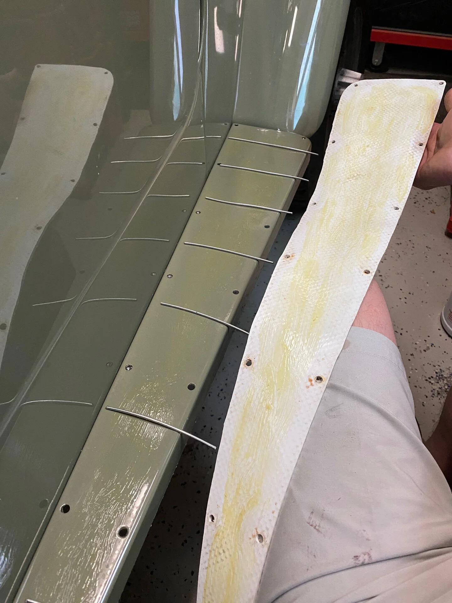

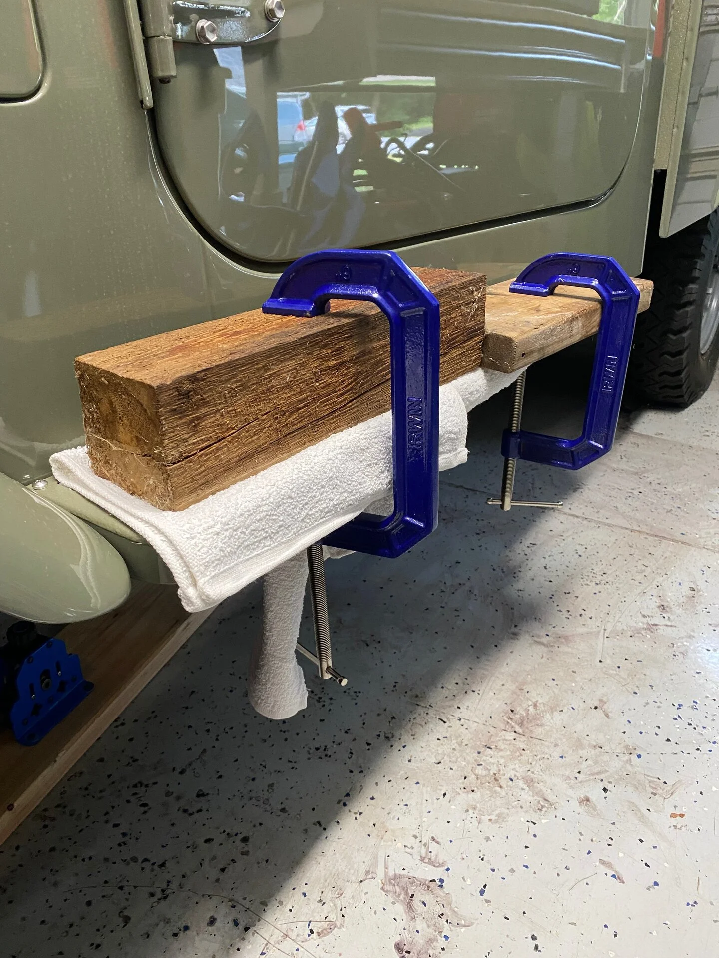

Buttoning up some things that had been left partially complete. One was the pyramidal tread running board material. I had cut it to size and installed it with only the trim ring and some new stainless bolts. The mat seems to have expanded and puffed up in the middle over time. Decided that some contact cement was the ticket. Applied a coating to both. Allowed that to tack up. Laid some wire down on the running board to keep the mating surfaces from touching. Put some screw drivers and allen wrenches in the bolt holes to line everything up. Starting from the middle I pulled the wires out while working out to the ends. Clamped it overnight. Been a week now and seems to be holding.

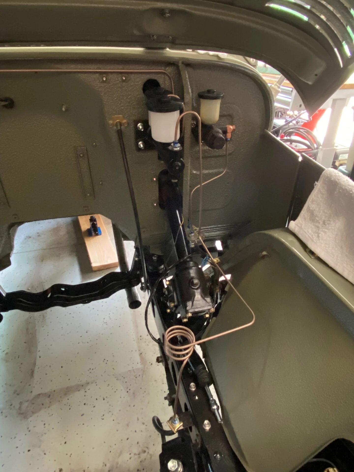

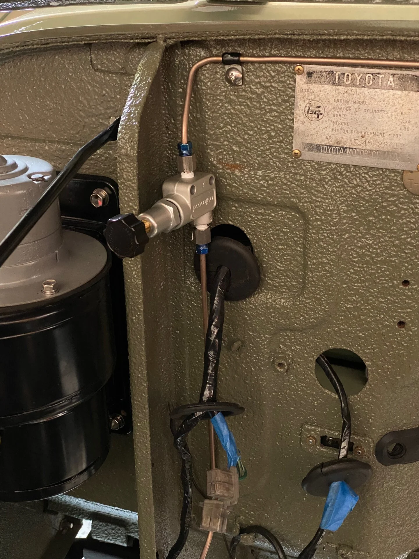

Decided to put in a proportioning valve in the brake line to the rear brakes. Had an issue with the rears locking up back when she was running. Wildwood proportioning valve obtained from City Racer. Also bent up some new lines to make it all work.

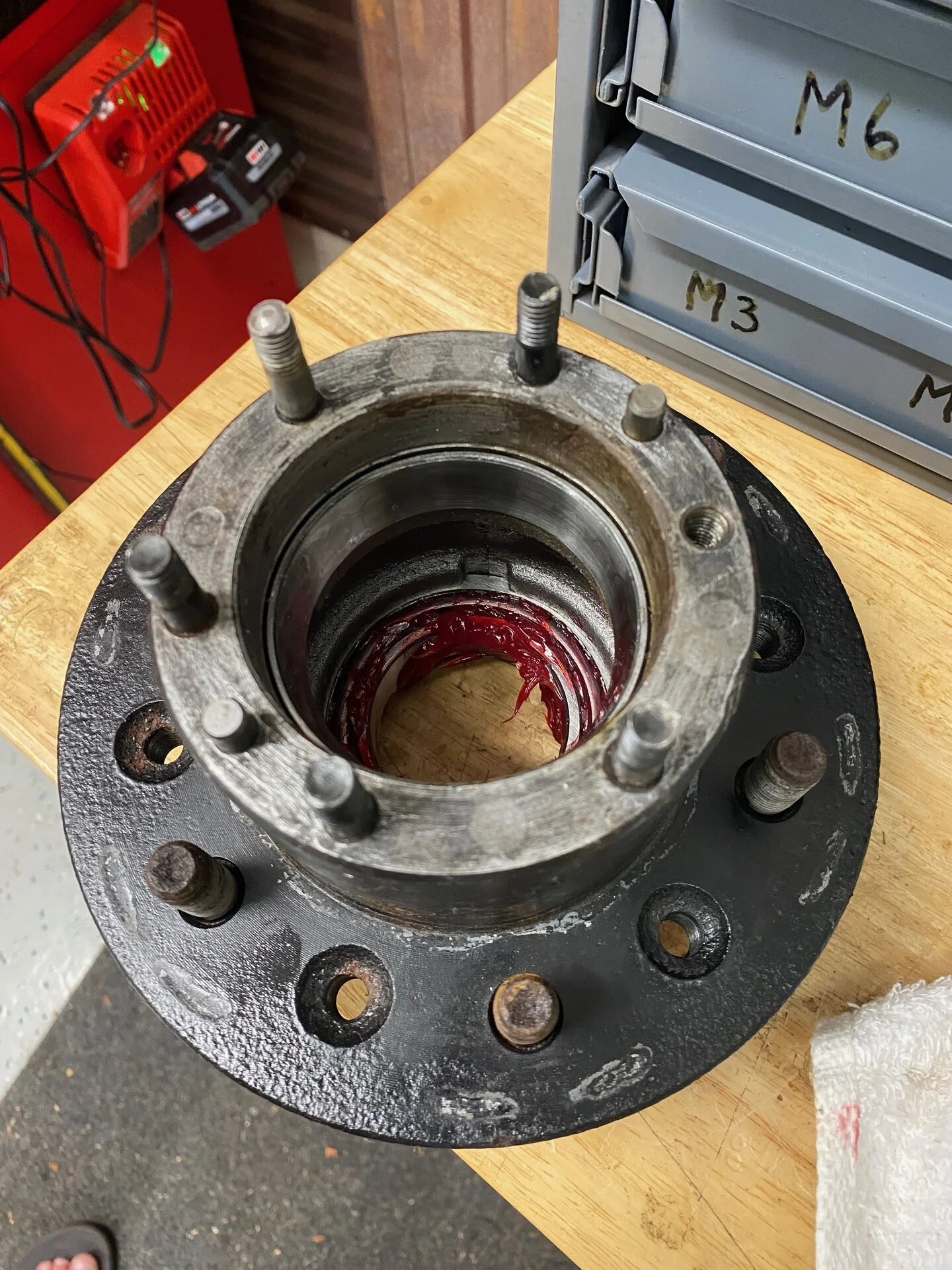

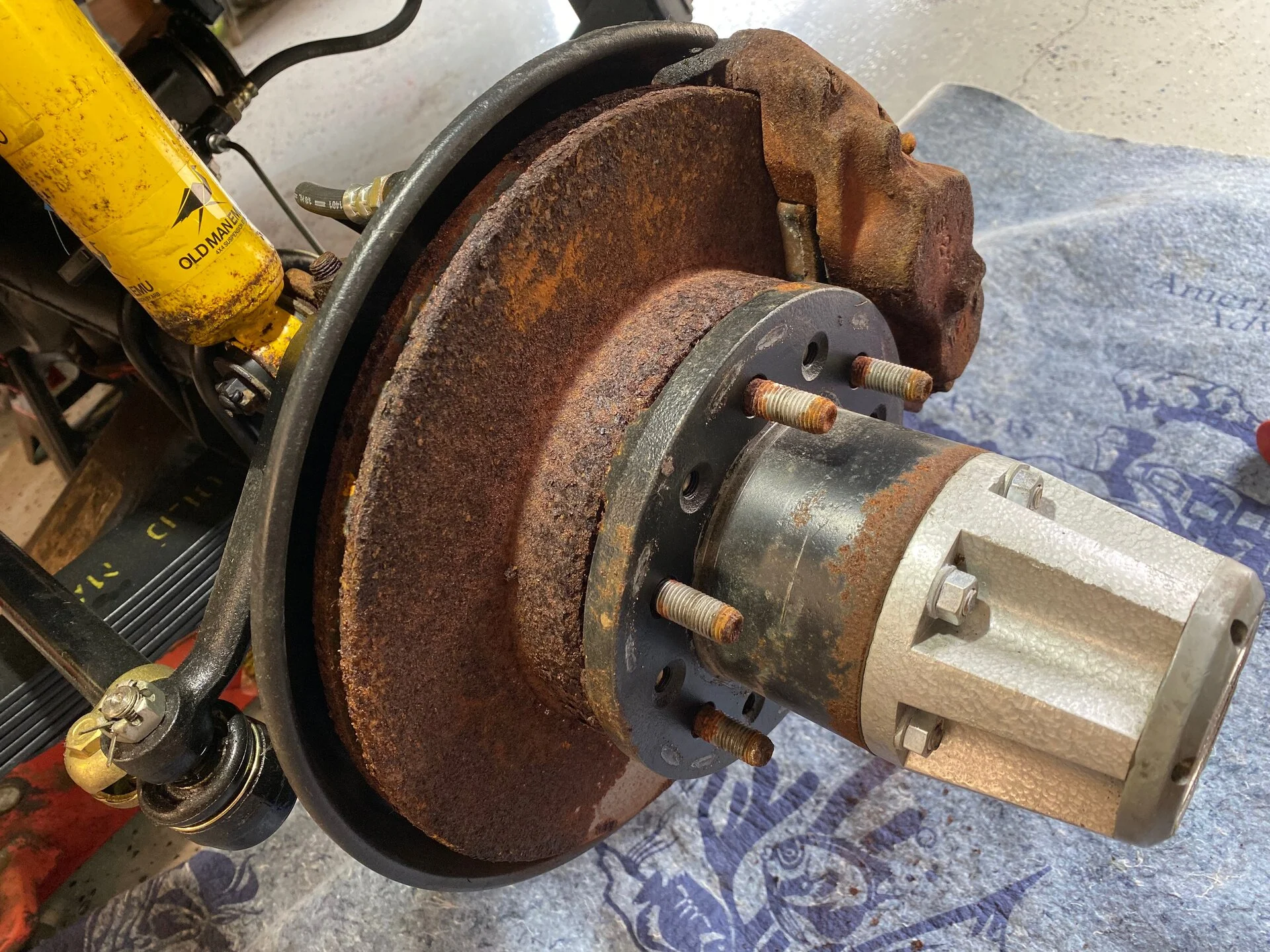

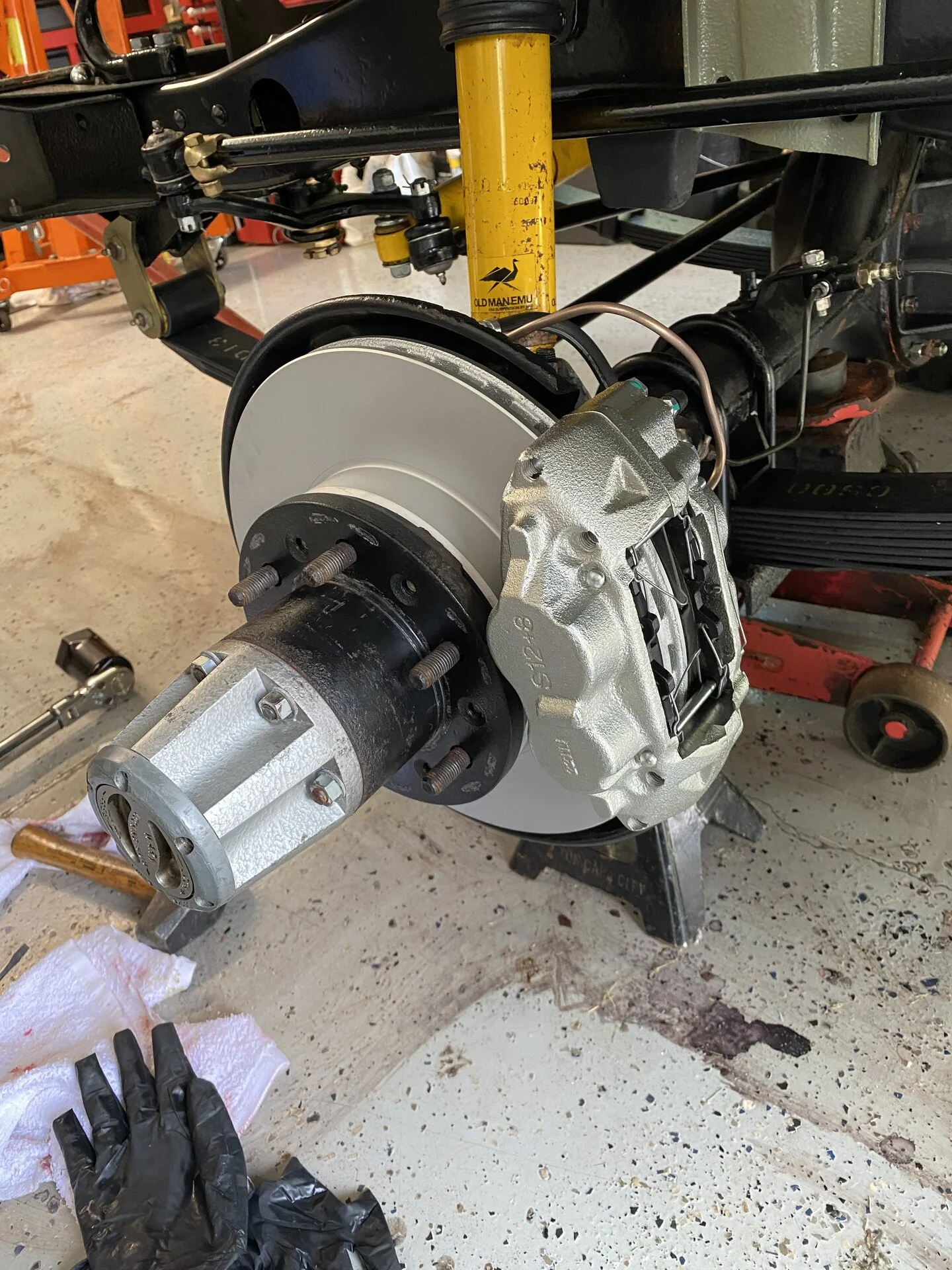

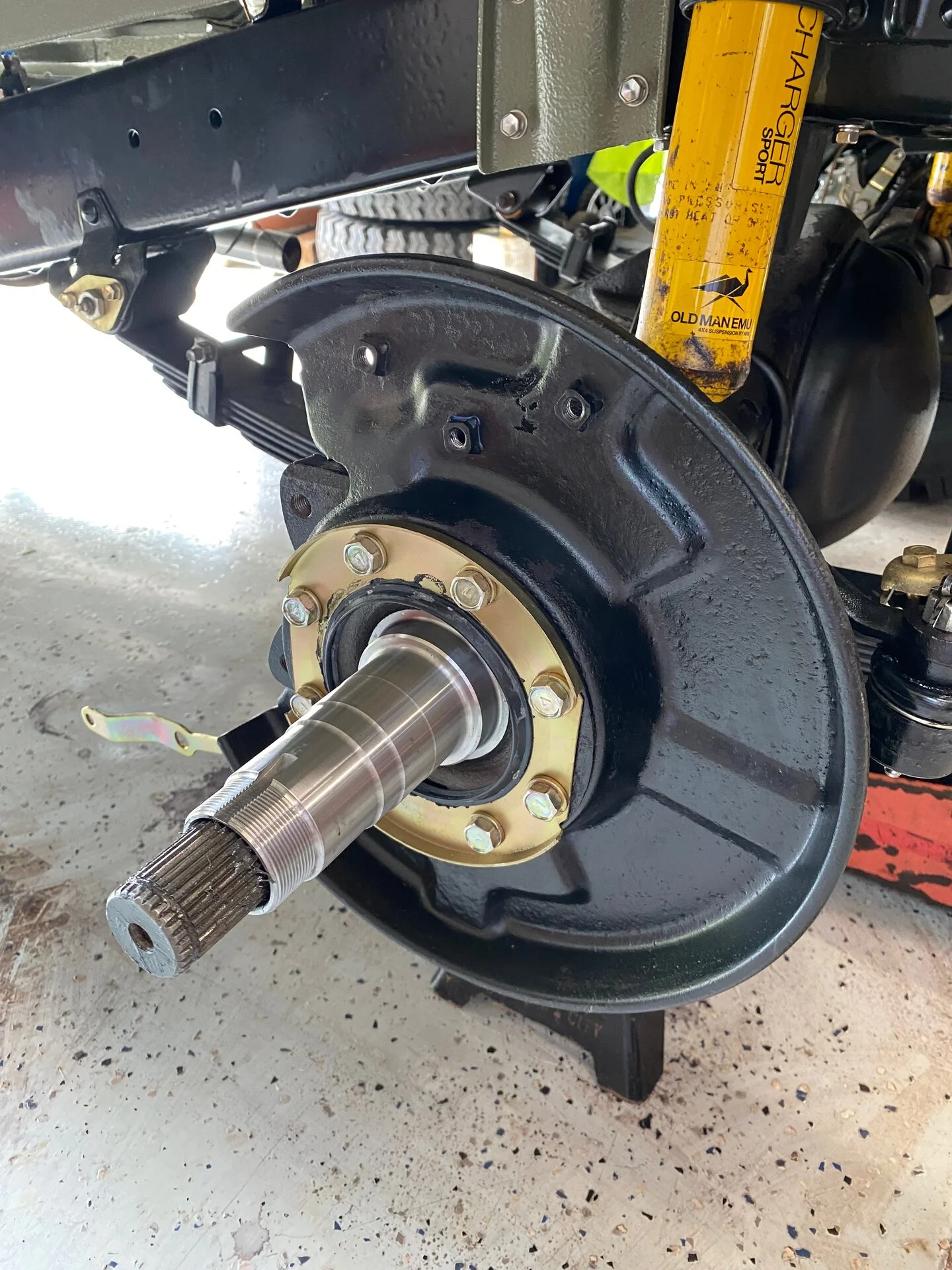

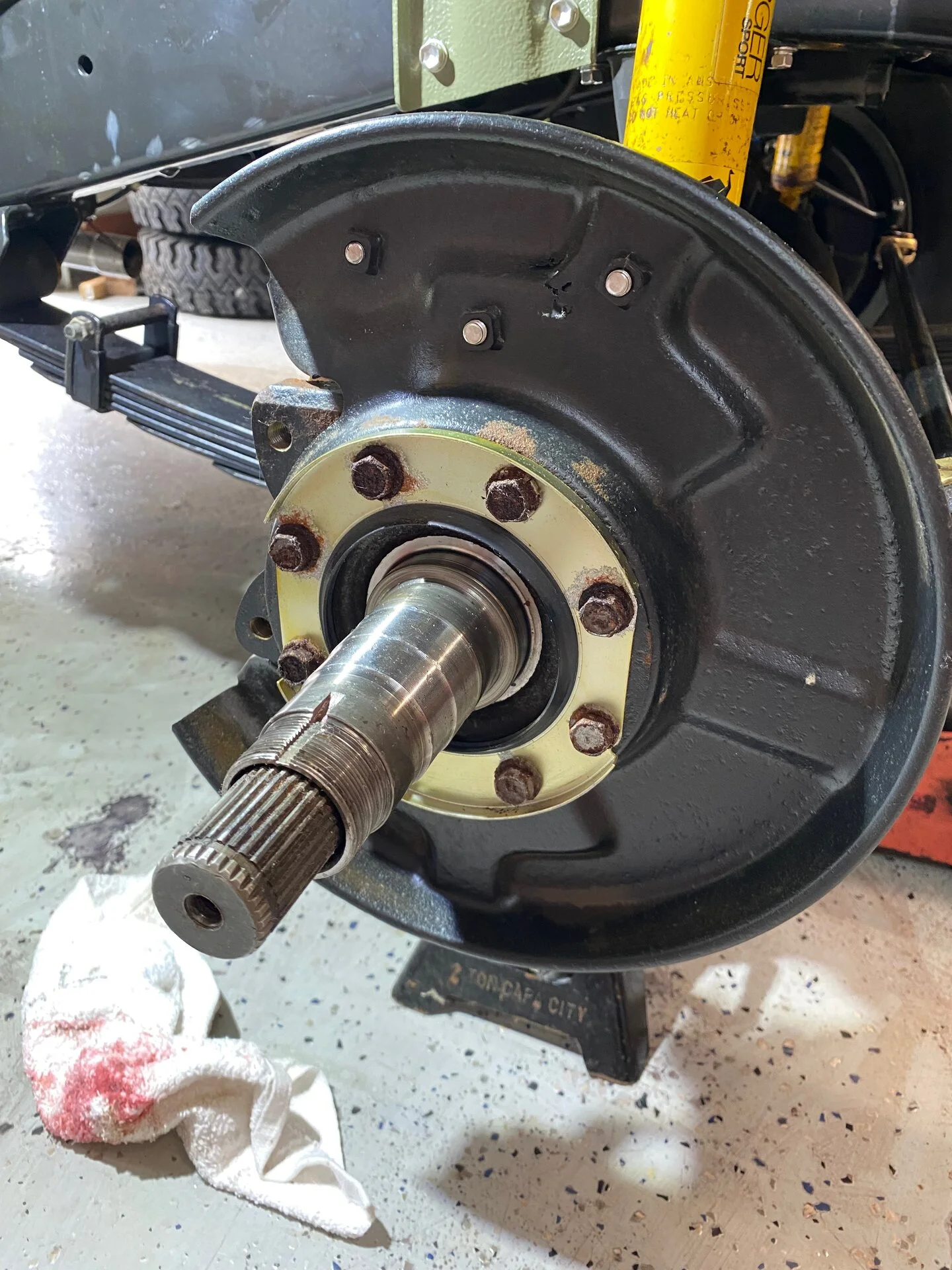

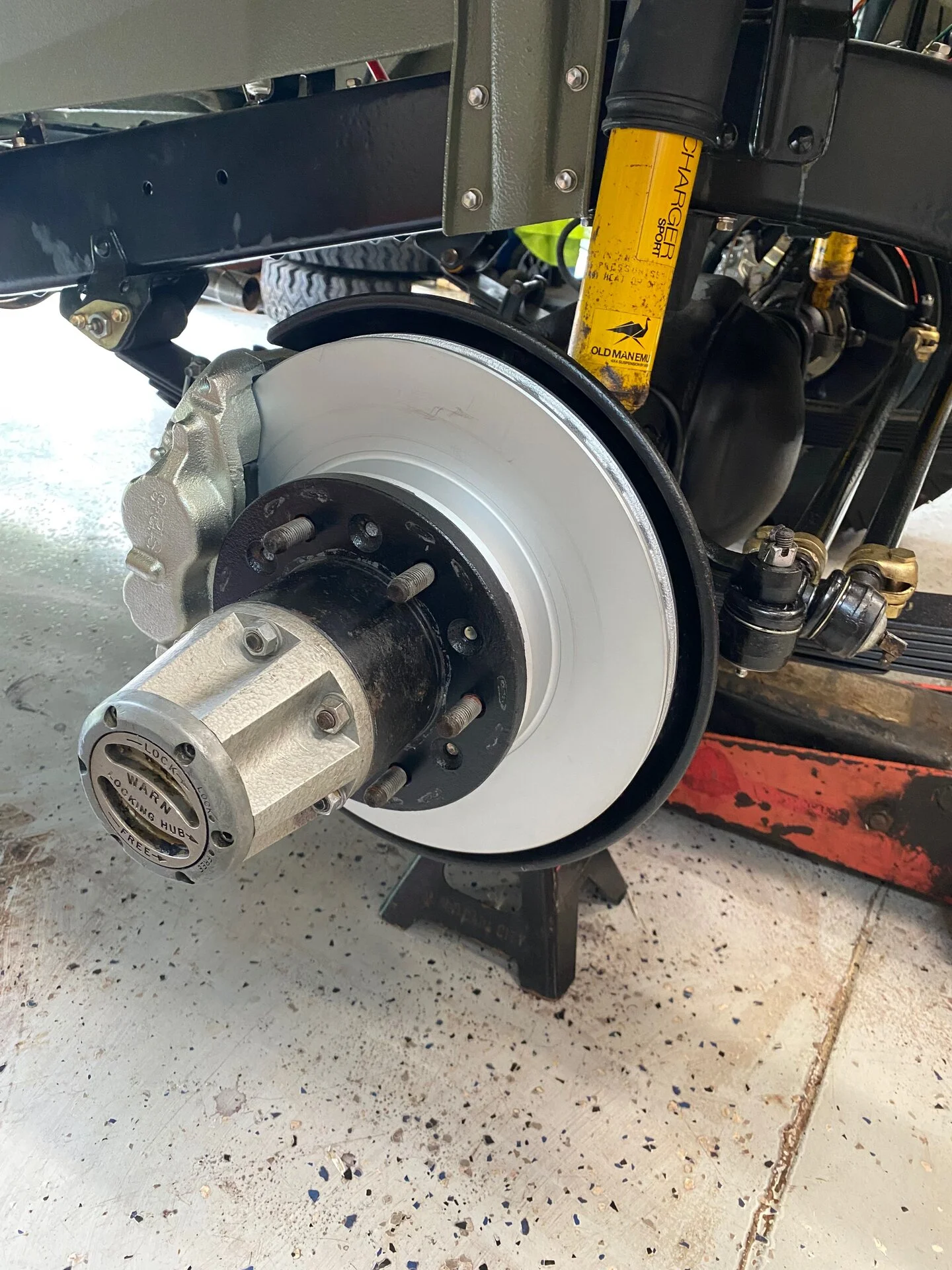

After 4 years sitting in a storage container the brake rotors and calipers rusted severely. It seems that anything that wasn't painted or recently replated suffered. New rotors and calipers going on. Also noticed a slight grinding sound coming from the right front hub. Concluded that the bearings need replacing and probably a new spindle as well.

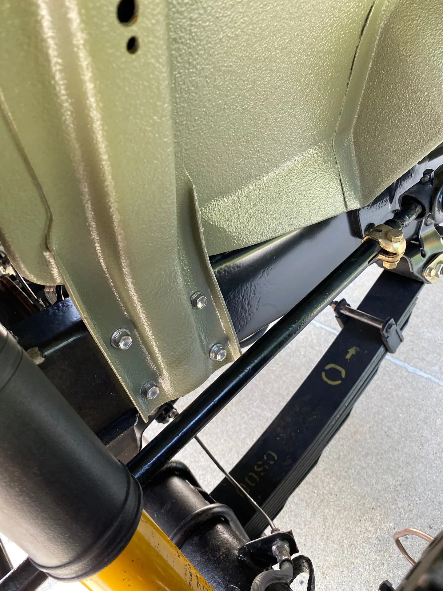

I got a recommendation for body shop with a frame rack. It's harder to see on the sloping driveway, but Jose straightened the front. Lines of the bib are parallel with the frame cross member and the left front fender bolts up nicely now.

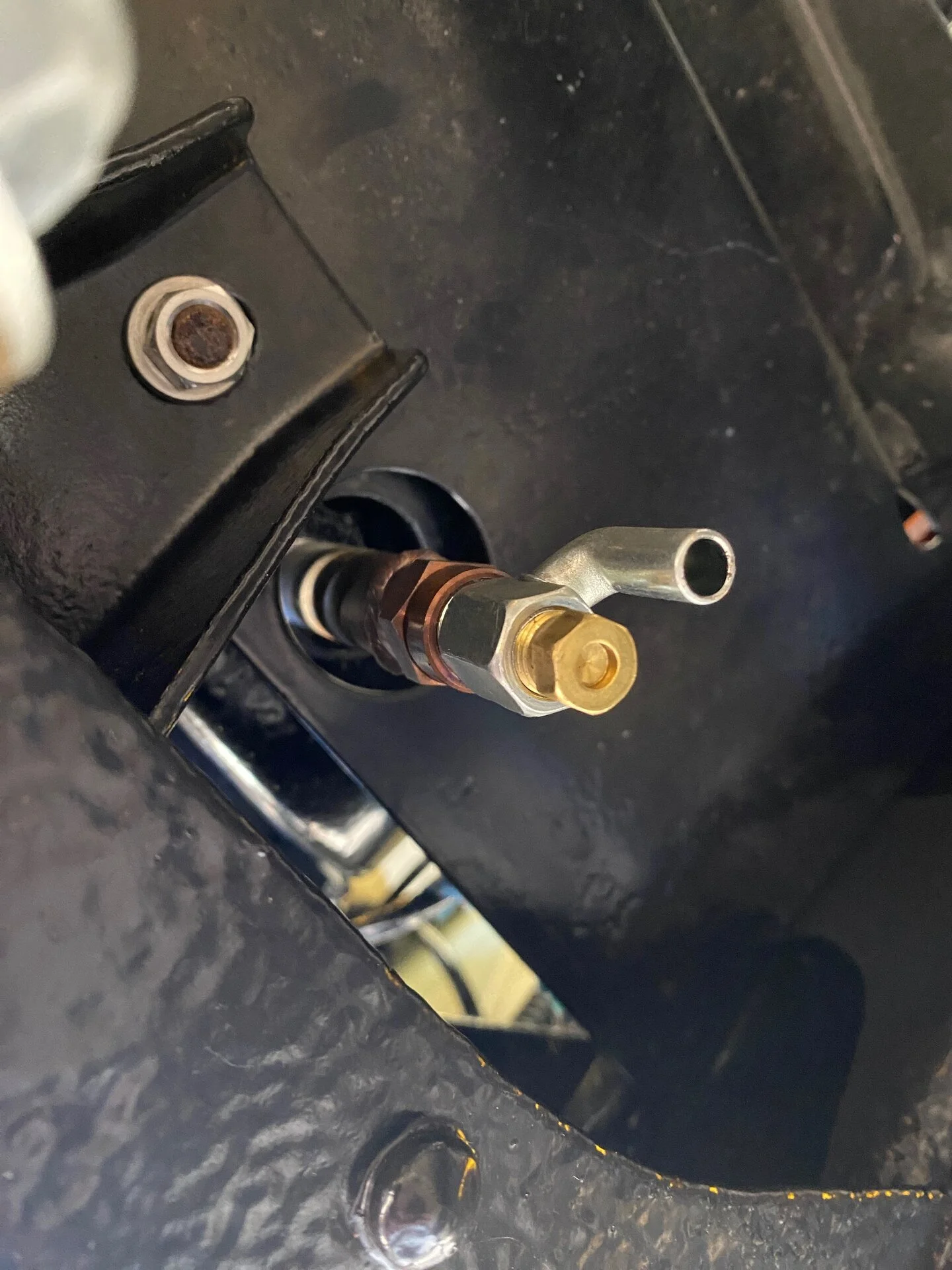

Put the old girl away for the winter. We have had such a warm winter that I have been able to get over a couple of times to do some work on her. I had been interested in @Cruiser Cult 's drain mast for the radiator. 40series coolant drain valve - https://cruiser-cult.myshopify.com/collections/40-series/products/fj40-coolant-drain-valve This part isn't a direct install on the new replacement brass 4-Core radiators produced today. The mouse eared drain fitting in the new radiators is a different thread type and the drain hole doesn't line up precisely with the radiator frame and splash pan holes. I had to install the new radiator in the frame to mark where to install a new bushing. I found a 3/8" BSPT hex brass bushing (part number 6OVN80) https://www.grainger.com/search?searchQuery=6ovn80&searchBar=trueat at Grainger that would mate up with this drain mast. I then had a local radiator shop drill the new hole and solder in the bushing. Everything lined up nicely.
Put the old girl away for the winter. We have had such a warm winter that I have been able to get over a couple of times to do some work on her. I had been interested in @Cruiser Cult 's drain mast for the radiator. 40series coolant drain valve - https://cruiser-cult.myshopify.com/collections/40-series/products/fj40-coolant-drain-valve This part isn't a direct install on the new replacement radiators produced today. The mouse eared drain fitting in the new radiators is a different thread type and the drain hole doesn't line up precisely with the radiator frame and splash pan holes. I had to install the new radiator to see where to install a new bushing would need to be soldered in place. I found a 5/8" brass bushing at Grainger that would mate up with this drain mast. I then had a local radiator shop drill the new hole and solder in the bushing. Everything lined up nicely.
That is great info! Bummer on the non-direct fit with the new radiators but good to note going forward. It looks good on there. Thank you for the support and we hope you enjoy it. :cheers:
I liked the one I installed on my 1964's original radiator so much I thought it was worth the effort on this replacement radiator. Makes working on the cooling system easier.
The bushing was $12 plus tax and the radiator shop charged $35 cash. You can decide if it is worth the effort.
