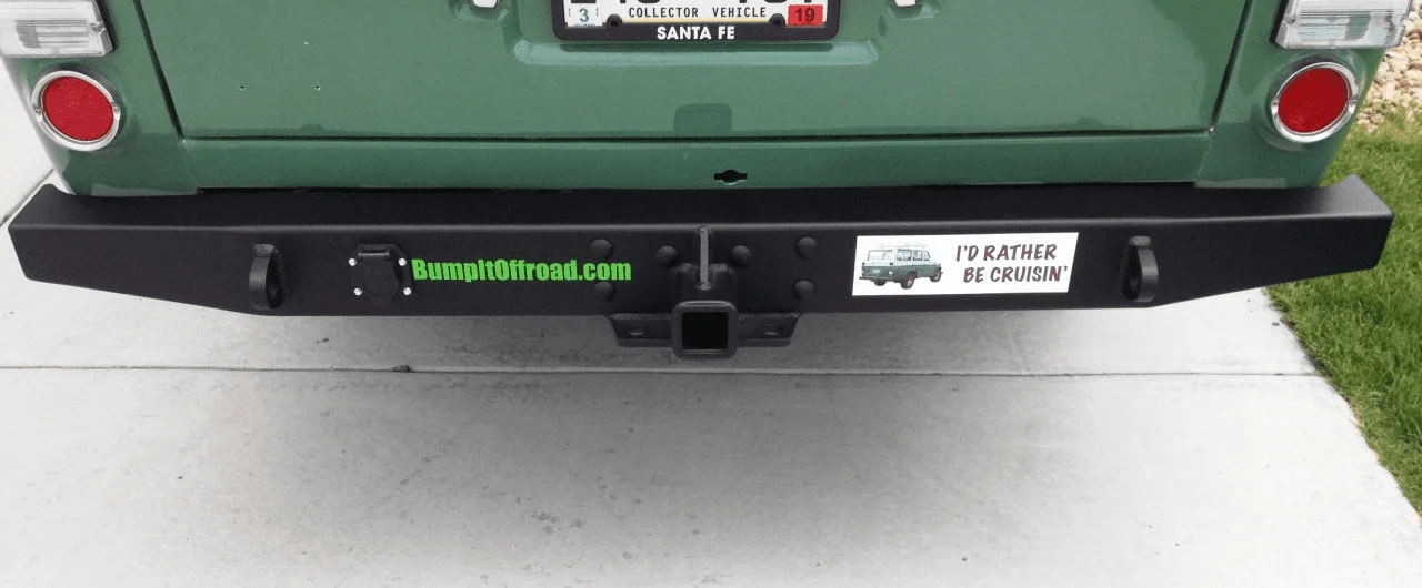

Sounds like you are talking about a rear bumper - I really like the Bump It Offroad bumper on the back of my Pig...

If you are even remotely interested, call Mike at Bump It Offroad and talk. Last time I visited with him he has a pretty good back log of orders!
