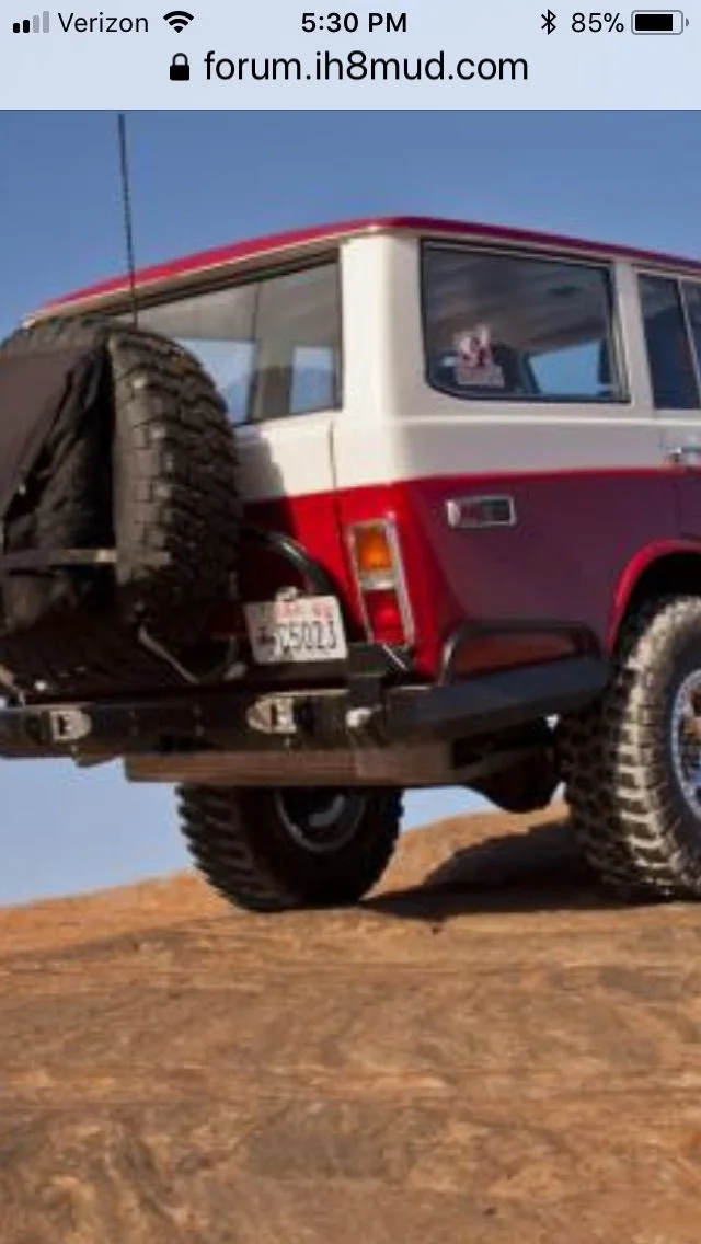

You have to ck our 4x4 Labs’ rear bumper. It the cats meow!
I have found that the side protection is something I need.
This one is Way cool too.
This one is Way cool too.View attachment 2309867
That's pretty sweet. The rear protection would be nice and a tire carrier would be too. Eventually I want a bigger fuel tank and will have to relocated the spare.

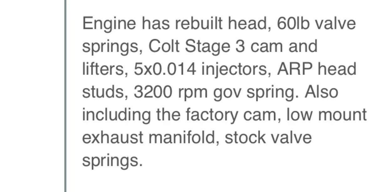

When I bought the motor it had new injectors in it. I only ran it a few times around the airport and it didn't smoke like this. It was started about every 4-6 months while sitting but that's it. I'll have to look into that. Thanks. Here's what the owner said he had done. Plus I had the injection pump rebuilt before it sat.
5X.014 injectors sound big to me with a single turbo but I'm sure some experts will swing by and set us straight.
