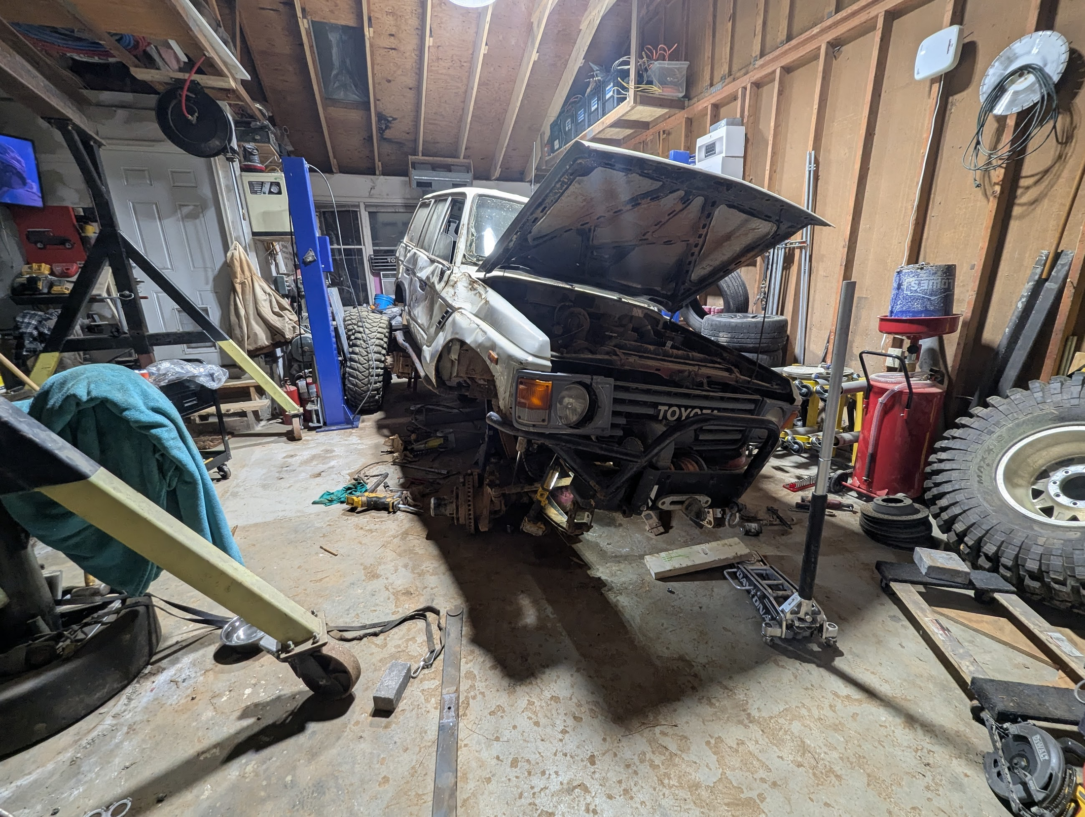

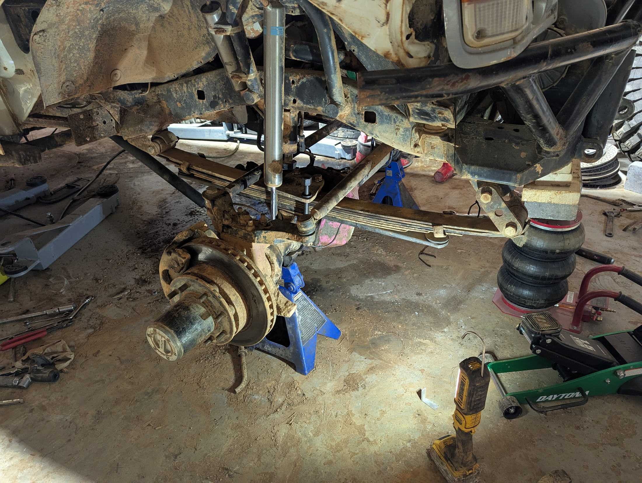

Dropped the truck off the jackstands trying to raise it up (stupidly) to get the springs put back together. Jackstand slid alongside the frame rail and ripped the fuel lines, so I'll add that to the list of things to fix.
Sorted that disaster out and got the springs together. Need some longer spring bolts, but she's close now.
Is your vehicle lift not working?
It is, but elected not to use it because it's tall enough as is. Glad I did too, because I had to take one of the lift columns down to get the gantry crane over the mill.

@Zjohnsonua the new spring packs in the front are effing amazing. No more bottoming out all the damn time. Huge upgrade, thanks man, the chevy 63" 1/2t overloads seem to have fixed the front end completely.
Those new tires look great! Something better than my current military MTRs are definitely on my upgrade list.
It looks like your just riding on those overloads up front though.
If you ever pull the front springs apart again, swap up to some 3" wide springs. I just installed some 58" long ford rears on the front of my truck and they handle the weight of the 4bt a lot better are nice and flexible. Some 2" blocks should help with the rub you've got in the rear too.

The overloads run close, but they let the pack do it's job and then arrest things as the pack inverts. Just have to be cognizant of how much inversion the packs see.
Everyone thinks this makes for a really abrupt ride quality....quite the opposite.
Oh i gotcha, yeah that makes sense, its hard to see from the pictures how close they are.
They've vastly increased the ride quality, 10/10. If this ends up failing I'm cutting the truck apart to link it, not going to different springs.
