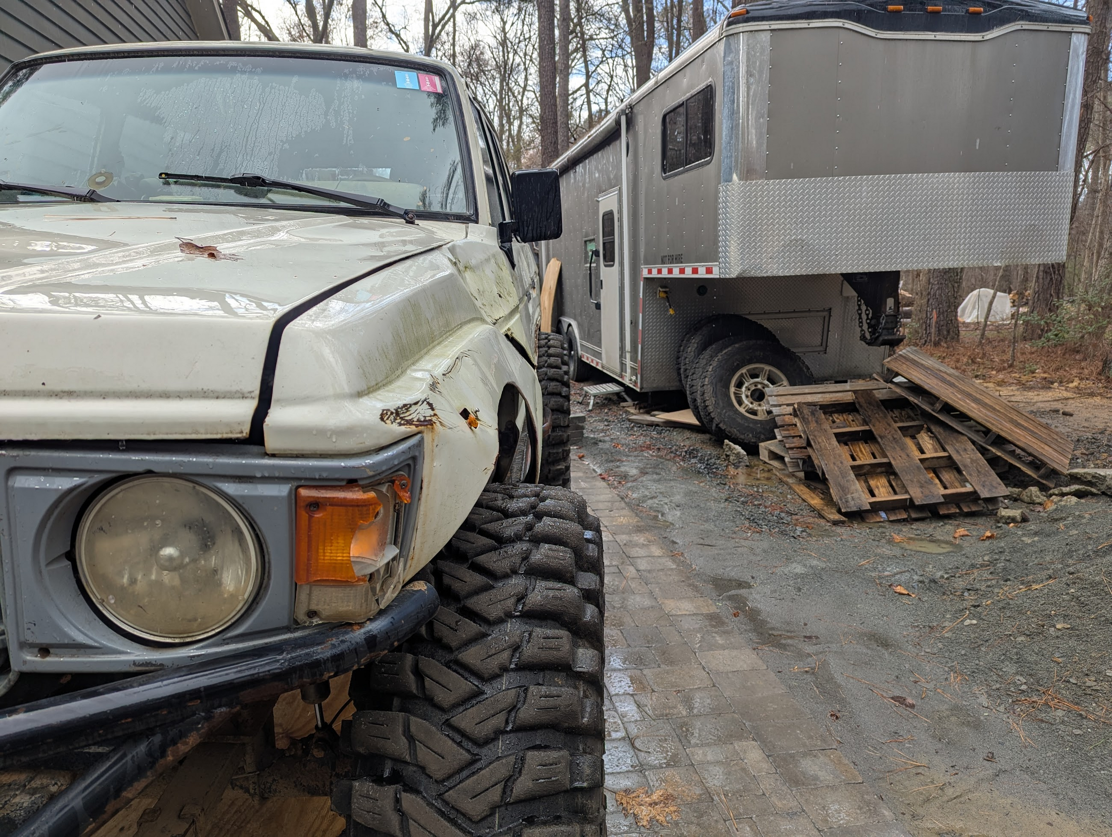

Moonshine's "Sticky Era" has officially begun. The rear quarters are gonna need some surgery before her first outing as you can clearly see.

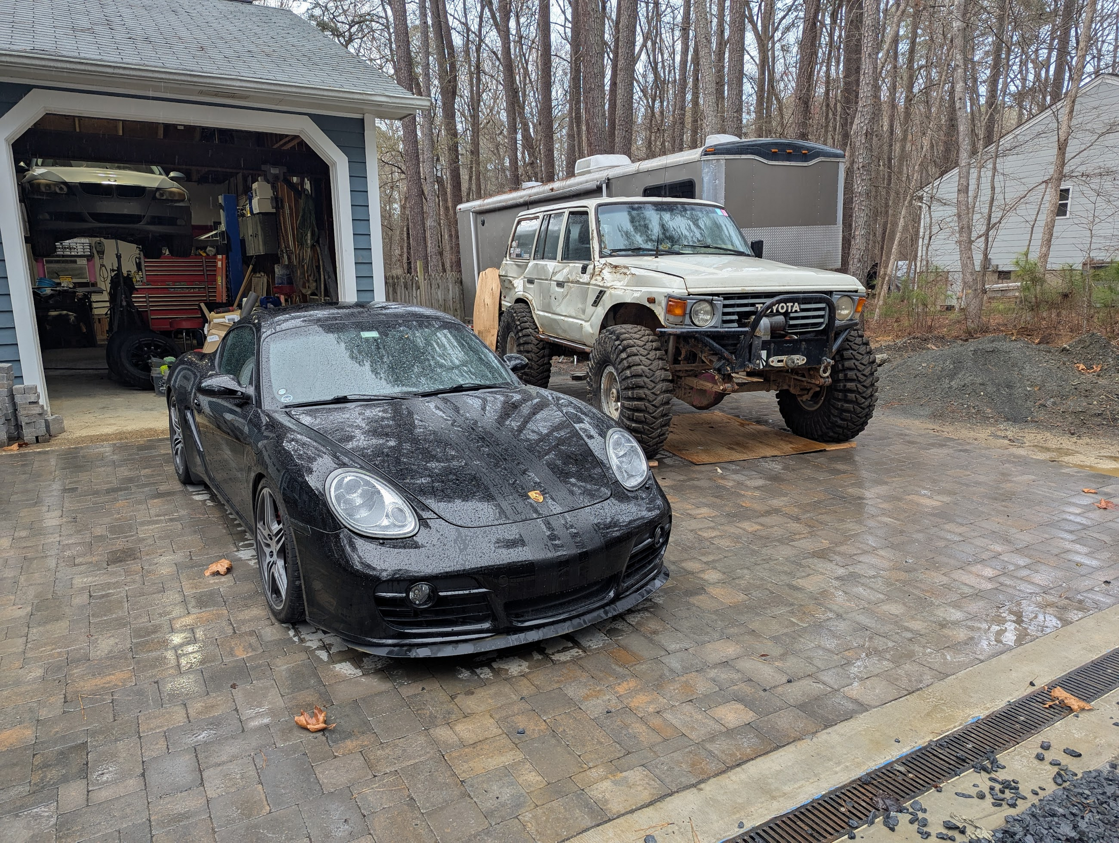

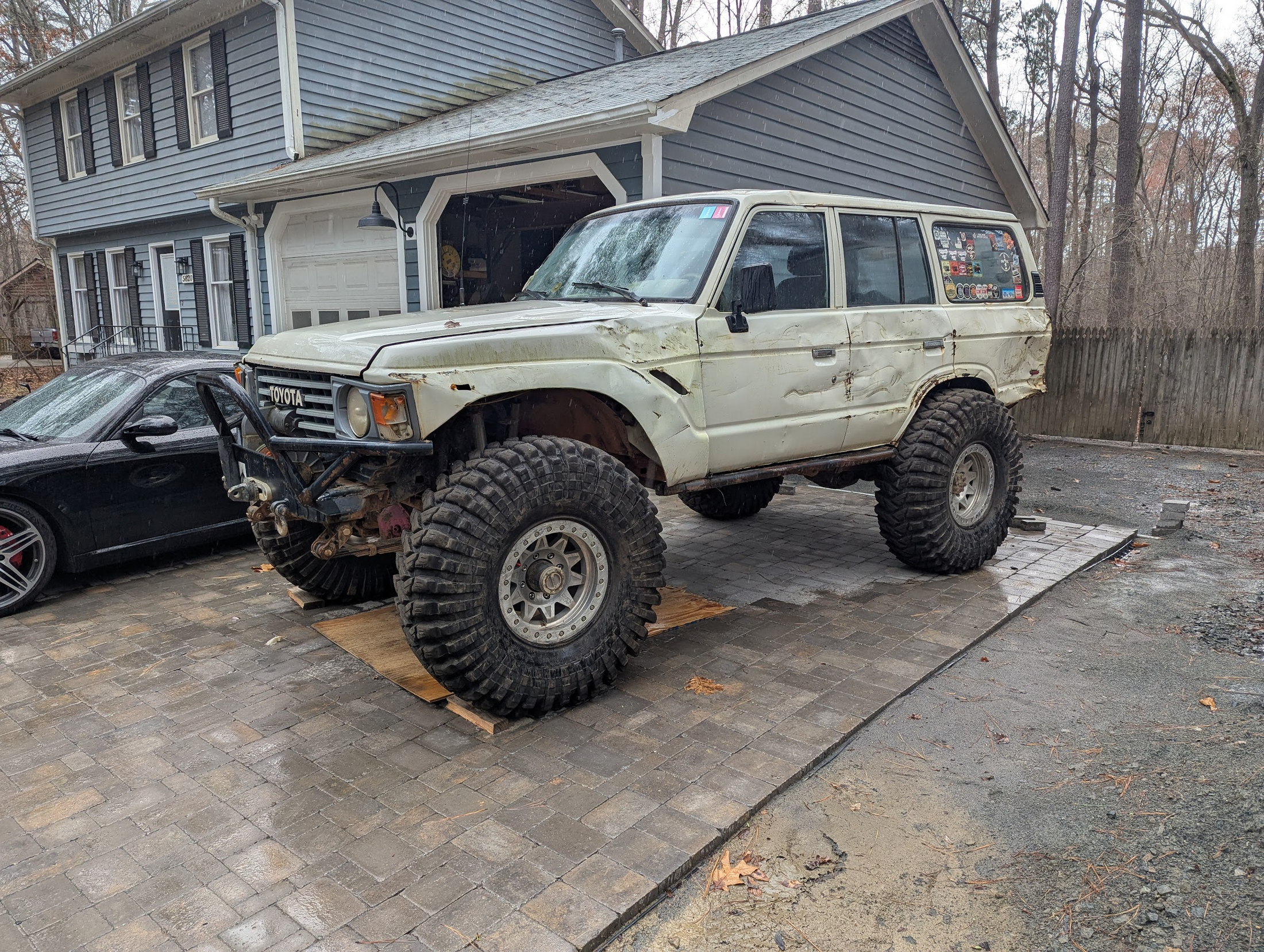

Love the higher offset of these wheels. Lost quite a few inches of track width, especially with these tires being narrower than the old ones. I think it's about 4" narrower than before, but I'd have to go back and double check that. Just shy of 87" wide outside tire to outside tire on the front now.
The tires come about halfway up the door windows on my cayman, lol.
