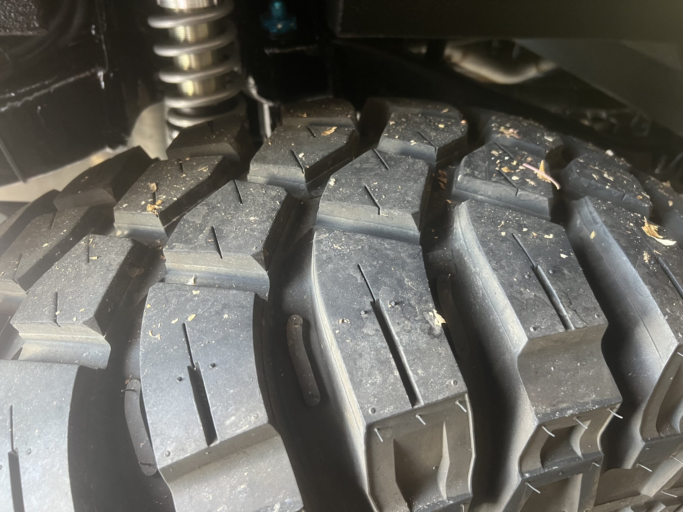

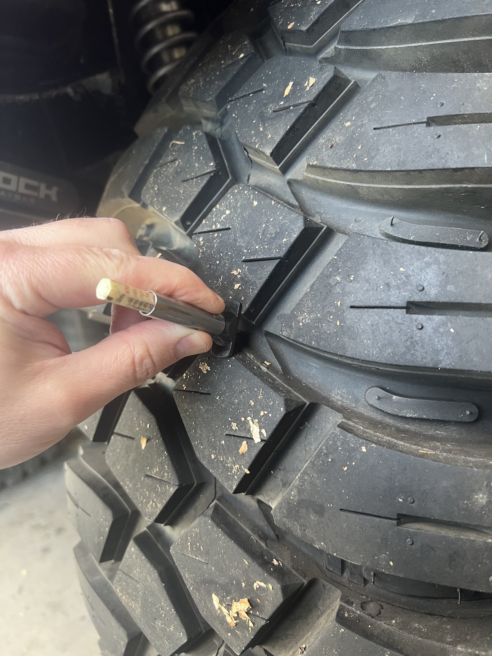

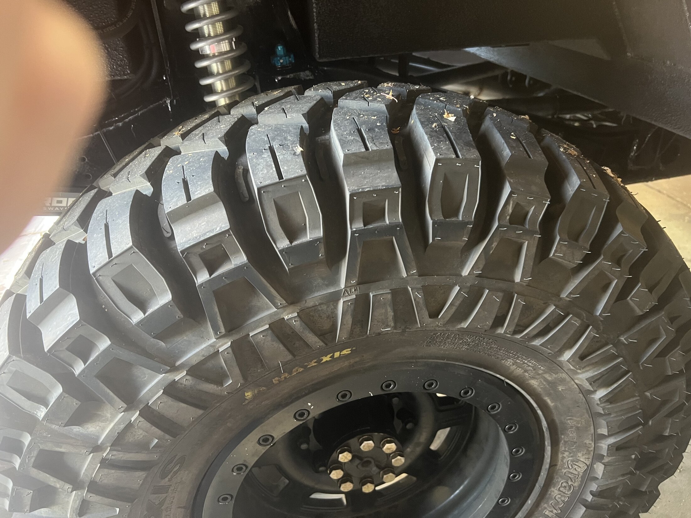

I have one Maxxis Creepy Crawler yellow label tire as my spare that I have been running while I wait for my 5th wheel to arrive. I have almost 600 miles on it and I have 20/32 of tread in the center. These tires are hard to measure depth as the base layer is not flat but it measures 28/32 where the base steps down, and over an inch past that. See pictures.
They came with 27/32 new and if that measurement is from the center of the tires, I have burned 7/32 of tread running on the blacktop. I’m with Matzell on this one. I’d run a different tire for the road.
