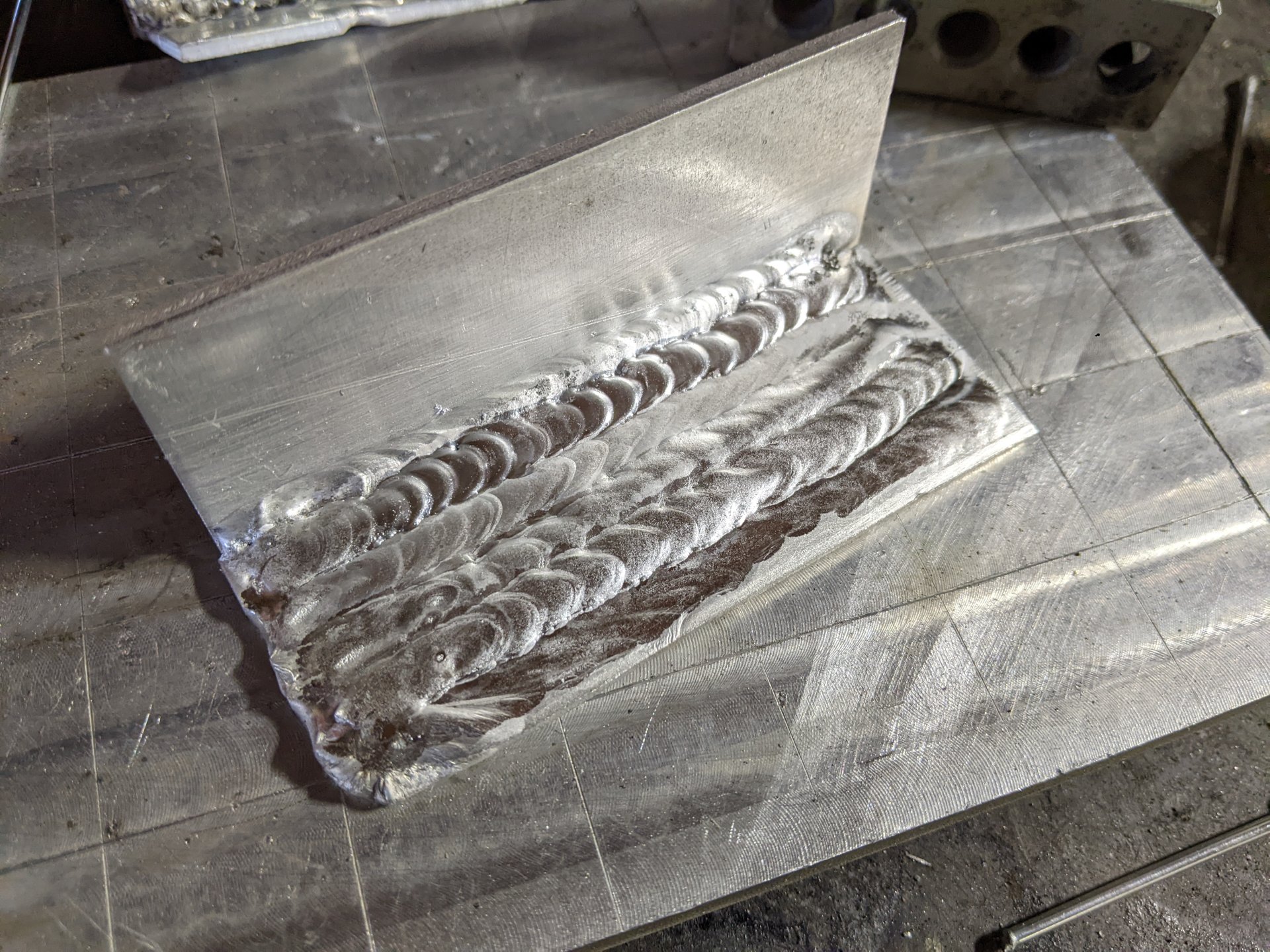

Step down to thin rod, like 1/16 and smaller tungsten (1/16” ) and cup size. That will help a lot. Smaller puddle and more control with the smaller electrode, and smaller filler will melt in easier. Basically you want to scale your consumables to the material.
Playing with your balance to be on more of the cleaning side rather then the penetration side will help a lot too
3/32". I've done a bit of AL tig before, but this is my first time on thin tubing.
Thicker stuff and training on flat plates is easy, but the positioning and fit up for this tube is a real bear.

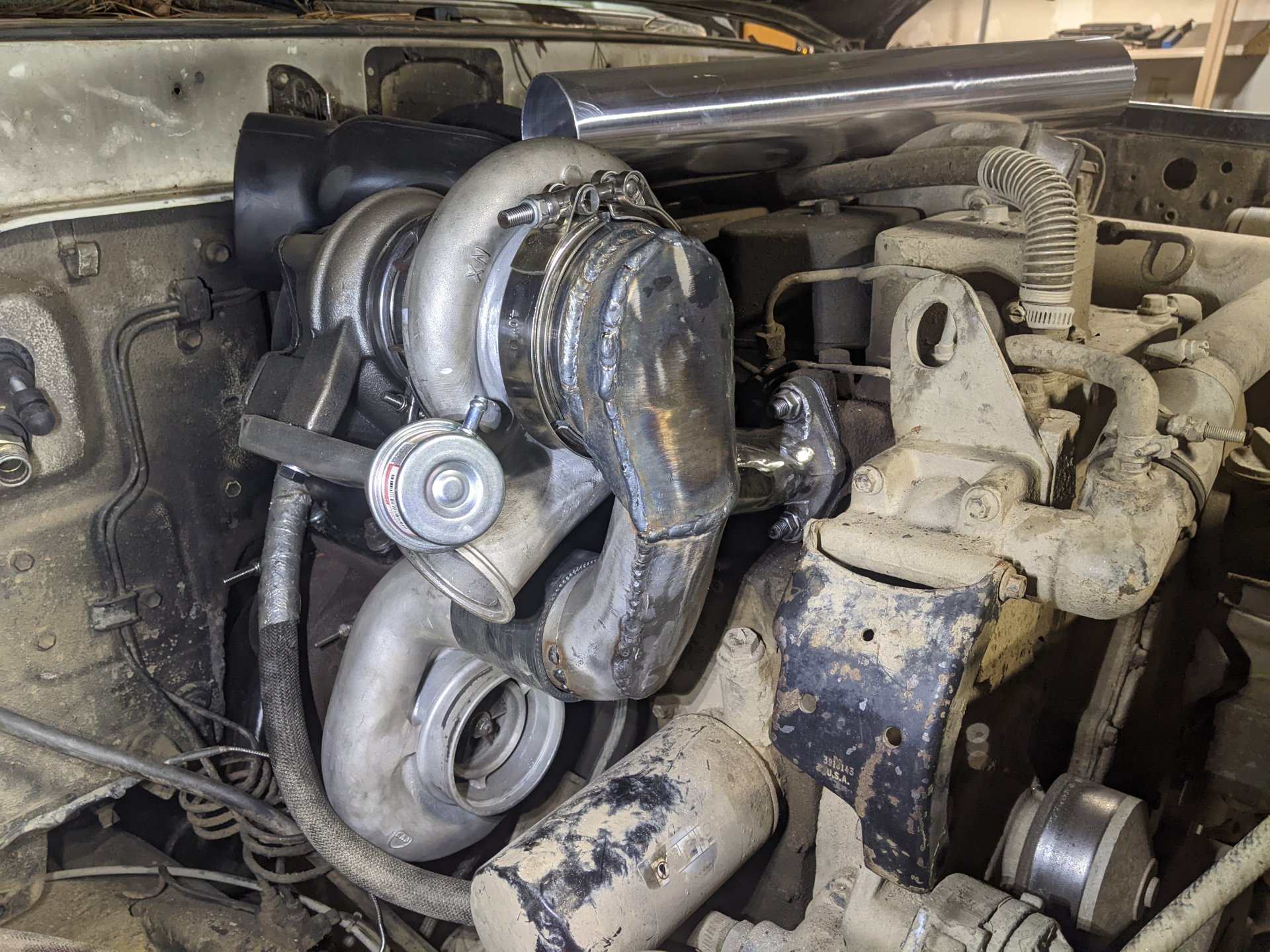

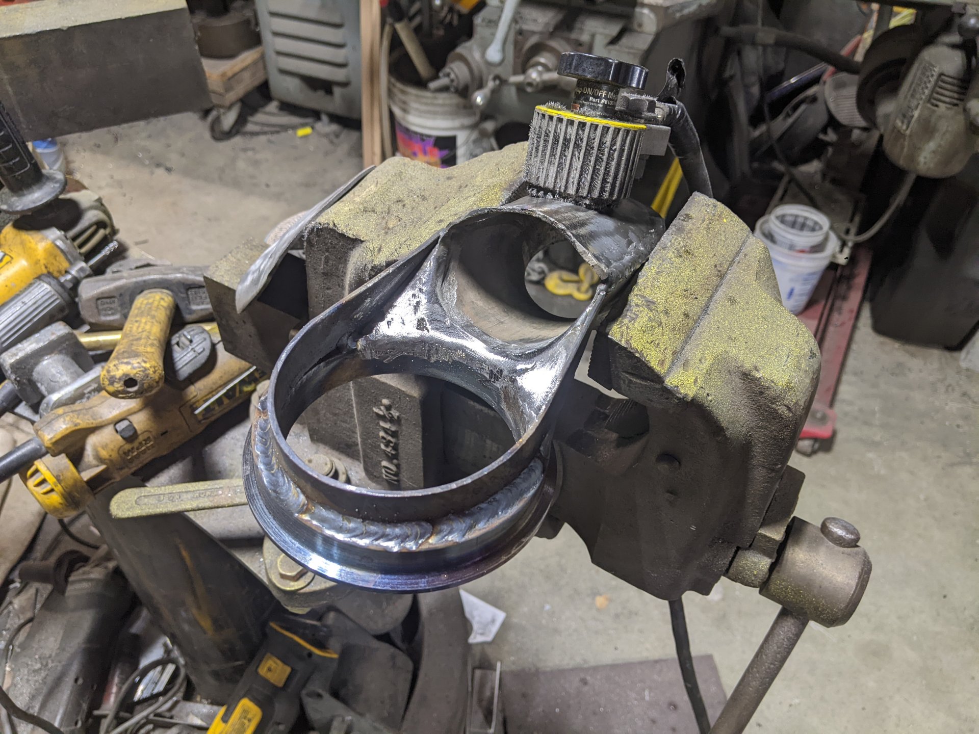

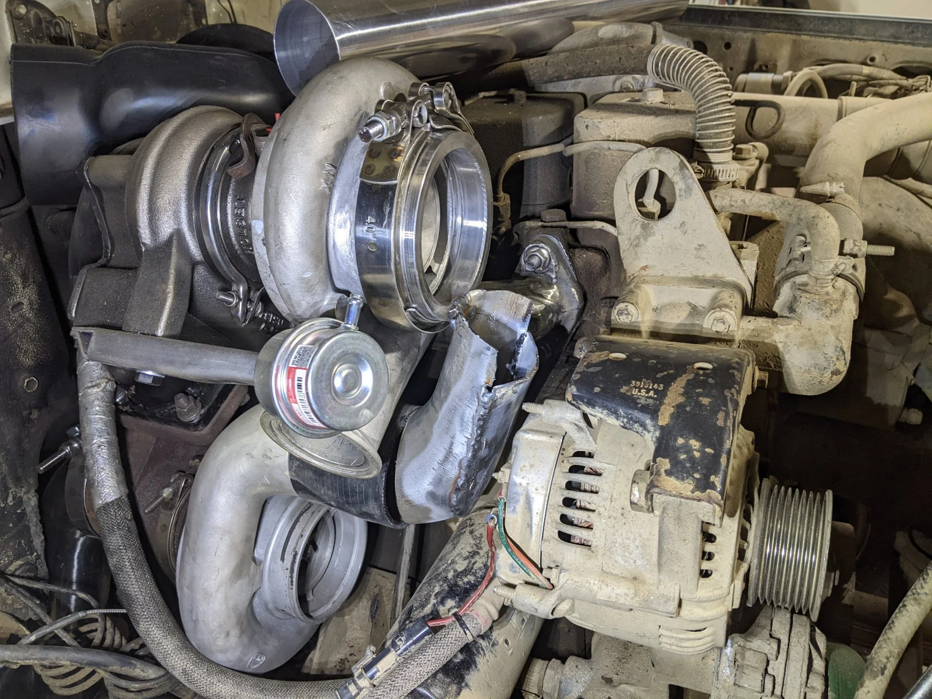

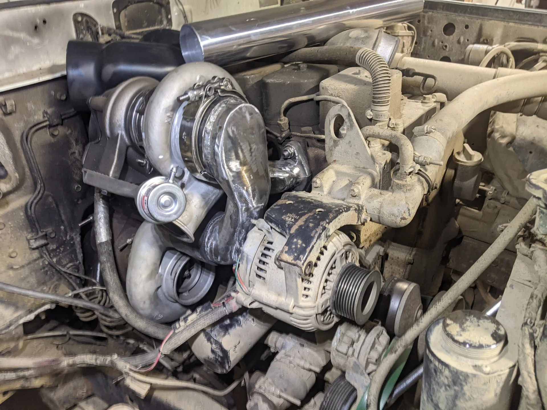

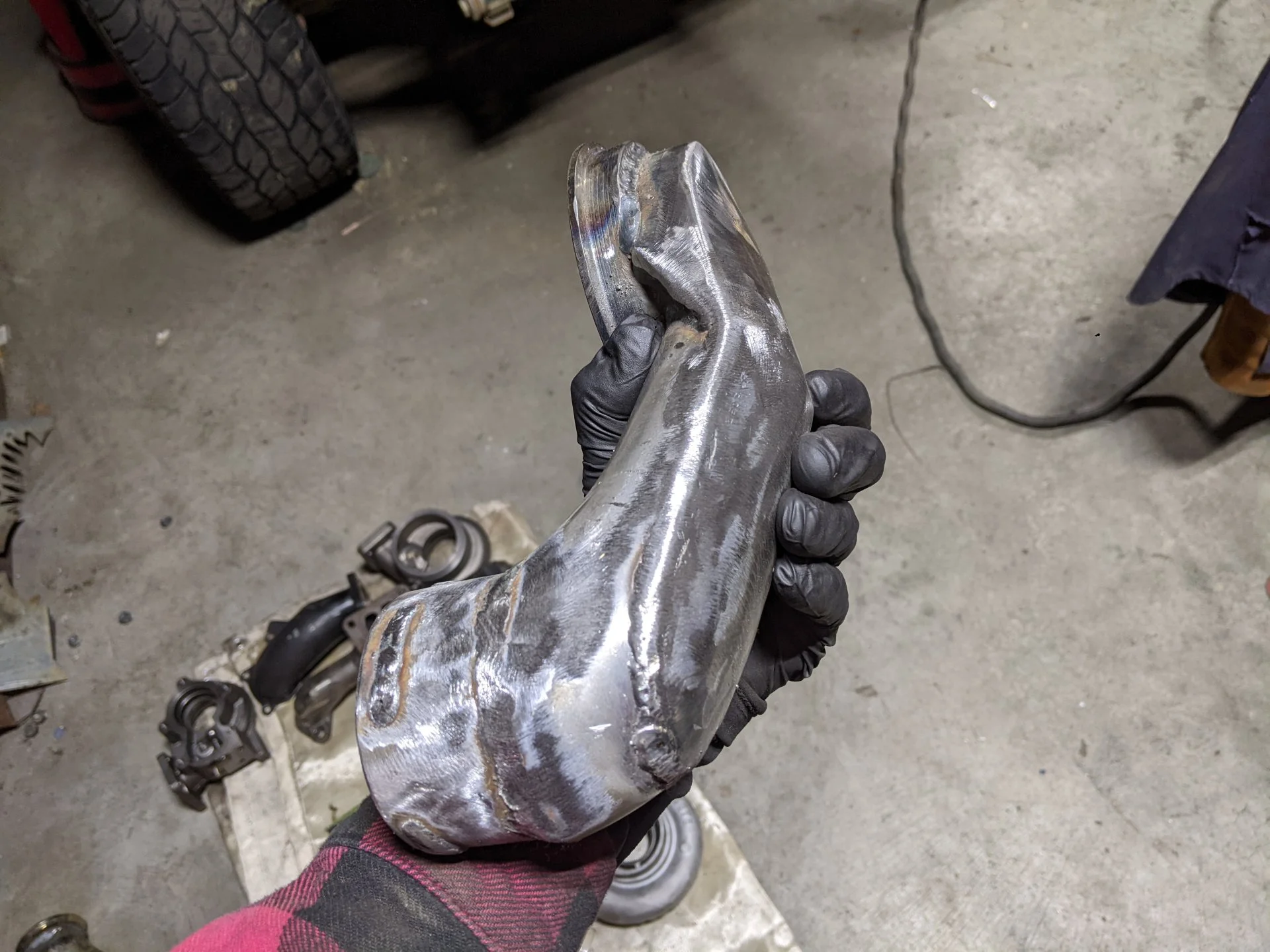

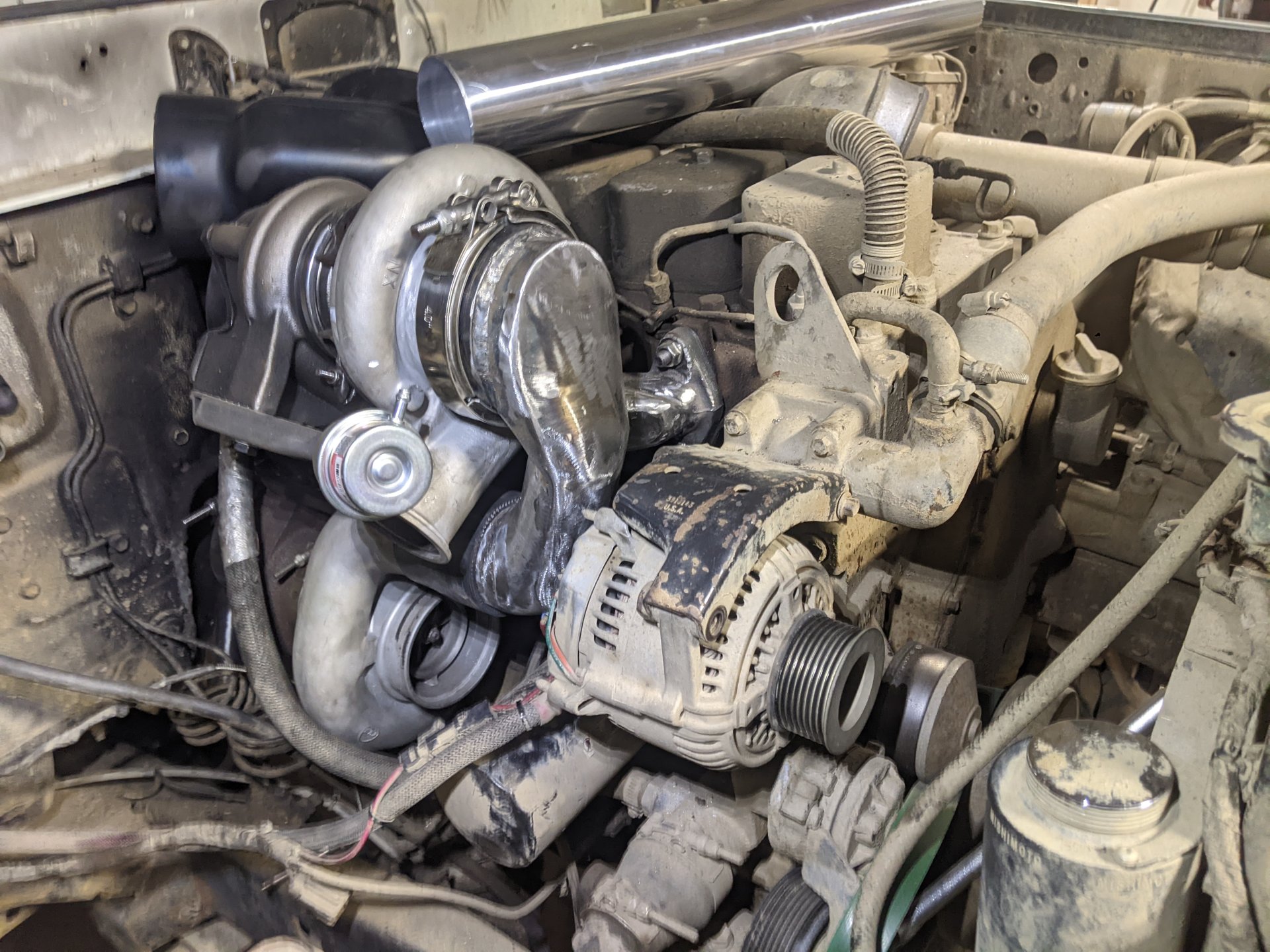

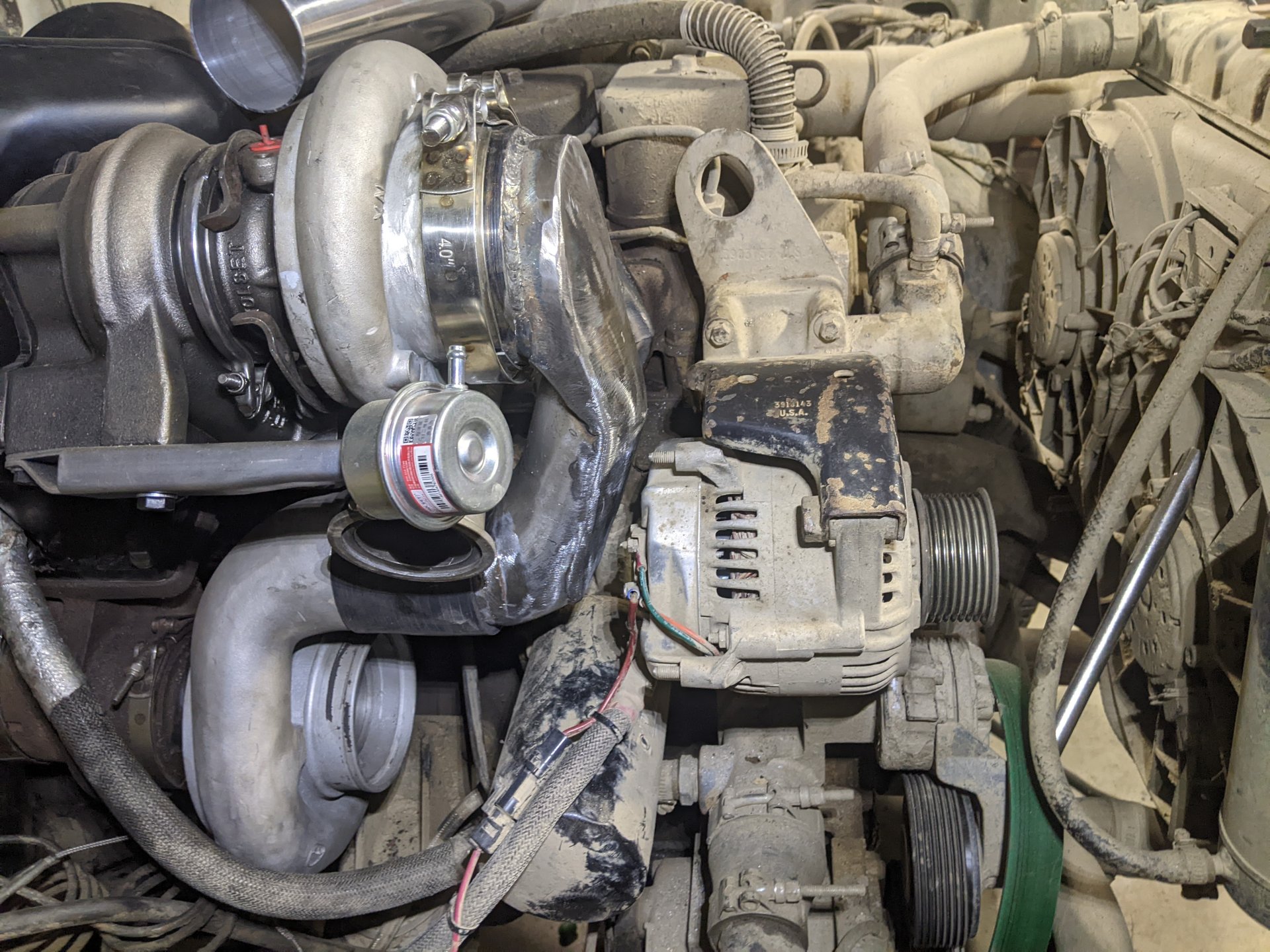

Ended up giving up on the aluminum intermediate pipe. Got decent on the pie cuts, pretty consistent, but the fomed pieces I made kept blowing apart. Not sure if forming them thinned the edges enough, or the adjusting process contaminated the edges deeper than the hand file cleanup would get.
Oh well.

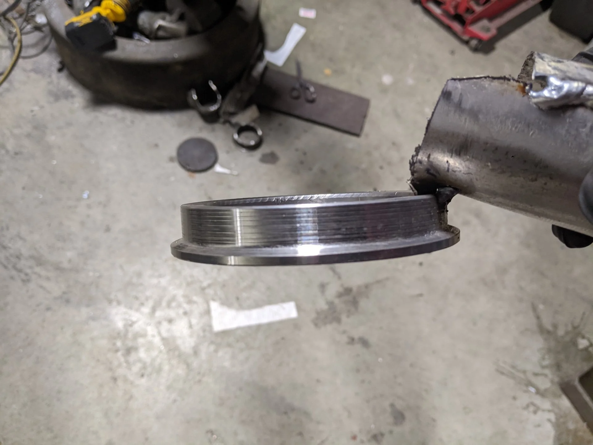

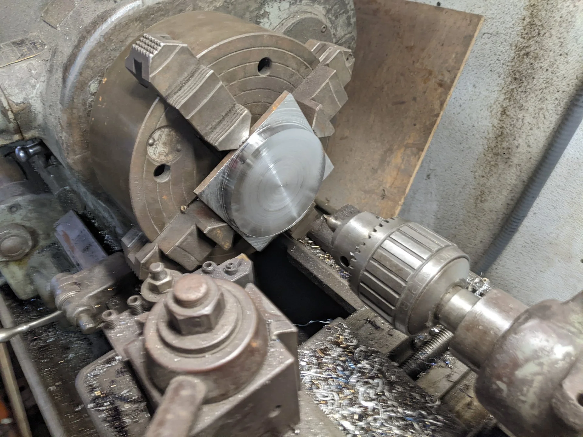

Made a mild steel 4" vband flange on the lathe out of a piece of flat plate. To start from, then started forming pipe.

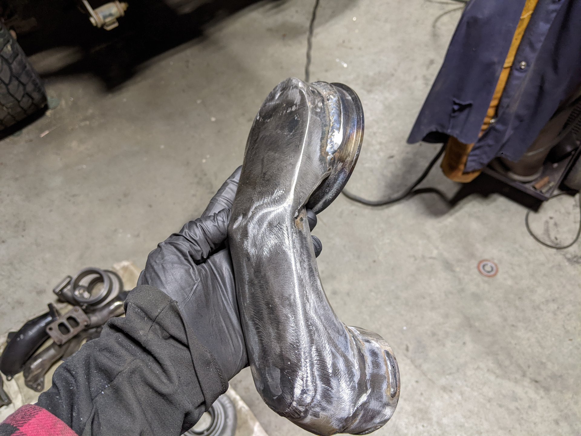

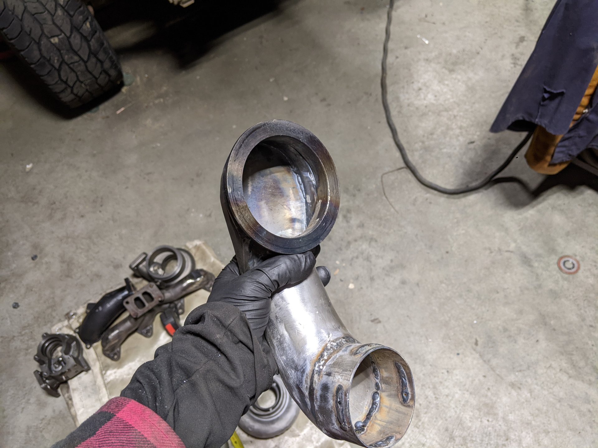

Was happy that far, so I continued. Took a while, over a week, to wrap my head around how to get that shape.
But I'm happy with the end result.

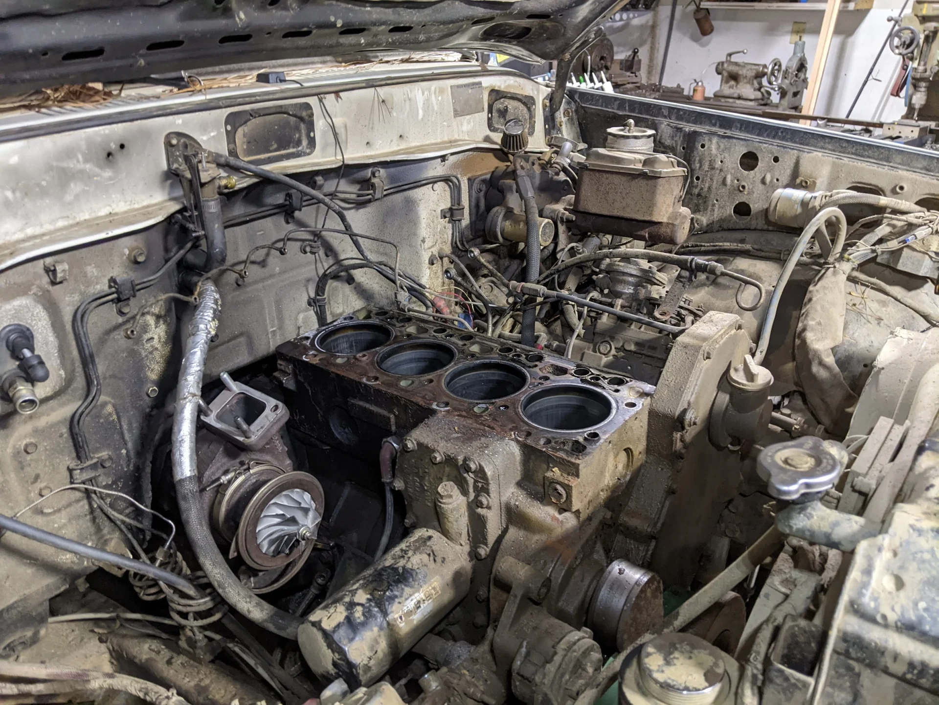

Broke everything down again. Going to send a bunch off to get coated, jet hot hopefully. We'll see what their lead time is like.
While that's all out getting coated, the engine is getting a fresh head gasket with arp studs, and a few other things. We'll see where it goes, but it should keep me busy while waiting for the parts to come back from coating.
Sending the exhaust side out for charcoal, and the intake side for a burnt orange color.

Digging that intermediate pipe. That looks great and gives you tons of clearance.

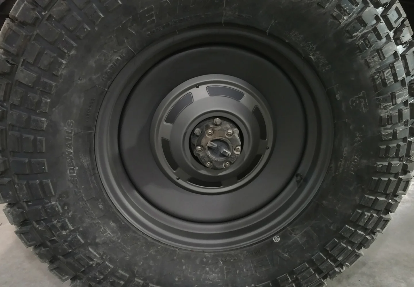

I started out using the heat cure for firearms and had been doing that for several years before I built the target carrier so that’s what I used in the beginning, I Cerakoted everything with the exception of the body panels and it’s still holding up remarkably well. Recently I started using more of the air cure and I really like it, these are my wheels that I coated last year and they still look just as good as the day I did them.
For your hot side you’ll want to look at their high heat coatings. I painted everything from the head to the tailpipe with the “GLACIER BLACK” and it still all looks great.
That wheel looks awesome.
For future reference a hand file is not always the best to use for cleaning up aluminum edges prior to welding. Even using a file cleaning brush on an Al only file, particles can still be transferred from the file to the Al contaminating it so you're left chasing your tail.
I'm regretting not pressure washing the engine bay before starting this project, lol.

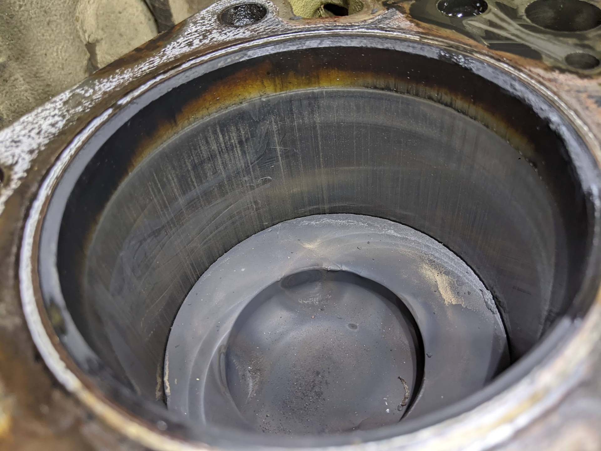

Not awful, but not amazing either. I'm sure this is because of the two times I've overheated this engine.
Can't feel them with my finger or with my nail, but they're there.
