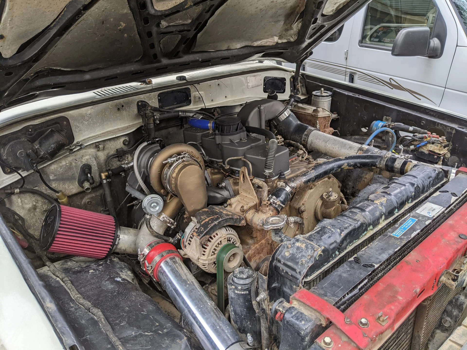

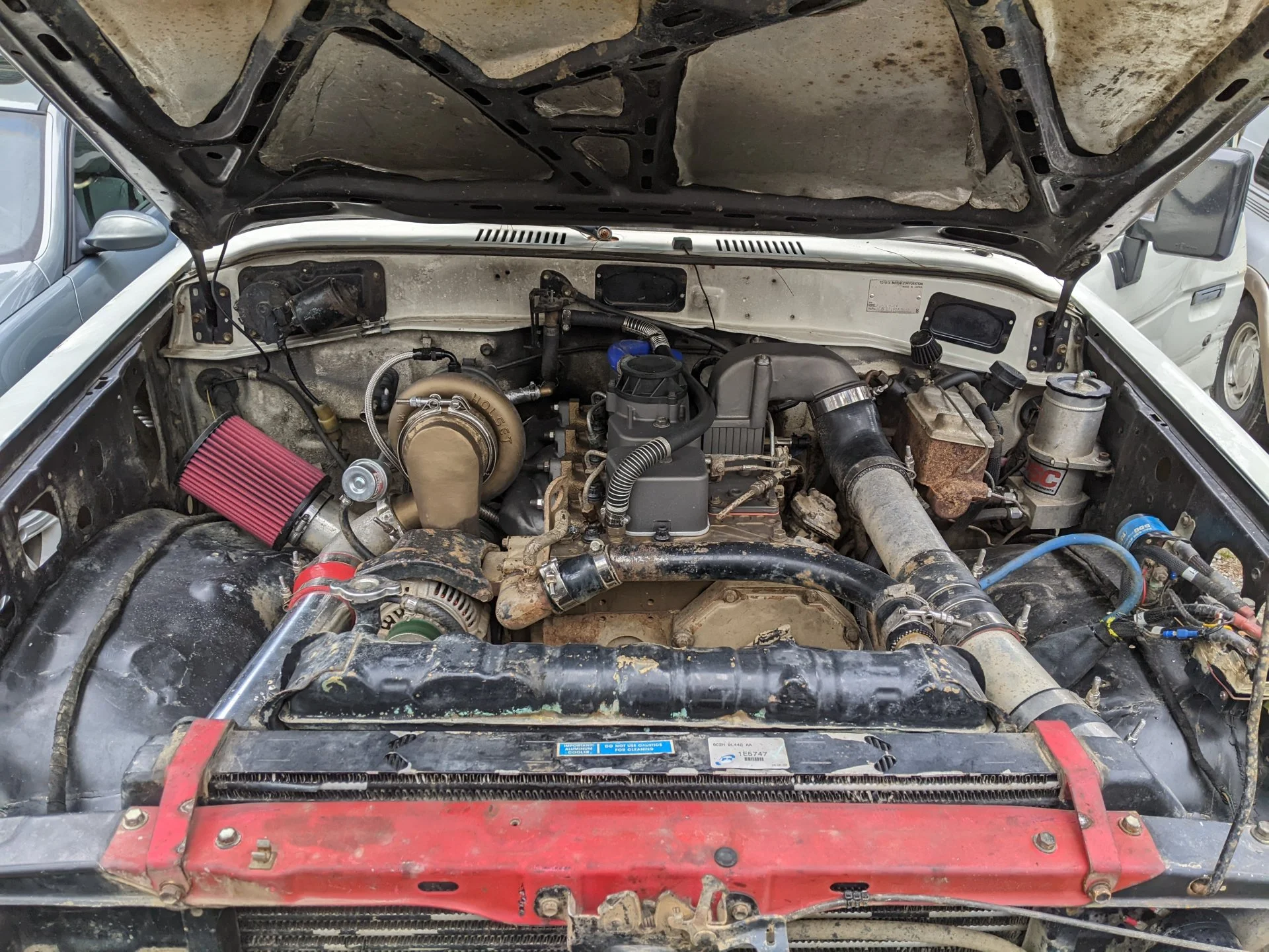

I bought a cobra head but with how close the bottom outlet and top turbo are to the bottom turbo intake, the cobra head can only point straight out the side, which isn't ideal because it's pointing straight at my shock tower. There is some space for a 90* up, but not much. If my elbow plan doesn't work out I'll have to go that route.
For small to intercooler I just have boots. It's pictured in my last post. We'll see if it holds.
I see the last pic now on your last post. With the elbow being metal you will probably be ok. That double compressed air gets hot and was pretty much slicing through my silicone 90 degree elbows so having metal there already should keep you safe. Does your metal small to intercooler pipe have beads on them for those couplers to fasten against?
Yup, everything has beads. Only point of concern is that the turbo outlet to intercooler isn't a straight shot, so the tube isn't sitting square in the couplers. The bead is behind the clamp with plenty of boot, but it's still not ideal. We'll see how it goes. I can fabricate a s-section intercooler pipe if I need to later.
