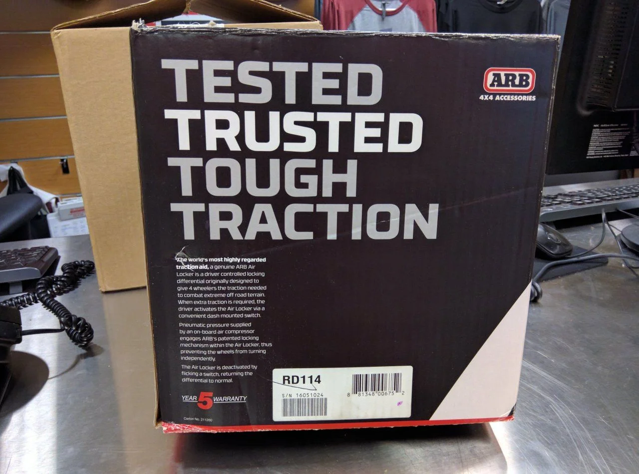

I've been distracted of late, expanding my garage, but I did pick up a fun part today :grinpimp:
