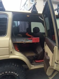

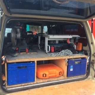

Hey just caught up on this thread, huge fan of the wagon thanks for the inspiration, just wanted to show you my box setup as you were after one a few pages back, could be way too late but anyway, i think everyone has different needs and i wouldn't get rid of my rear seats even though they are folded down 99% of the time, my main box fills the boot and stops where the seats fold, its set to the same height as the tailgate which is a bit high for sleeping but worked for my tool cases and those cheap plastic boxes. then a second piece of ply spans from there to the top of the rear seats when they are folded, i can sleep on the top especially once i put the carpet and underlay down, a must to stop everything sliding, the two little cubbies have hinged lids and magnet catches for recovery gear and spares and then the three main cupboards fit all my tools, 6x9 speaker boxes go ontop of the wheel arches and the hinged lids cover those as well.
just a note also if you don't have central locking (i don't) set the back seat area up with the stuff you use more regularly on the drivers side, leaning all the way across these trucks to unlock the back passenger door is bad enough let alone after you have just jumped out, especially with your spring over.
cheers.
