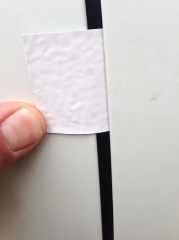

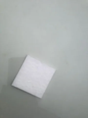

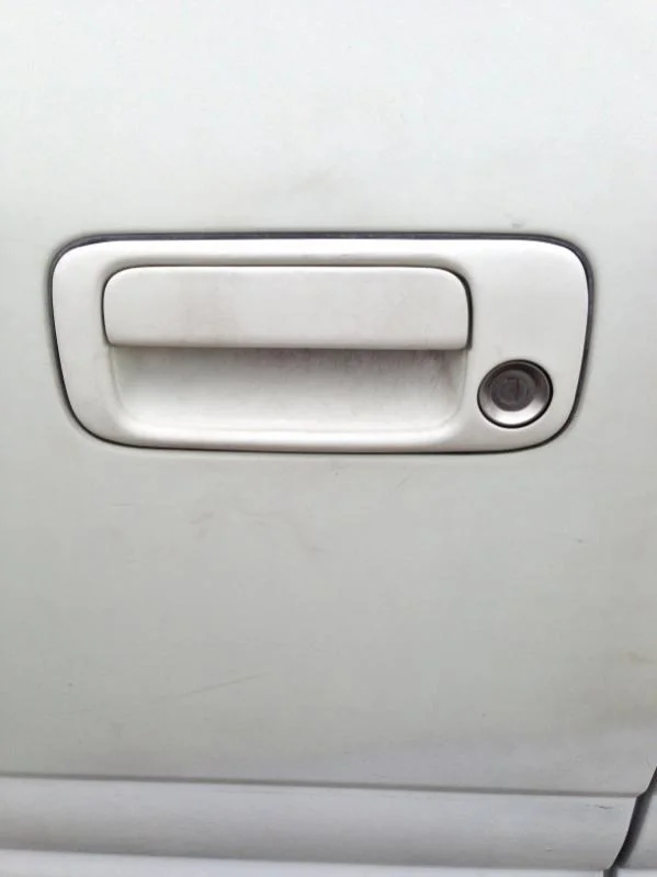

I'm not trying to be anal, but don't think this tint will work for mine, considering the goal is to leave door handles installed, and reason for "white", to begin with.
Realize the pics are about worthless, but....
Open to suggestions or Internet bashing, whichever aids in determination.
I'm really liking the Sans Panties color.
I am, too, but not sure if I would in real life....well. sans panties.

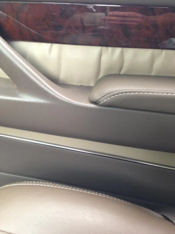

Like a tan for inset portion on door panels that matches ( closely, not perfectly ) the interior of the LX.
Can you confirm?
Sans Panties is pretty green, more OD Green then OD Green. I have a sample of that as well. Seems like the white on your LX is more of a cream.
The other option you have is to get the base texture of MonstaLiner that is tintable and then following MM's instructions on what to get from your local paint supply to get the EXACT color from TOYOTA.
Always an option.
Can you confirm?
I don't think there's any standard Monstaliner color that will match. The closest may be WWII OD Green, and even that isn't close. But it's very tan/brown. There's really nothing green about it. The only time I've noticed it looks green is in deep shade away from sunlight. Any bit of lit hits it and it's full on brown.

Delancy - for the interior I think either Desert Sand or Killer Beej may work... I will take pics in the light tomorrow and if you want send those your way as well.
Thanks for pics.
Requesting a Photochop and hope to determine from there.
The handles have been, and remain being the biggest PITA if this entire process, so hopefully seeing a representation of a finished product may inspire.
Sorry I misread Delancy's post. I thought he was talking about the darker tan color. I agree, Killer Beej would be the closest match for the light tan door panel.
