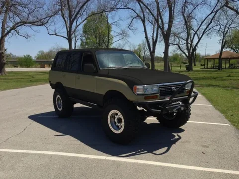

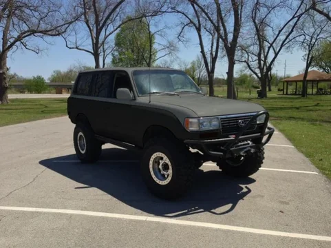

AH... yeah I need to get better with PS. I used to be ok, but haven't played with it in a long time. Personally I like the first and the last. Bodylines seem much better and more suited.
The first the preference, but after listening to reason, going all white using Monsterliner's stock white, the yhinking bring it'll be easier to match when body panel work is necessitated.
So, on to determining the specific quantities of primer and liner for the same area as this pic shows on sides and same elevation on rear door, along with the roof.
In white, along with the process to achieve a uniform, hopefully, smoother finish.

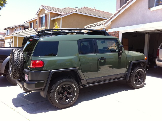

I have been thinking about this for a while now, but I don't want my truck to look like a Oreo cookie. I am planning on doing the sides of the 100 from the door trim down. Has anybody shot a coat of silver on a silver Land Cruiser? I called Line X and they quoted my $800 start to finish for both sides. I think I could do it myself in the driveway.

After all that, considering keeping it simple with MonsterLiner's white, since touch up, possible in the form of sheet metal replacement, will be normal.
I like #2 and #4 the best. 4 I think I would pick as my favorite.
If I had the grey interior, I'd be all over it.
I still like the first, too,
But I'm worse than a woman, plus, if I'm going to do the first, want it to be a gnats ass match to the tan interior.
I think having just the roof be white would make that a perfect color scheme for that truck. Plus it'd be a great throwback to the 40 series' style :D

Hoping to get enough white to do just the unseen portion of the roof and hopefully enough left to jack around with coloration. Will request chips when ordering, but if it's not dead on, then I may sway back to white only.
