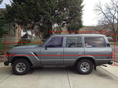

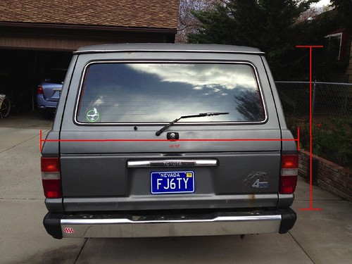

MM, finally got a minute to go out and take some pics with approximate measurements of the 60. If my calculations are right, based on what you were saying beforehand, I should be able to get away with a gallon of each color with approximately a pint of each color left over. This should allow for more than adequate coverage but not a super thick, textured coat.
LandCruiserSide_1 by renofizz, on Flickr
LandCruiserBack_1 by renofizz, on Flickr
