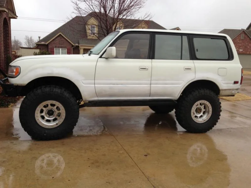

About to embark on lining an LX in, I think, OE white.

I'm not wanting to pull door handles, since the interior door skin is deadened and vapor barriers are recently replaced, but wanting to follow the upper body line, like this:
(VCcruzr's for credit. Sorry, Derrick. Only pic still on Camera Roll)
Plus needing to door the majority of the roof in same Toyota white.

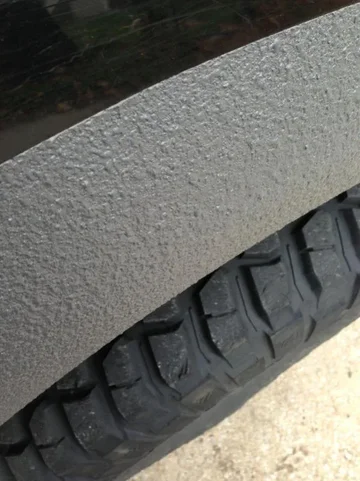

Delancy - for the yellowing from what I have read around the web, the product is UV stable so the color should hold true no matter what. This is stated on their website as well and from the guys on here that have used other colors in high heat/uv areas such as AZ and Las Vegas, NV they are happy with the color stability.
As for the drywall/orange peel texture I think that is more a trait of the products and like products. I had a short conversation with MagnetMan about this as I wanted a pretty smooth texture. His advice was that on the second coat to minimize the amount of rollering you do. As the product sets up and becomes more tacky, rolling over it will pronounce the texture of the roller and product. By minimizing the rolling you do this will help alleviate any unwanted texturizing. I have been contemplating getting a small piece of sheet metal and a quart sized container and then testing different types of rollers to see what one would allow for proper disbursement of the product without pronouncing the texture.

This was Pyroclastic sprayed. Regarding white Monstaliner yellowing, it does not. ML is an aliphatic urethane which is UV stable. Some of the chemistry used to make commercial spray liners are considered "aromatic" chemistry which does yellow hence the need for topcoating. Aromatics cure much faster which is why they are used for spray systems as time is money for these businesses needing to knock out jobs AFAP. It gets much more complex than this simple explanation.
