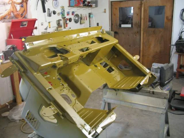

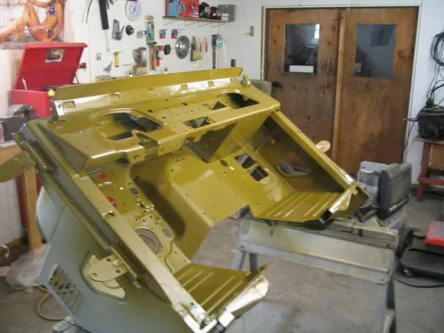

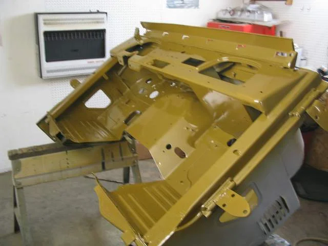

got the inside painted on Sunday, pretty much worked all morning and had to let it dry all afternoon... I want to flip this thing upside down now and get under the dash really well and in all the nooks that I could not get when it was laying flat. I also have to figure out how to get in the glove box and everything without getting a run... anyone know???
also after I paint (Urithane) can I or should I wet sand to get the paint more smooth? If so what grit paper should I use?
Here are some pics..
yea... I am happy about that.. there were just 4 small dents in it that got fixed before paint...

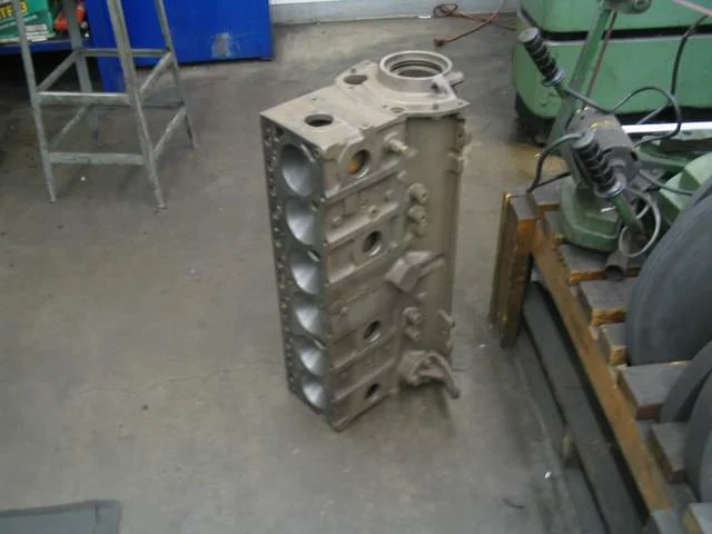

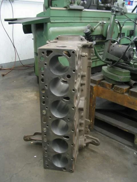

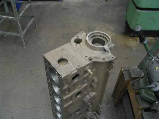

Got a new push rod in the mail today from Poser so I brought that to my engine guy... got to look at how things are coming along on that.... he has the block all cleaned up. ( he said it was really bad, that the PO probably did not change oil often) it looked great... going to be boring it out this week. Also saw the crank he has that all cleaned up, said he has to do some more grinding on that to make it good...
Wish I would have taken pics.
Stopped by the engine builders again today on my lunch hour so I could take a few pics of the block... here they are!!

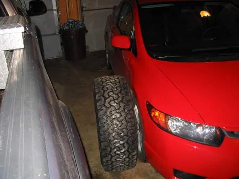

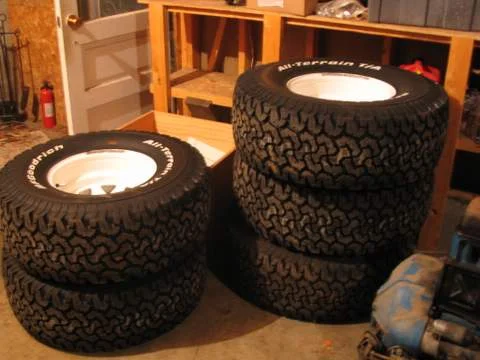

today other that going to see my engine at lunch I picked up my tires... I dropped off my rims last week and ordered the tires BFG AT 33x12.5x15 they look so cool.... I can not believe how much they cost but I have to say I am very happy.... here are a few pics

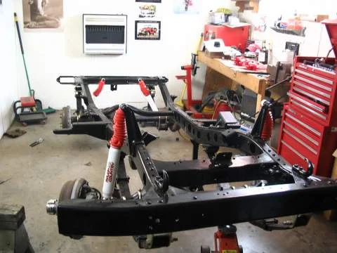

sorry pics are kind of blurry but oh well... started working on the suspention today... got one of the fronts springs in and started the second one... had to quit early today.. been a long week for me...

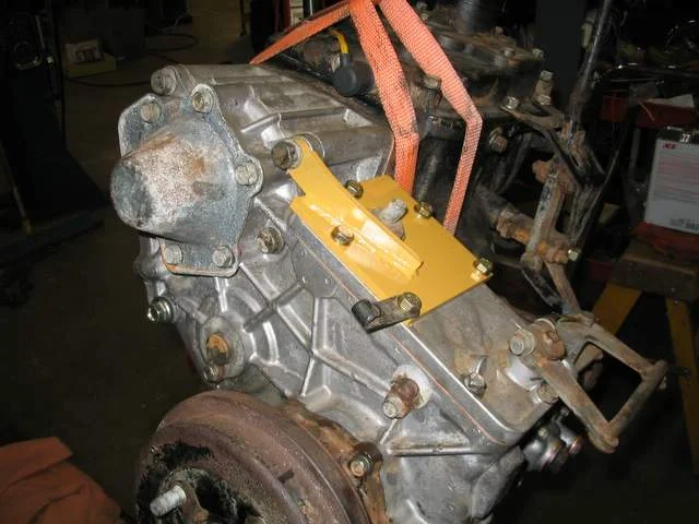

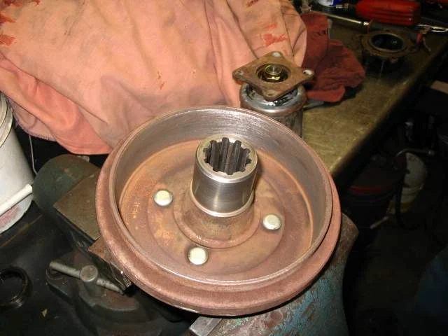

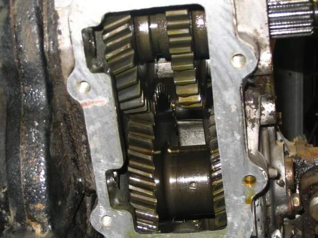

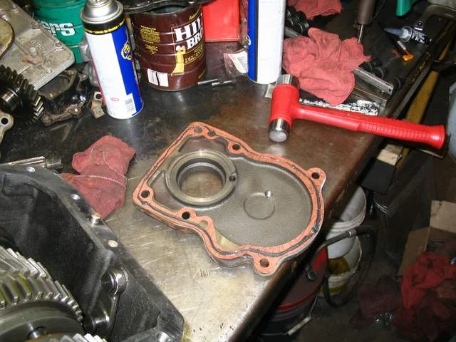

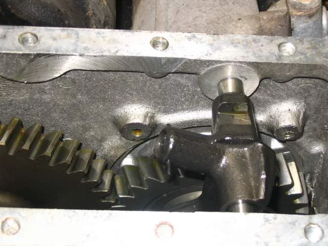

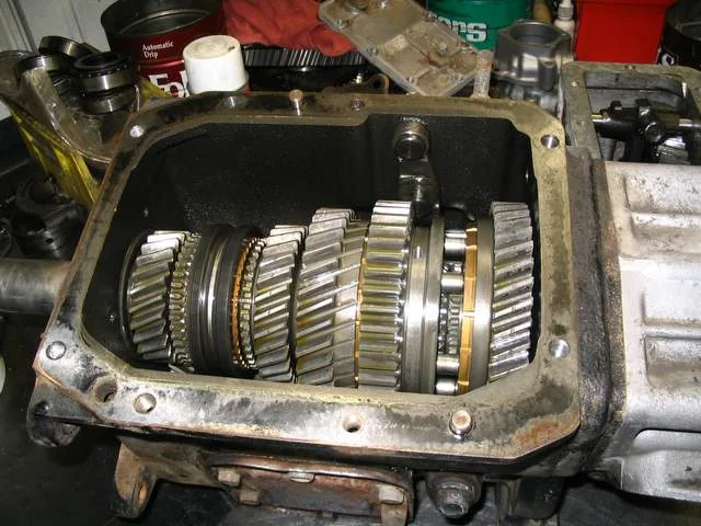

In the morning I am heading south to see Poser, we are going to put new seals and gaskets in my tranny and trans. case... I am going to be ordering a bunch of parts and picking up some more stuff from him... should be a great time!!! I will have more pics to post when I get home!!!

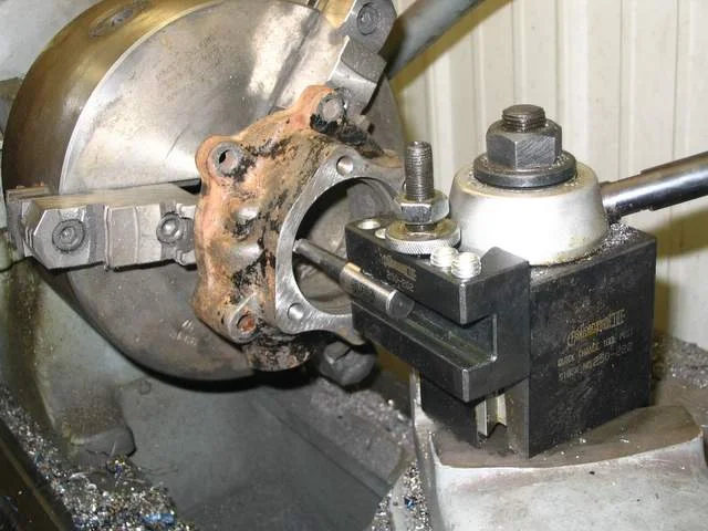

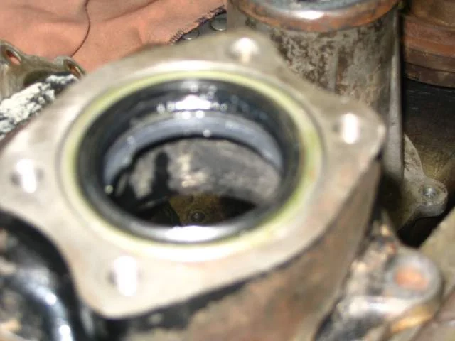

Well I made it back alive from my trip down south to see Poser.... it was a great time... we changed the seals and gaskets in my tranny and transfer case.... machined out the parking brake housing to accept a double seal... added a transfer case saver (painted CAT yellow :grinpimp: ) about 4 -5 hours of work for Poser... I was the student and camera man really... not only did he have to work he had me looking over his shoulder all day saying.... "what are you doing now... why?" so I feel I learned alot

here are the pics to prove we did work for at least the morning!!!

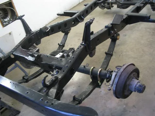

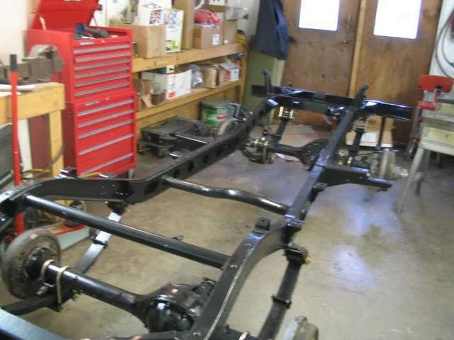

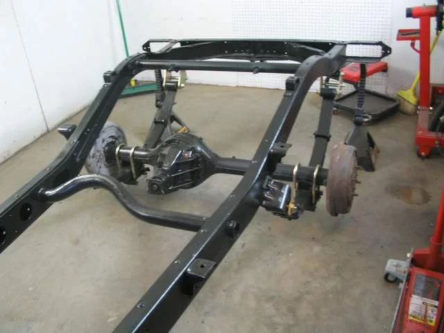

Ok well I felt like $hit when I left the cities... but got a few Power Aids in me and a McDonalds greasy burger and I was back on my feet by the time I got home about 1:30 PM sunday... I went out into the shop and hung my springs and got the axles in place just put everything finger tight for now. It went well!
Had a problem with my house furnace and it was -20 below so I ended up calling the repair guy when my house temp droped to 35 and pretty much ended up messing around with that for the remainder of the night...
Pics of the springs....
I worked for about 3 hours tonight sorry no pics because all I got done was changing all the shackles to the right way (which was a huge PITA BTW) . then tighten up all the bolts for the suspention. got that all done and started getting all the parts all set up for the break conversion in the rear... picked up my loaded Monti calipers at NAPA today... put a few coats of red caliper paint on them....... Guess I was not happy with what they looked like, I whiped them down really well with wax and grease remover before I started but they still had a few spots that would not hold paint.... so I will let them dry and wipe them down again and see if I can get them to hold the paint... if not well guess it is only the calipers....

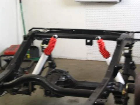

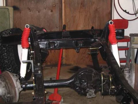

got a ton done tonight... started out by putting the shocks on..... went on pretty much as I thought it would.... not too bad..
check these out
