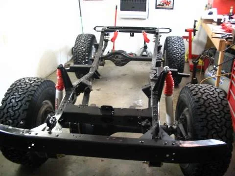

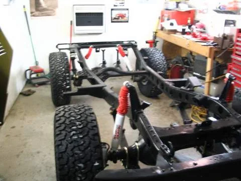

ok... well you have seen my new rims and tires... well I could not wait to get them on and see how they looked... even though I knew I would be taking them off again soon to do the brakes I put my tires on.... man do they look cool.... I am so happy with what they look like... they look so cool... My girl friend finally came into my shop to look at what I have been working on every night.... got to say she was impressed.... (but she called me a grease monkey) :grinpimp: I call myself a grease monkey in training!!!:flipoff2:
Check these out... but for the record they look way better in person... stop over for a :beer:
just a few more... because I am so happy with how they look...

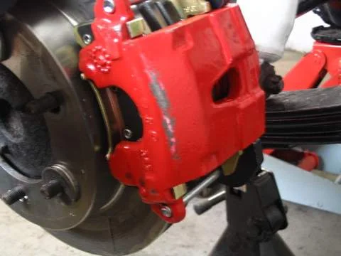

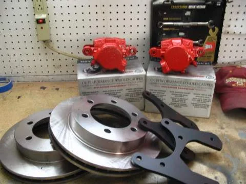

ok... well had a cocktail and hung out with my Gf for a while.... she is leaving for the weekend so we went out to dinner.... after that got a few things ready for my rear brake disc. conversion... I told you I painted my loaded calipers.. I still am not too happy with how they turned out... glad they are just calipers and not something anyone will look at often..

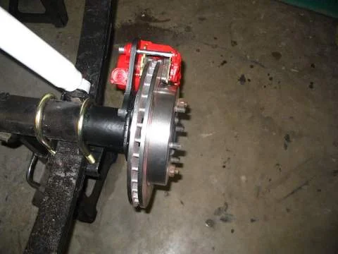

you will see my brackets I got from Poser... I did put a few coats of black paint on them, they come with all the hardware needed to install.. I got my rotors from Poser also... they are the same chevy rotors but the centers have been machined out to allow for the larger Landcruiser axel.. again Poser did this maching work for me also....
here are the parts... I want to have this mod done soon... pics will come as I do the mod...

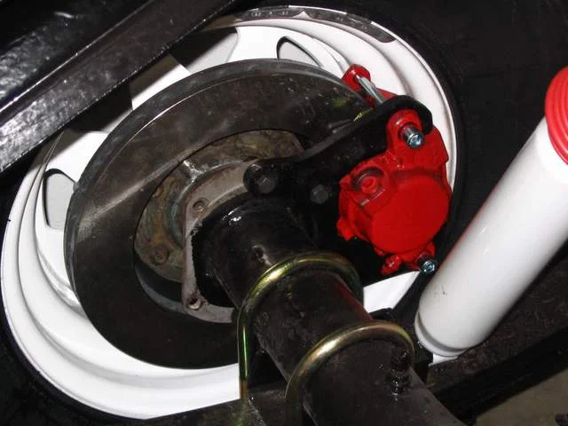

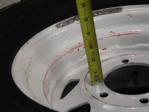

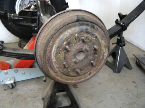

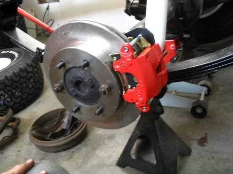

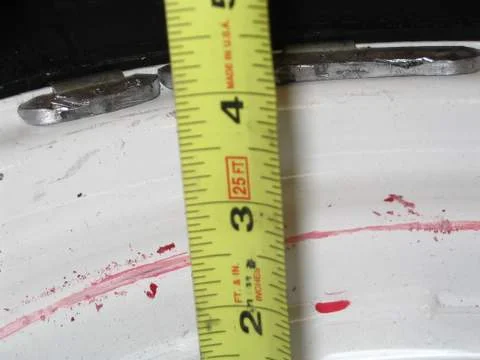

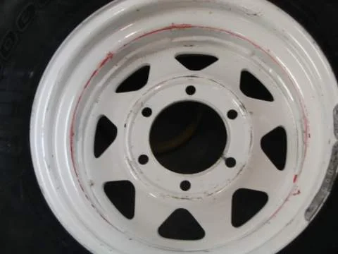

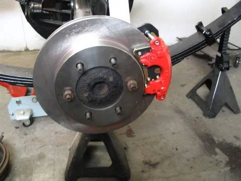

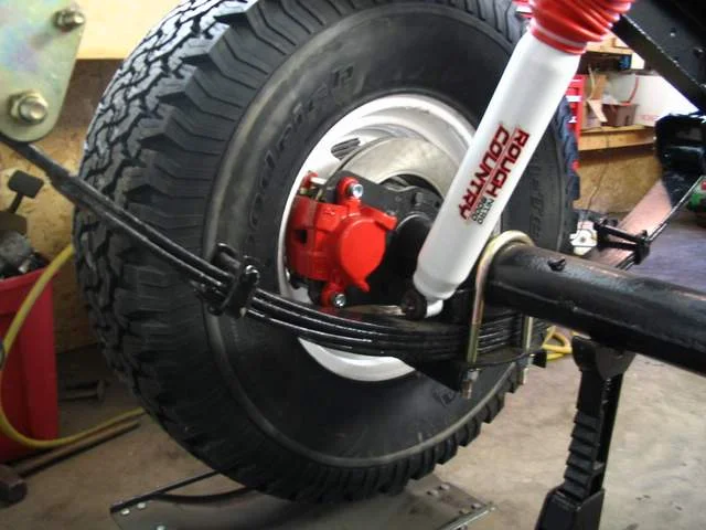

well started doing my rear brakes today... it started out going alright... It was kind of a bitch to take off the rear of the drum... ended up cutting it off with a sawzall.... anyhow got the bracket on there and then put the caliper on.. pretty straight forward... put the wheel on and this is where it started getting s***ty... the wheel was hitting the caliper... ended up calling Poser (three times... thanks man!!) well he told me to put washers behind the wheel to try to figure out how much of a spacer I would need with the wheel that I have...... I ordered a wheel with 2.5" back spacing for this reason, so I would not have to deal with this... Poser said he has never seen a wheel that needs more than a 1/4 spacer to work... I am wondering if the wheel I got sent to me is not 2.5" back spacing and it is wrong all together... It is easy to see where the wheel is hitting the caliper because of the red paint...
what does everone think....

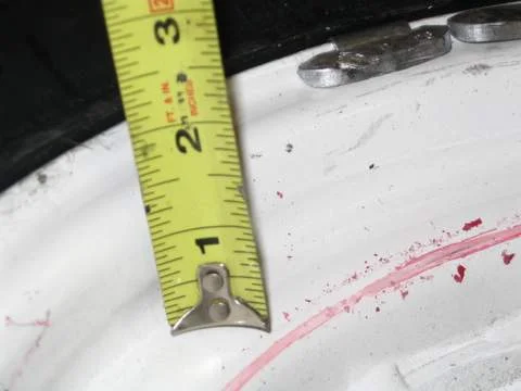

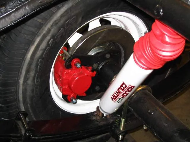

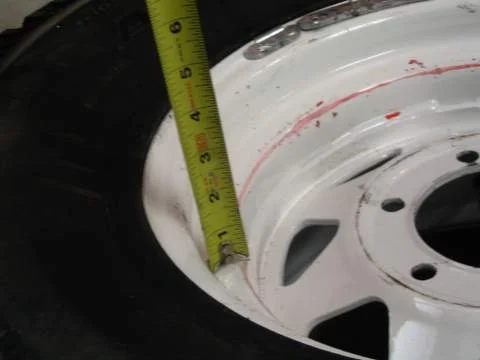

Here are the pics

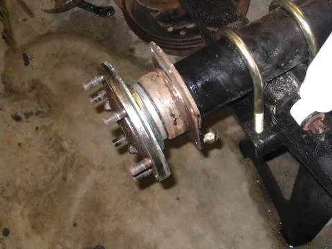

few of the wheel.... Talked again to Poser and he thinks we are going to have to for sure put longer wheel studs on there...

looks like your having the same problems with the rubbing as I had....but I only needed a 1/4 spacer ....

lol!!!! yea the other side went on way better... I picked up some spacers today but ofcourse they did not fit.... but 1/4 will work fine... my old pal Poser said he has a set for me... so guess I will pick those up when I am down there next time
worked about 9 hours today... got a late start as I always go have breakfast at my Grandparents house on saturday morning so started early this morning and took the breakfast break and was back out about noon... finish putting the rear brakes on... like I said I picked up some spacers.... but they were wrong.. as of now I just have washer on there... but they seem to work well with 1/4" spacer.

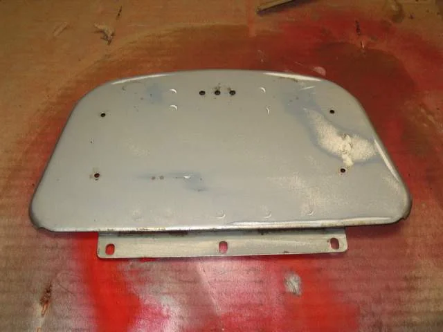

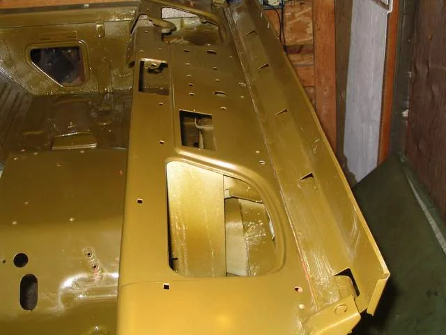

so on the way home I stopped at the body shop supply store and picked up some 1500 and 2000 grit sand paper so I can wet sand my dash... I wanted to do this before I started putting things together so it would be just done.. spent about 2 hours doing this... it came out ok... only had one spot where I kind of wore through the paint... I was kind of pissed at myself because I was being really carful but it is not too bad and not enough to make me want to paint it again... over all it turned out fairly well... all the orange peel is gone on all parts you will see after everything is put back on... here is a pic even though it kind of looks like it did before in pics... but it is way different..

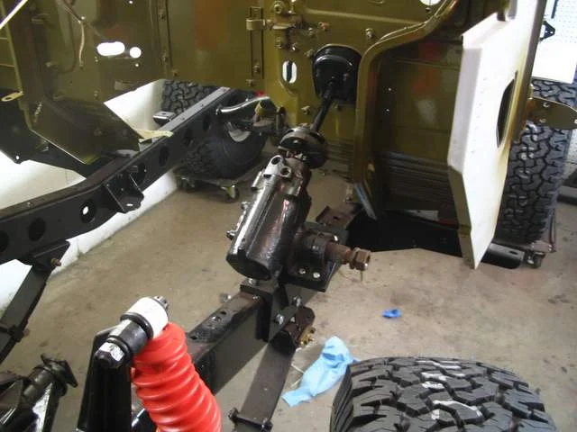

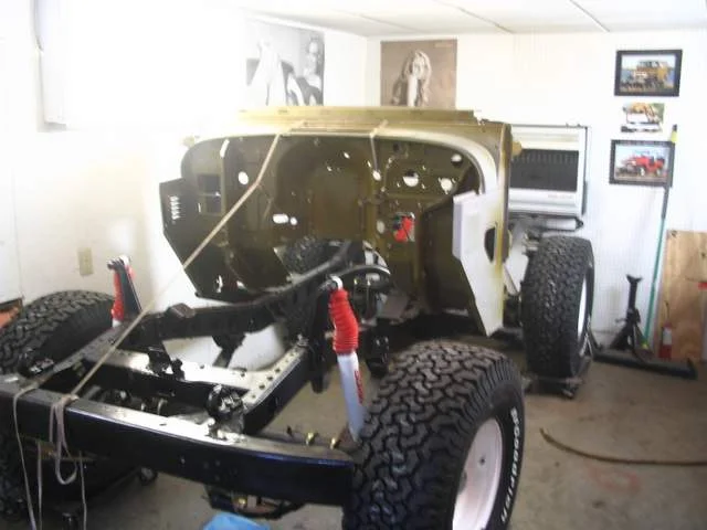

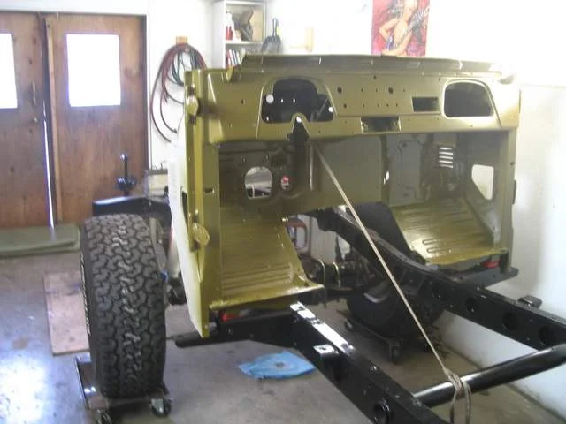

I put the cowl up and got it all set on the frame... I used rope to brace it at first until I got the steering wheel and steering box bolted up.. I sanded down the stearing colum and put a fresh coat of paint on it before I started getting the cowl ready so it would be dry enough for me to get set up when I was ready...

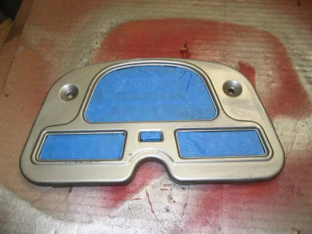

I also painted my glove box and speedo pewder color that I bought from JTO I was happy with how it went on and it did look very close to the original... close enough for me... I seem to have misplaced my ash tray or I would have painted that also... I will check in the other shop in the moring... that needs to be blasted a bit in the blast cabinet before that can be painted however...

here are the pics
few more.. the paint here is still really wet... it does not look like this...
