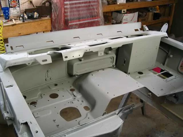

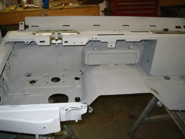

got about an hour or so on the cowl last night... while the primer was setting up I was able to block sand what I had primed before.. found out I have a few more places to put a little mud... not much this thing is in really good shape.
After the primer was set up I put the cowl on its front and got everything under the dash and all those really difficult spots really well, put about 4 coats on there. Just kind of cleaned up the shop as the coats were drying..... nothing special... good thing I did not have much painting to do, it was about 10 degress below zero out so I could only run the fan about 5 min then I would have to shut it off because it would suck all my heat out.... :o
One of my friends is going to help me weld up those holes on Thursday so I am bring the cowl to his place tonight so it can stay warm in the shop.

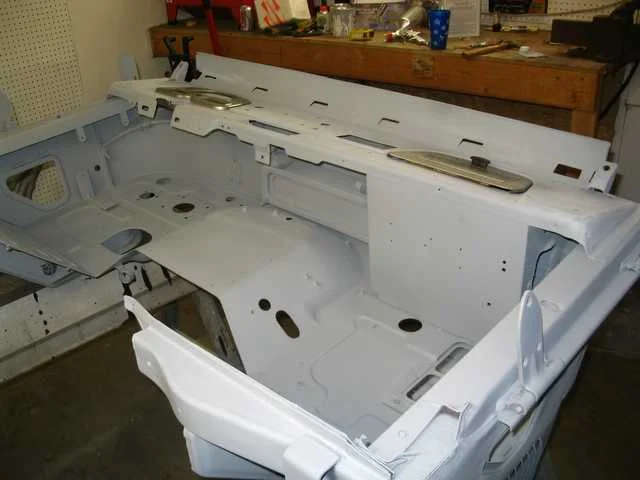

here are a few pics (I just put the speedo and glove box back in there to see what it looked like again)
I told ya it wasn't as smooth;)
But it is a good solid layer..

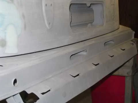

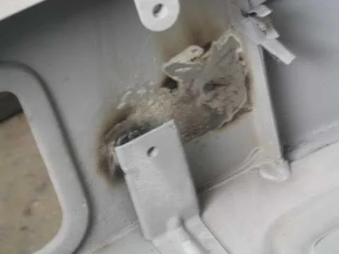

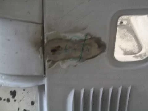

last night I brought my cowl to a friends dads shop and we welded up the holes from the antenna.... He has one of those really cool shops like you see on tv, all the tools, super clean and just a great time... we worked on my cowl for about 45 min and then we had a few cocktails and put in a few shocks in the 71 beetle he is working on... a super nice car... should have got some pics to post. the only ones I got were of the welds.. it needs a small amount of putty but what does not on these things. I am very happy with how it turned out.

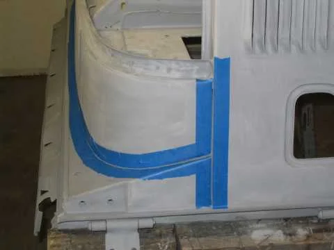

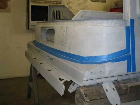

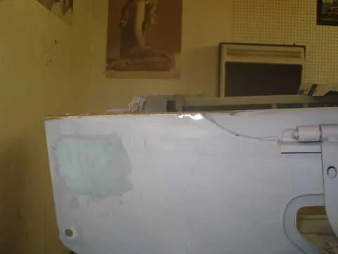

tonight I spent about an hour or so putting a coat of mud on so I can sand it right away when I get home in the evening.. I also spent time getting the cowl joint ready for the alum body.

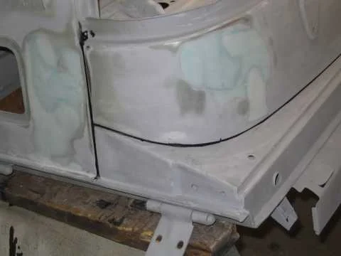

Eli can you look at my pic and see if this joint looks like what yours did? any one else give me some advice?

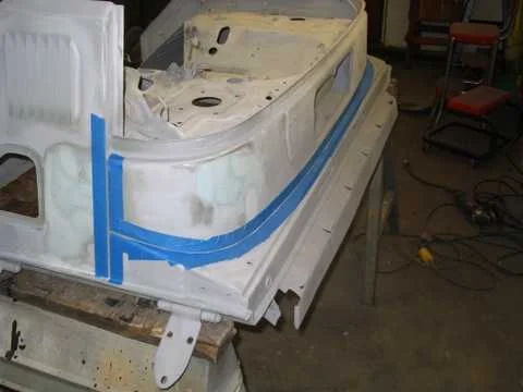

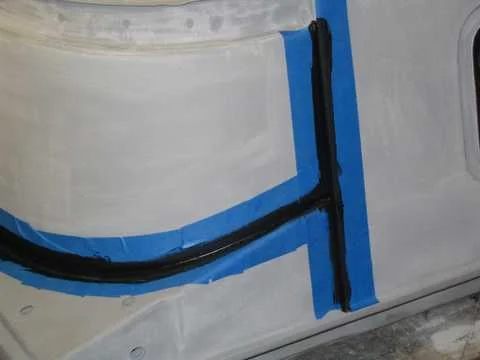

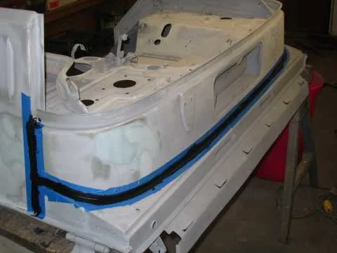

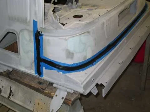

Saturday worked for about 6 hours on more body work on the cowl.. put the seam sealer on based on a post in Matts thread. put tape on the edge of the seam so I could put the bead of sealer down the middle and then use my finger to smooth it out.. turned out pretty good...

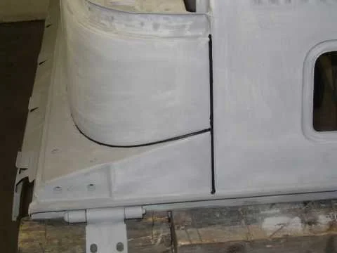

now with the tape pulled... needed a little bit of cleaning up but all in all I was very happy with how it turned out...

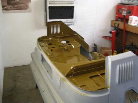

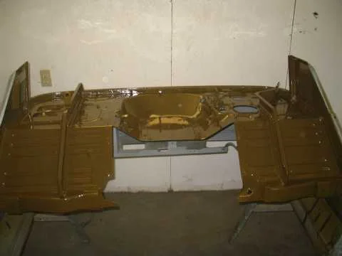

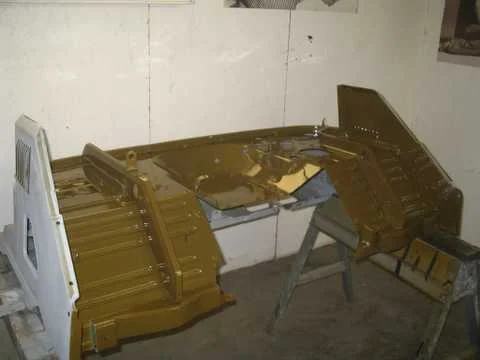

well if you have been reading my form then you know I have never painted before and you saw my first priming job... I went to the paint shop on friday and picked up my paint.... Olive Brown (or Olive Green which ever way you want to say it) color code 653, well I have to admit I did not know the color was the same as Matt's 45 he is doing, but guess it is... good thing I like the color alot...
so I was just going to get the cowl ready for the body shop who was going to paint for me... I was about done with body work so I guess I really wanted to see what something would look like after I painted it... I pulled out one of my old fenders and gave it a shot of paint.. adjusted my gun as needed..
Then I decided I would paint the firewall on the engine side... screw hauling this thing to the body shop right!!!!! :bounce: :bounce:
Over all I am very happy how it turned out... what do you think? :flipoff2:

Well it went ok.. I do have 2 runs one where the heater blower bolts up so not a big deal and one on the bottom on the inside, you will never see that one either.. so guess I know how I messed up there and I will get better with more experience I guess.. going to do the inside of the fire wall tomorrow and then the dash on monday if all goes as planned.. I will make sure to post up picks..

What is that seam sealer stuff that you used? And where did you get it?
I dont remember the brand but I just got it at the auto paint shop where I bought my paint. My old stuff that was in there was pretty bad so I just got it all out. Look at Matt's thread page 28 and 29 and he has a good description on there... I do know the brand I used is not the same as his, it came in a single tub and it was black in color as you can see from the picks. here is the link to Matt's page..
