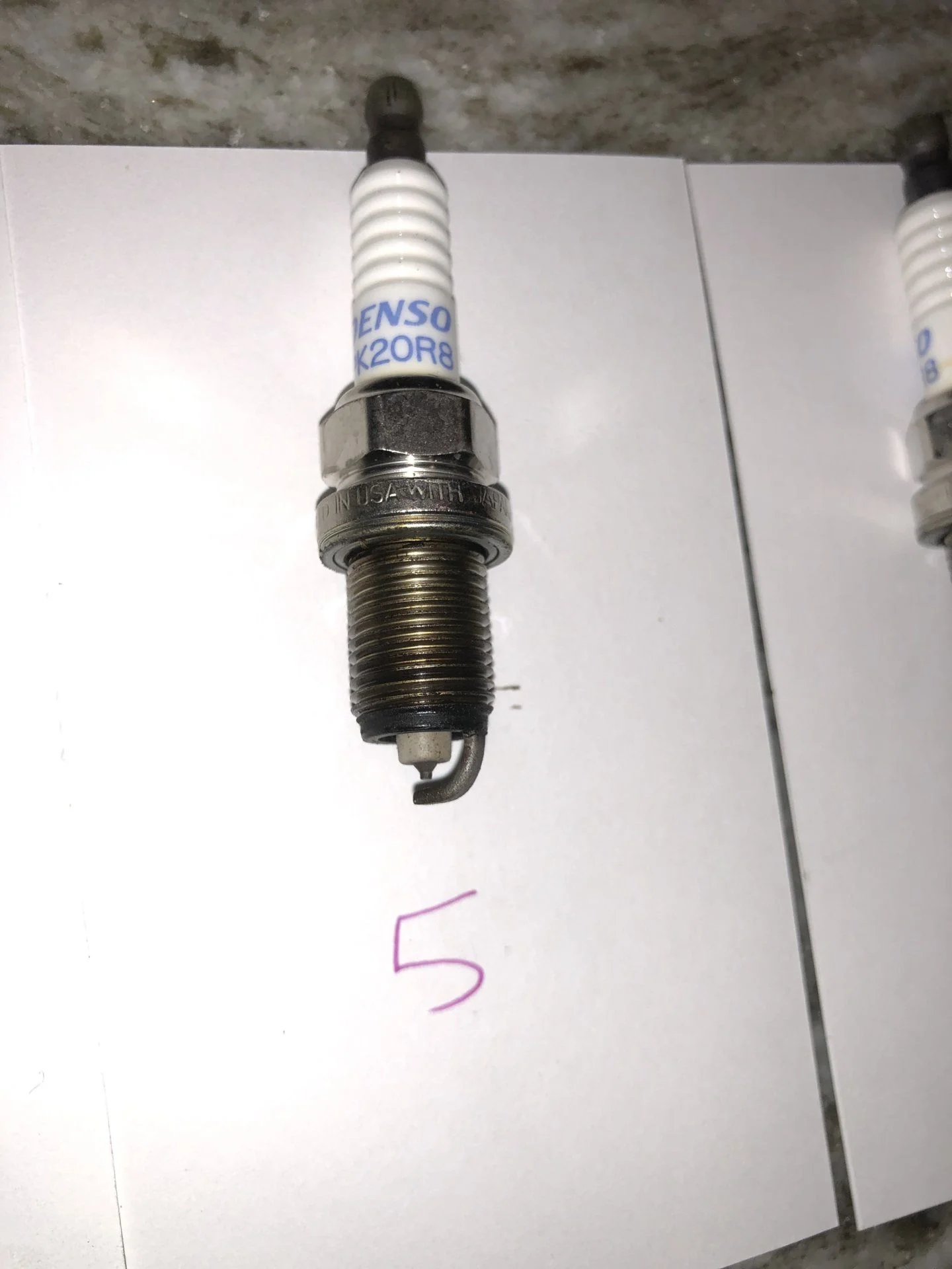

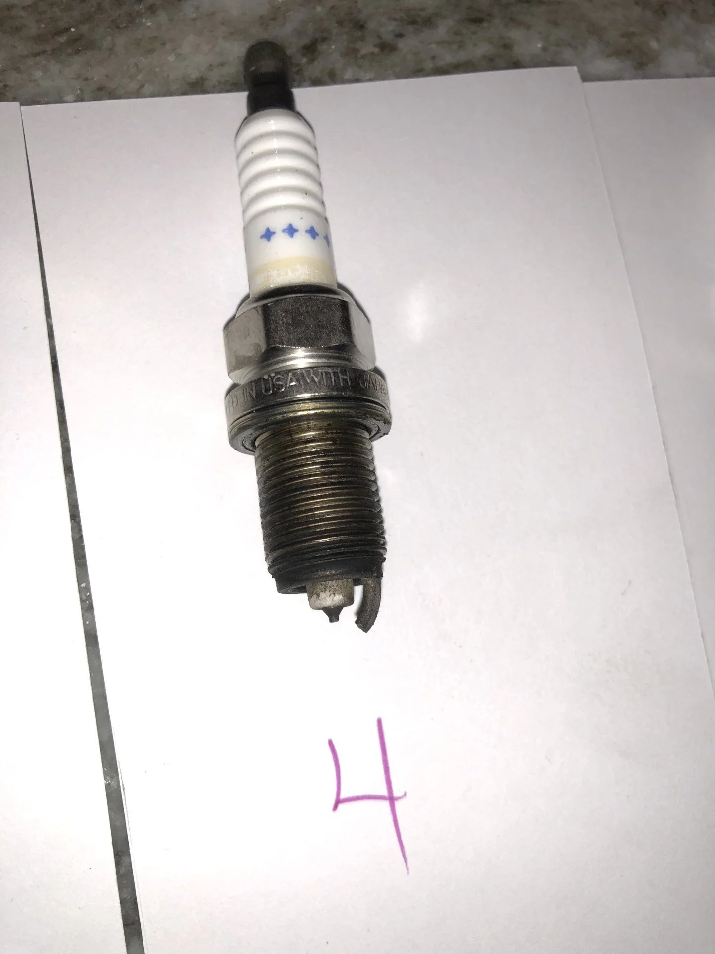

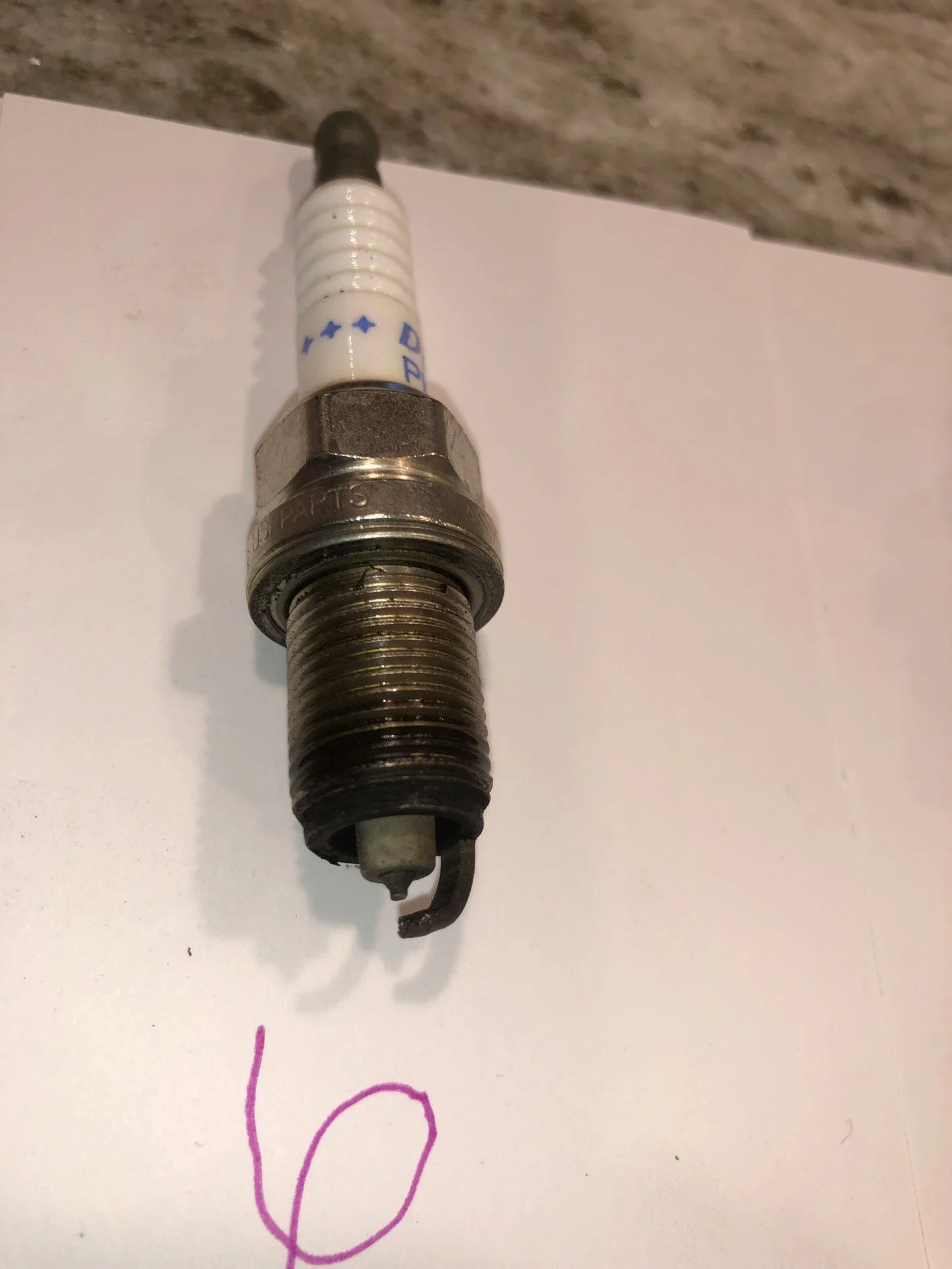

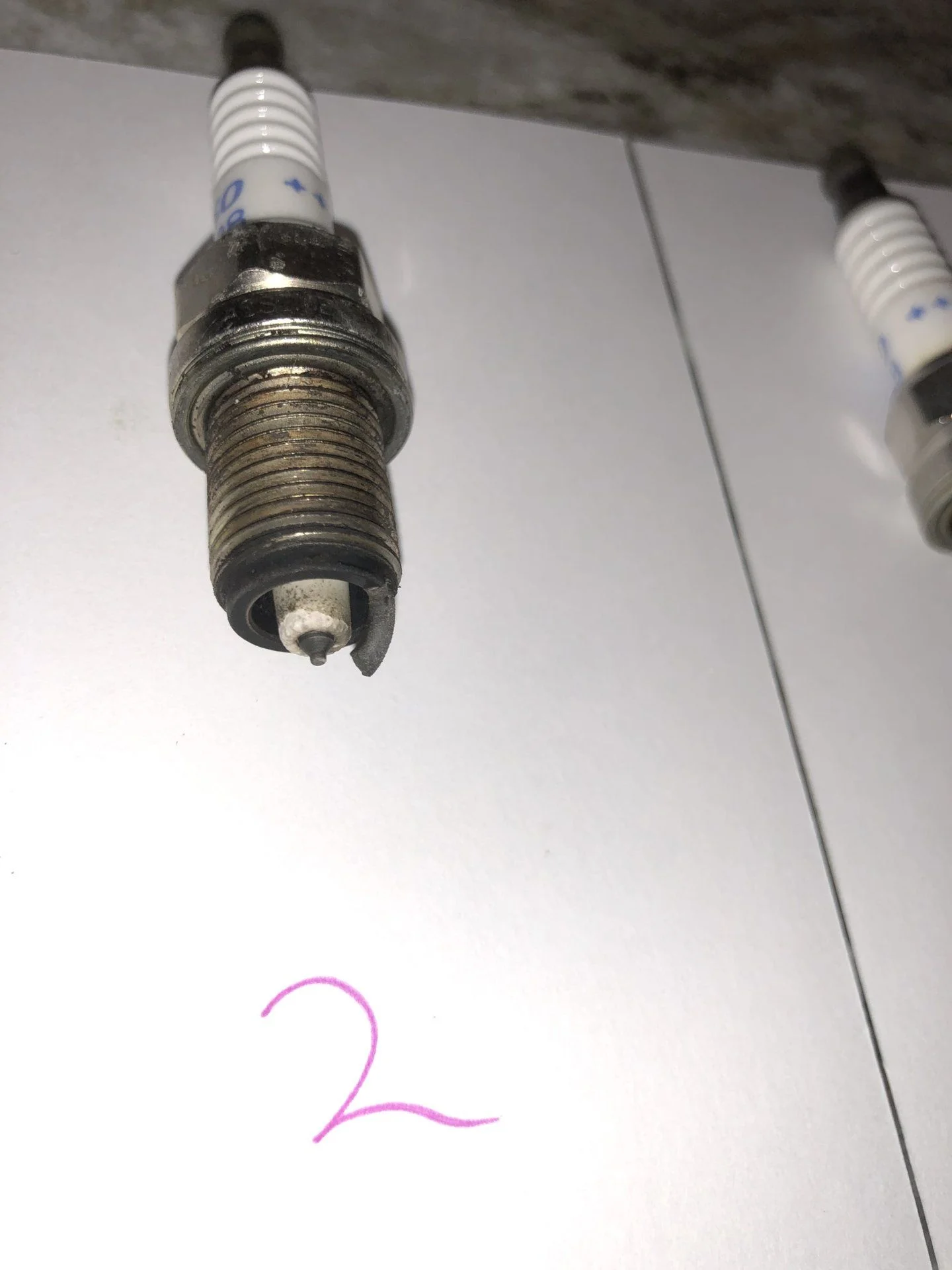

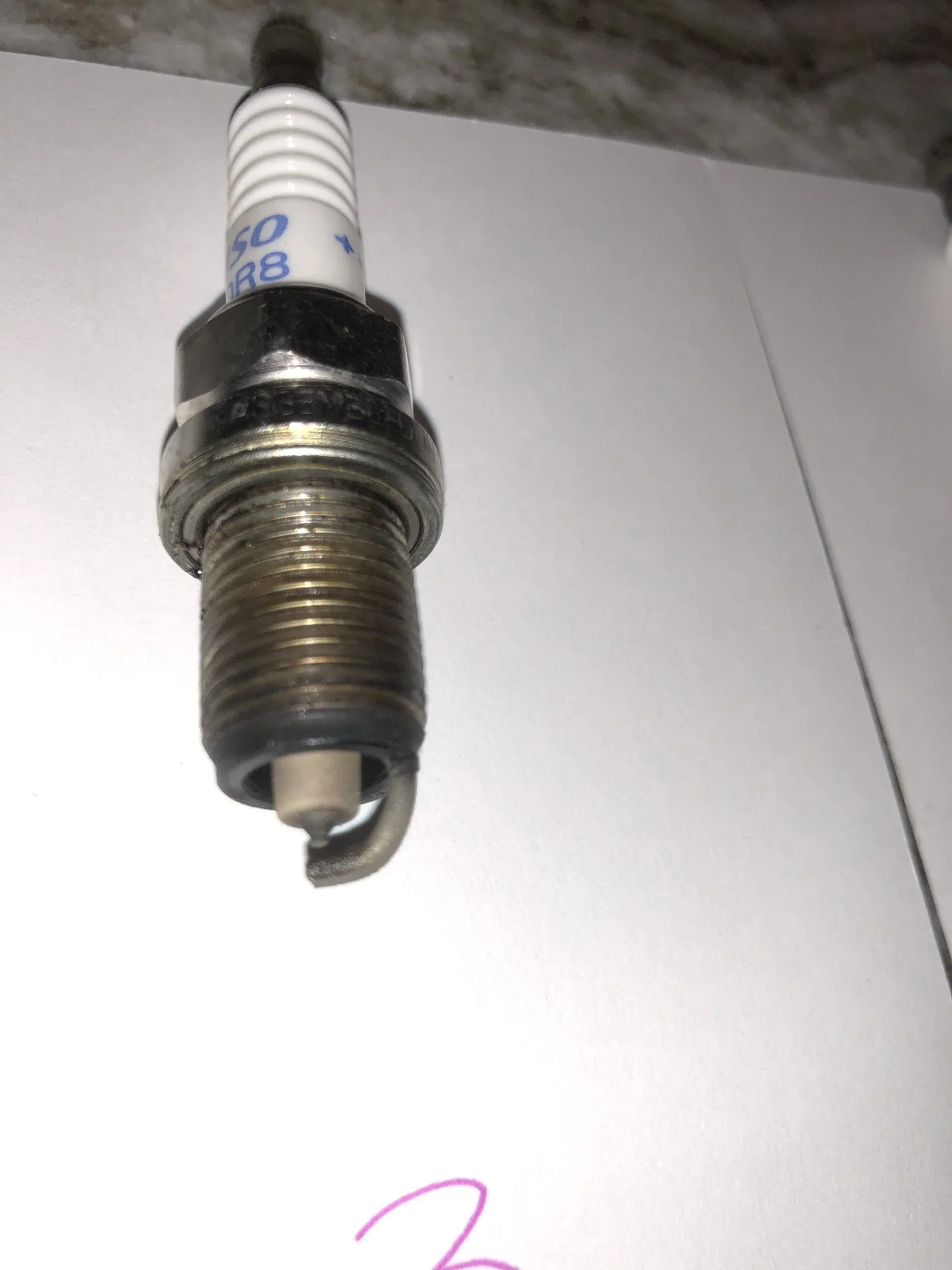

I Appreciate the help guys. It was definitely spark plug problem. Going to be staying away from the 2.8” pulley until @NLXTACY develops us an intercooler. Roasted these in 10k miles
Are all three plugs the same plug number - PK20R8?
What I see from your pictures you are running too hot of plug as there are absolutely no deposits on the tips. Have you checked the ignition timing? It could be that your too advanced or lean getting preignition. It is not necessarily because you need an intercooler. Possible that the fuel injectors are not balanced or clogged.
Typically with the supercharger you run at least a two step colder plug like a PK22R8 or PK24R8. A for a stock motor Denso calls for a PK16R8. The larger number is a cooler plug. There are threads that reference using the MR2 turbo plugs with the supercharger. I don't have that plug number handy.

There is your issue right there, timing. Advanced for normally aspirated and stock for forced induction on the 1FZFE.
Those are the right plugs. I got the same ones from CDan years ago for my SC build. I posted the part number in this thread. For some reason the quote isn’t popping up now.
