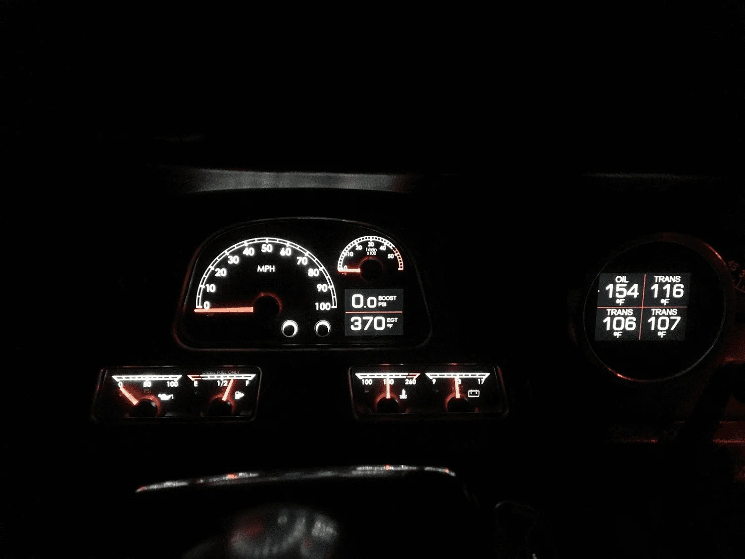

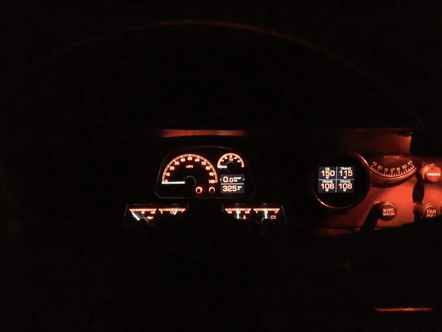

I pretty happy with how the gauges turned out!
Daylight setting:
Headlight on setting:
So far I haven't been able to get the transmission temp over 145*F. We will see this weekend when I take this thing out for a few hours up through the mountains! As I would have expected the Orion temperature rises to just shy of where the transmission runs. A consequence of running the rear drive through a gear set unlike most transfer cases that run straight through. I can't help but wonder about the impact of the Orion's change to a cast iron case on its heat dissipation. I also cant help but think about the tapered roller bearings and how much energy this transfer case robs from the system. (Must be the racing engineer coming out) As for the intermediate box, the temperature barely rises past 115-120 which is nice to see as there should be little gear tooth and bearing loading when run in 1:1.
I wanted to be able to monitor these temps for when I build a new skid plate; I have a feeling that it will reduce the airflow quite a bit but I'm excited to see by how much. I have some ideas already to promote more cooling with the new skid :)

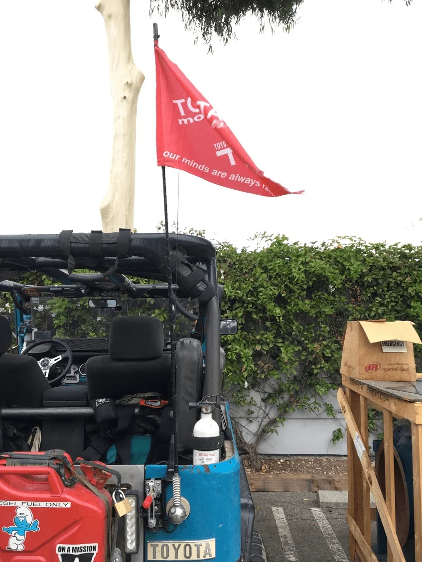

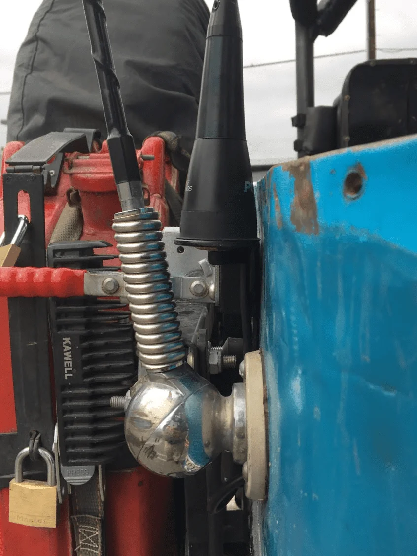

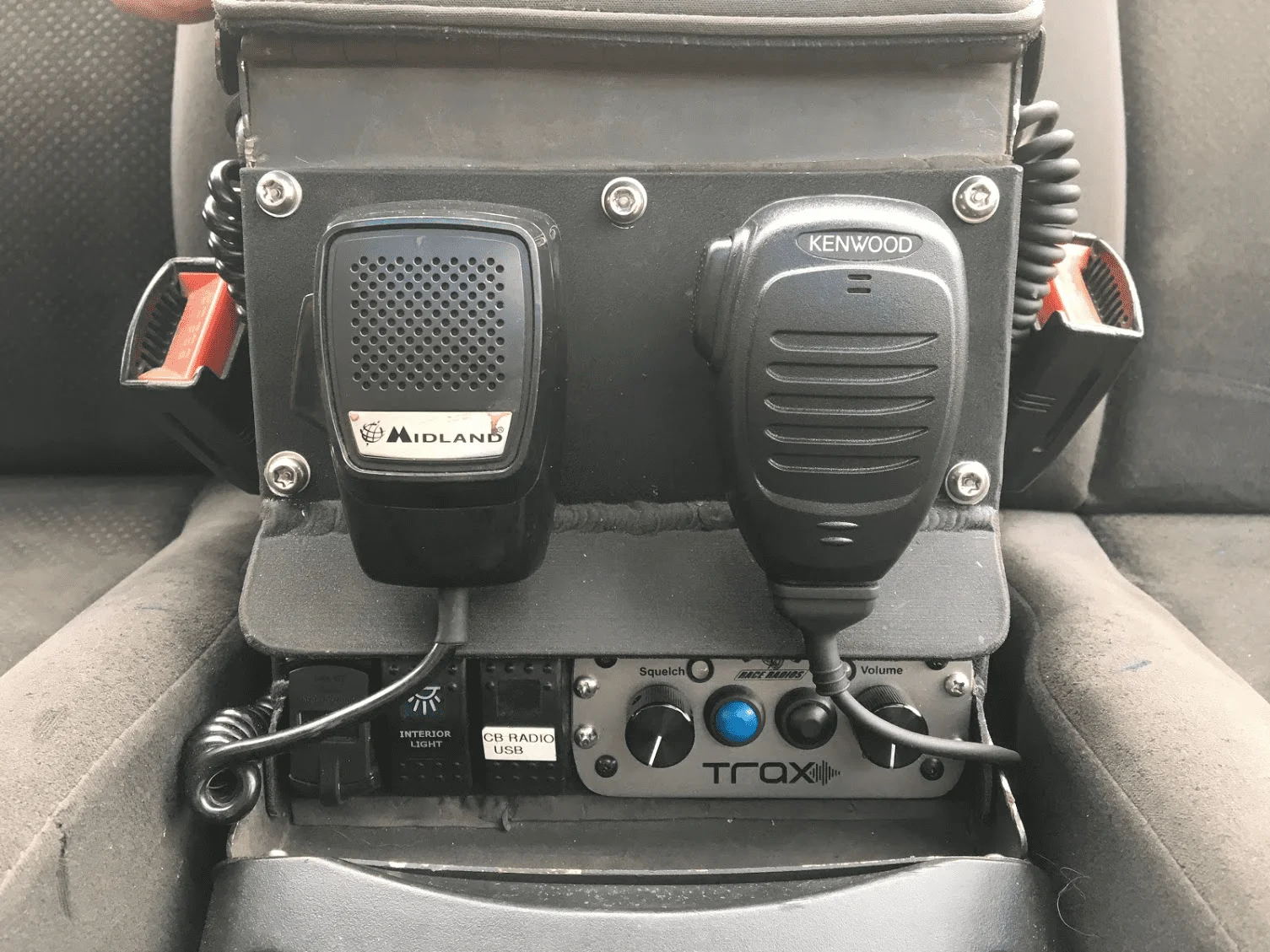

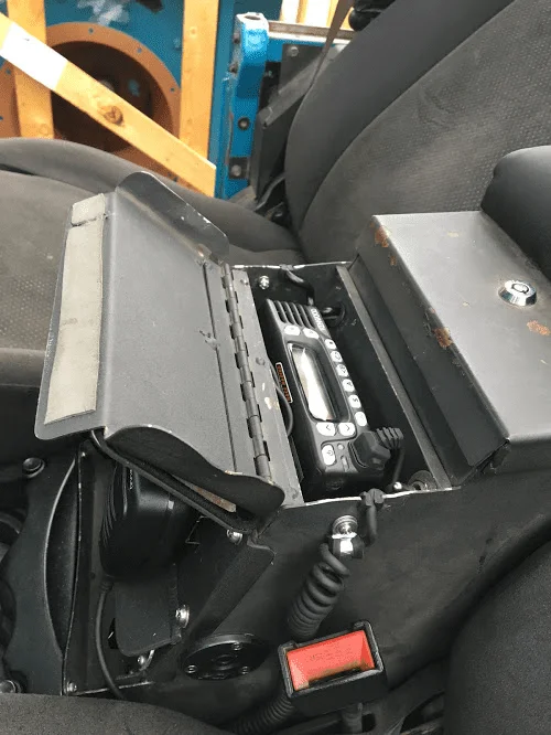

My solution:
I called up both PCI and Rugged Radios. They are both really awesome to deal with, but PCI won me over. They offer a USA made system that has stereo sound in the headsets (everyone else is mono), they are 20 mins away, and have a ton of stock in their warehouse. The put the stuff together in house, and were able to do a bunch of custom mods for me. Another great benefit was I was able to come over after the install and have them program/tune/ and do the final coax crimping for me and do some tests to make sure all is well. Very happy with the decision!

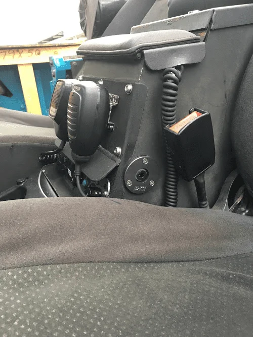

Here's where I ended up:
You can see the headset bulkhead mounts, one on each side. The controls and switches are located blow a plate that should block rain and prying eyes.
You can see the extra AUX cable that has a microphone pickup on it for when you don't want to use bluetooth.
Its all rain-resistant and theft resistant with tamper proof hardware, and all locks up in the center console.
I moved the CB into the console and put the PCI Kenwood in the old radio slot. I wired a toggle switch to disable one when the other is on to avoid any sort of back feeding through the antenna's as I ran them all pretty close together.
So far I have has it tested and all is well. The intercom is bad-ass, I called my mom yesterday while blasting down the freeway at 75-80mph and she said its the most clear conversation we have has in a long time. The music sounds great as well, I just need

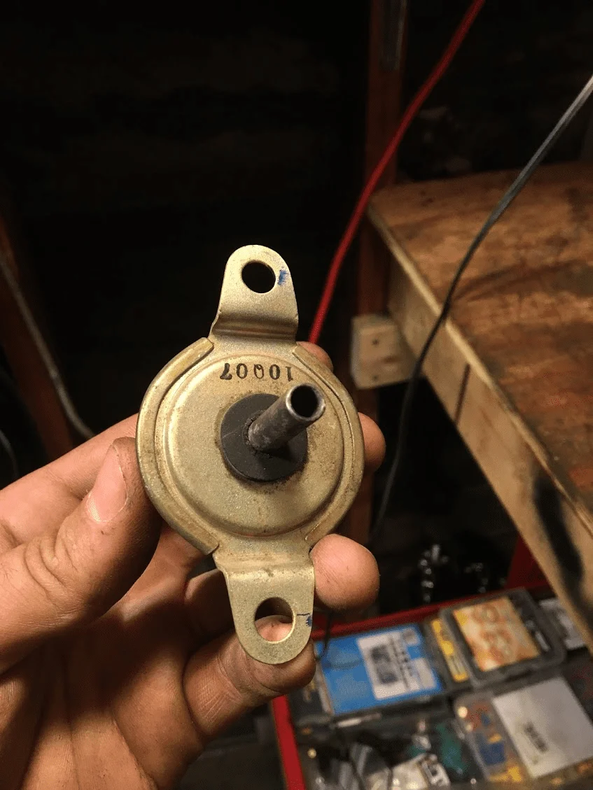

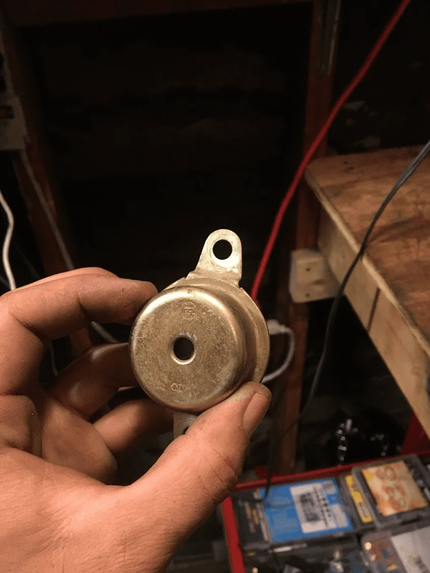

Can anyone tell me what this thing was:
I removed it to install that speaker in its place.
I'm really stumped by what it could have been for?
-Mike
