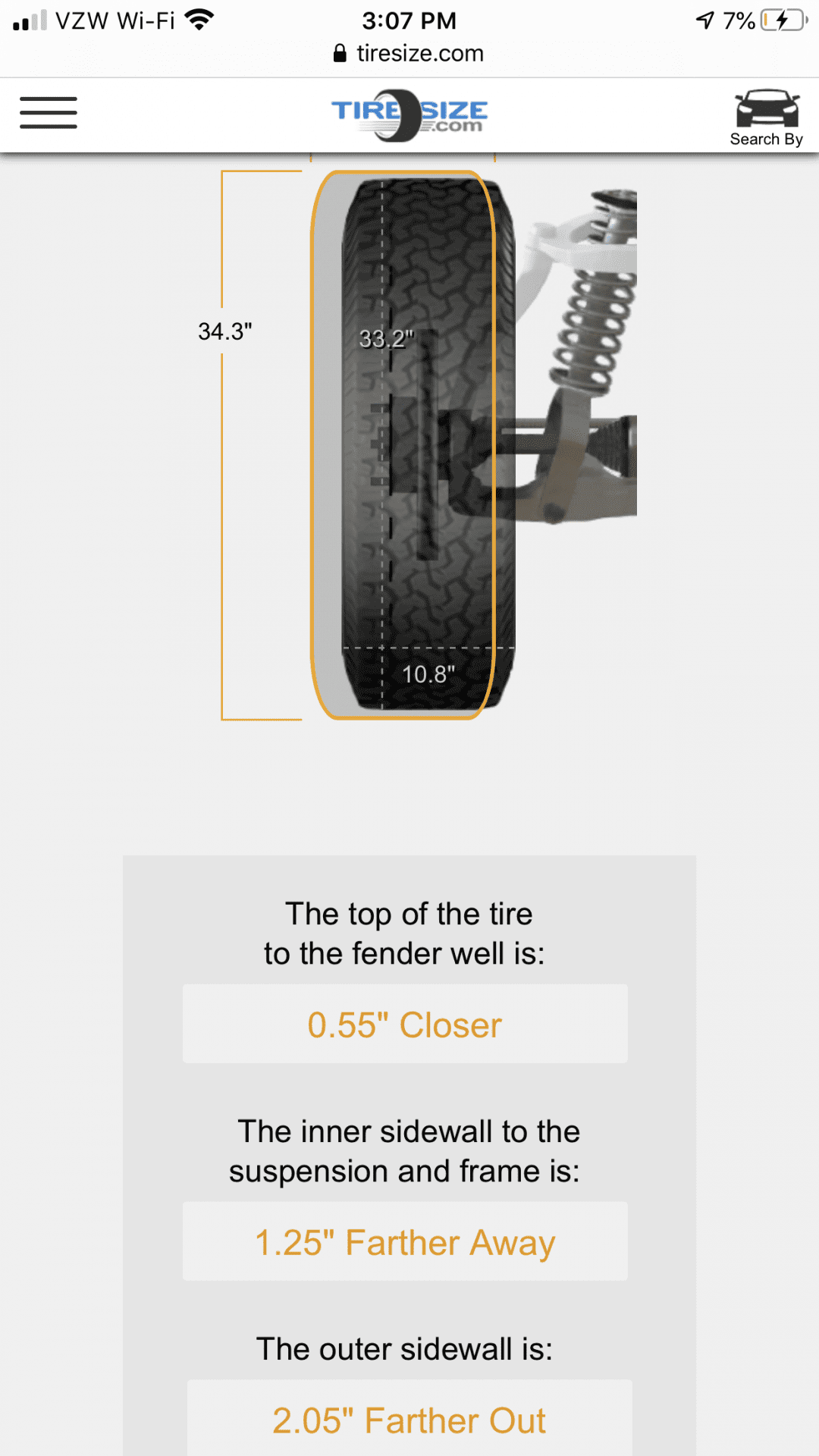

Alright so I’m pretty well set on method mr312’s in the 18” size. They are +18 so I used that offset calculator and here’s the output. I’m on Ironman foams all around with 2866 springs and factory tb’s. I think I’ll be cool obviously may need a pinch weld hammer here and there but nothing crazy. Gonna probably leave the center caps off and have the dust caps powdercoated and use black nuts

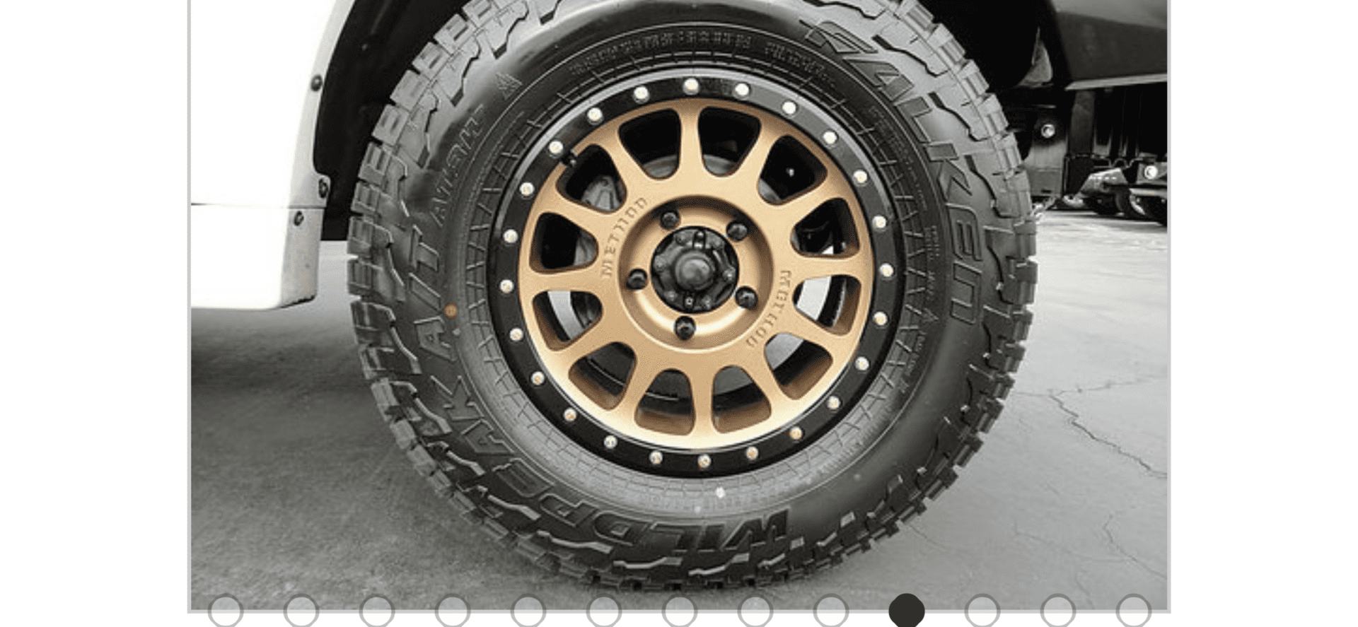

I have 275/70r18 ko2’s currently but I’m interested in potentially going to a 295/70r18 to close some of the wheel well gap and get some additional sidewall height. The falken At3w’s are super nicely priced at $250 but I really like the km3’s. Think the 80$ difference per tire is worth it. Or do I do 295/70r18 ko2’s

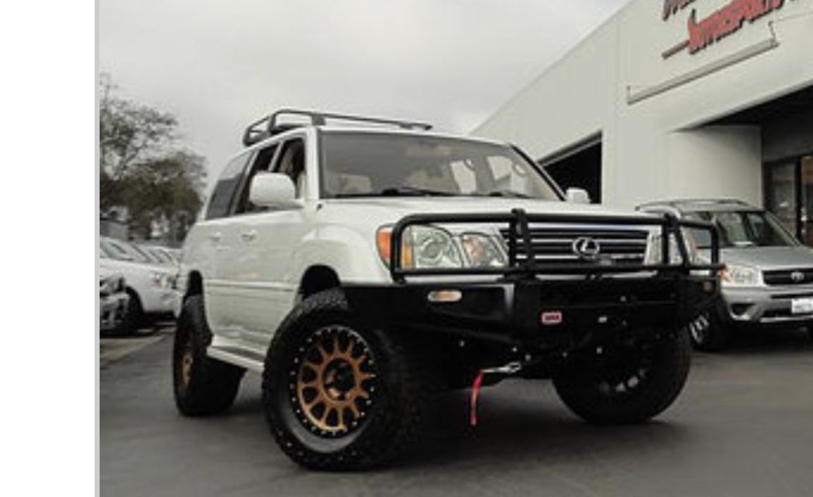

nice setup man! are these the method 304 double standard wheels? I was thinking of getting method 304 18x9 +18 offset on 295/70 r18 MT'S. You think i'll have an issue? What tire size you running?
That’s rub city ..try to get +30 offset wheels if you want to run 295.
I literally posted this setup 20-30 posts ago. This isnt one of those "go search" things, but all that info is in this thread, by me and others... you dont even have to search, just read through what others are running. I do not rub, but you will rub on the bumper if you dont have an aftermarket bumper. Obviously you need to do all the normal stuff necessary to run larger tires as well.
Not true, see above.

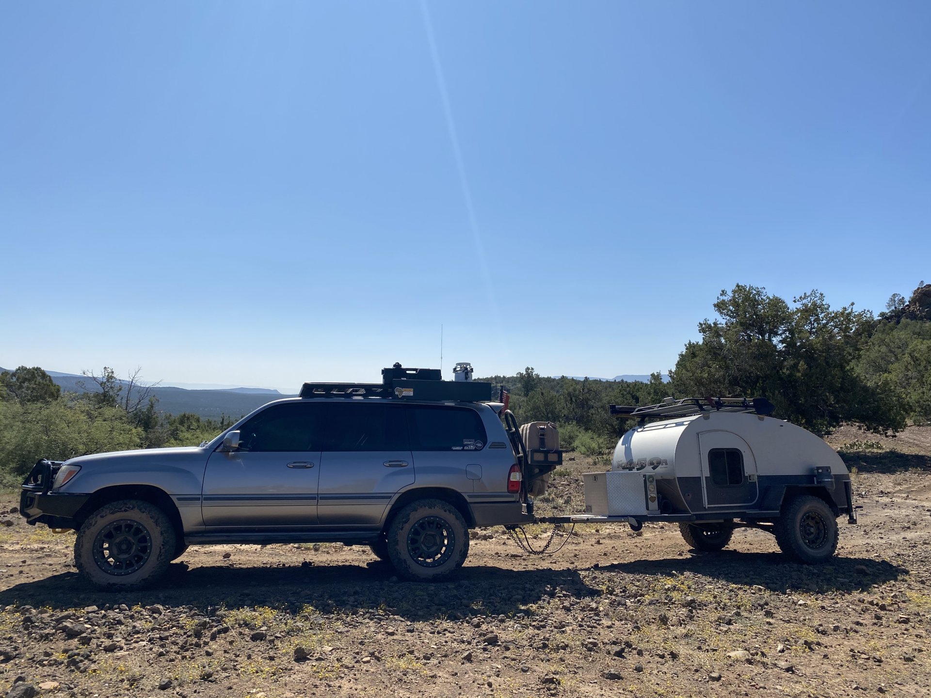

Old bump, but I was looking through the threads because I couldnt remember what offset I bought (LOL).
Heres how mine sits right now with 295/70/18s and +18 offset. How much it pokes out is back a couple pages. I am not into that bro look, just a nice, tough looking truck and for me it looks perfect. But I would have happily gone +25 if they were available as well.
