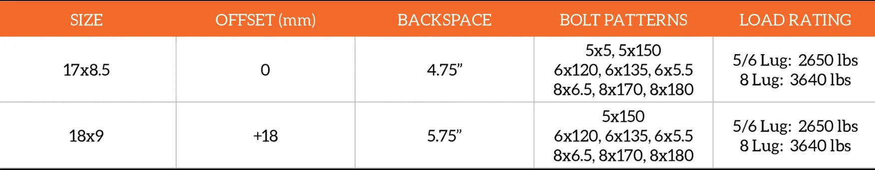

Looks like zero offset which is alot if you run a wide tire or a tire over 33". A +25 is perfect if you can get it. Not sure what is available.
Thanks, what about the 18?

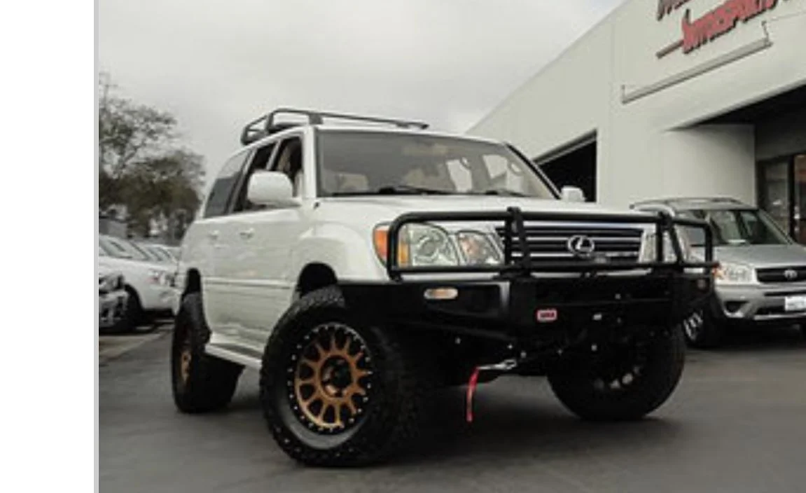

Old bump, but I was looking through the threads because I couldnt remember what offset I bought (LOL).

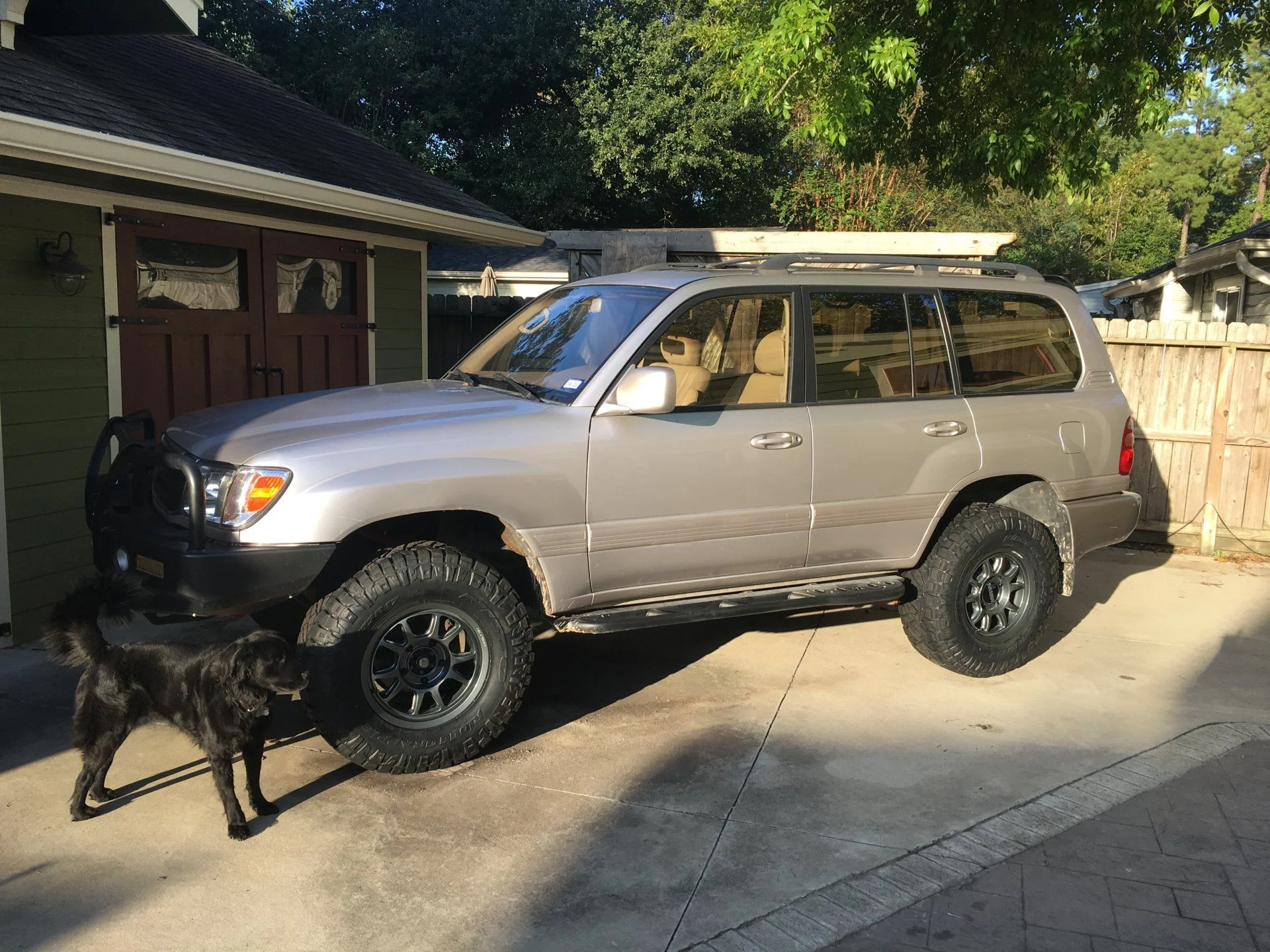

Heres how mine sits right now with 295/70/18s and +18 offset. How much it pokes out is back a couple pages. I am not into that bro look, just a nice, tough looking truck and for me it looks perfect. But I would have happily gone +25 if they were available as well.

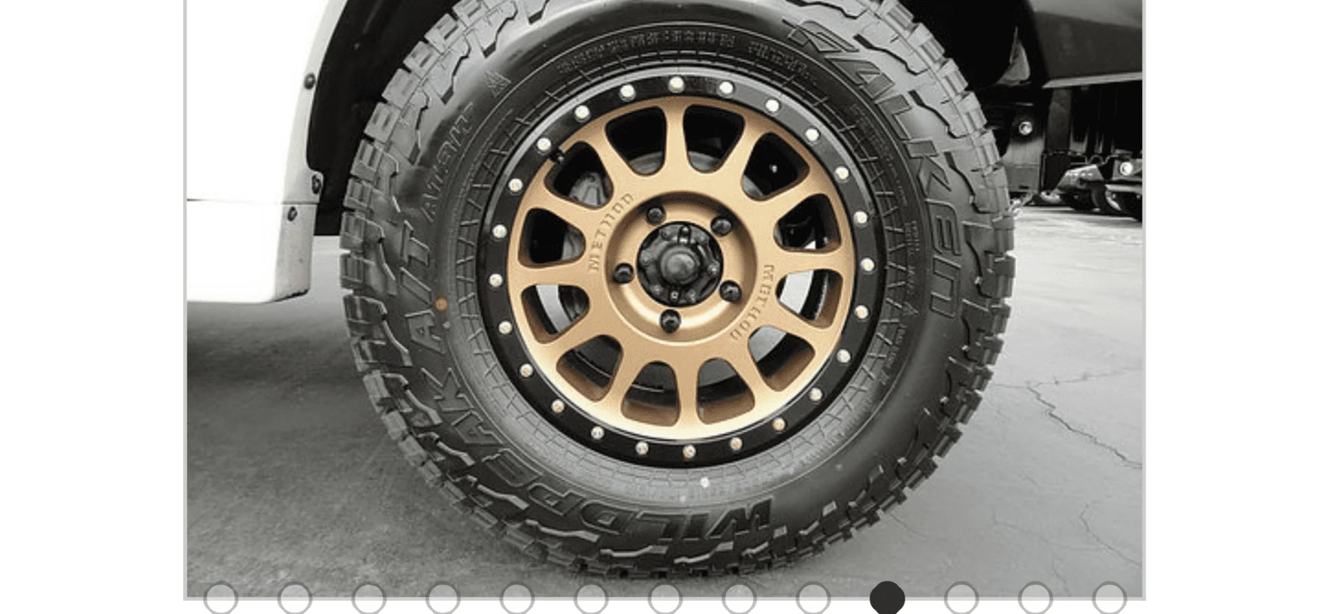

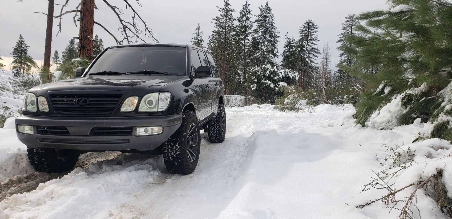

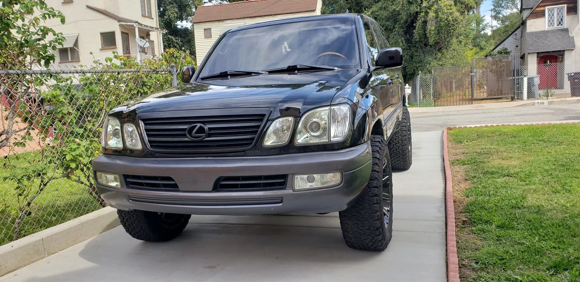

This what I got yesterday +18 not method but almost identical
@savirc Are those 17ins or 18ins?
Nice looking rig!
I really like the look of that bumper with that color!

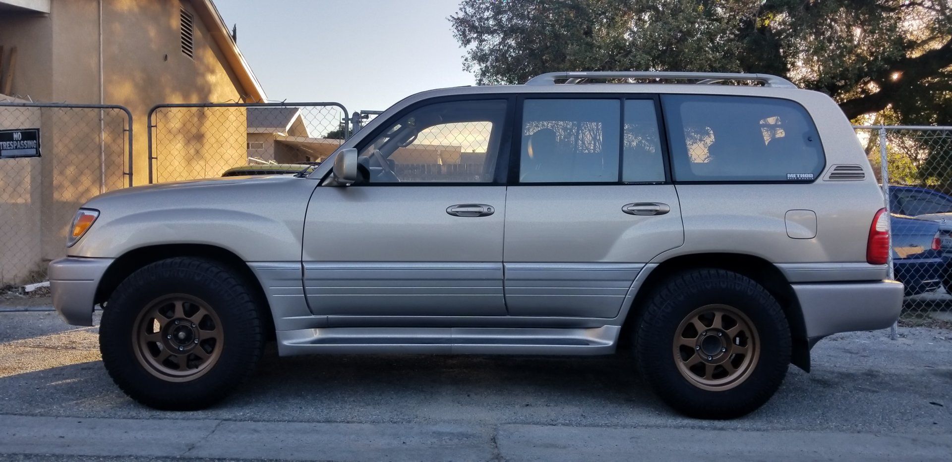

To me this perfect - great stance, quality components - very tasteful without being cookie cutter
