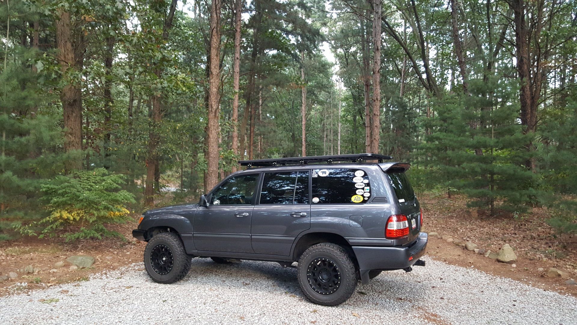

^^^ bunch of people are running method NV in 18s, myself included, +25 offset is perfect, flush with the fenders and don’t rub if you get the right size tires and/or lift.

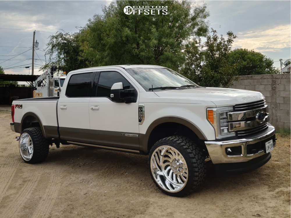

Negative offset, the mounting surface is inboard of the centerline. Think negative because it looks stupid. Some random truck at -73mm

That bottom truck looks way better. Sorry, bro.
