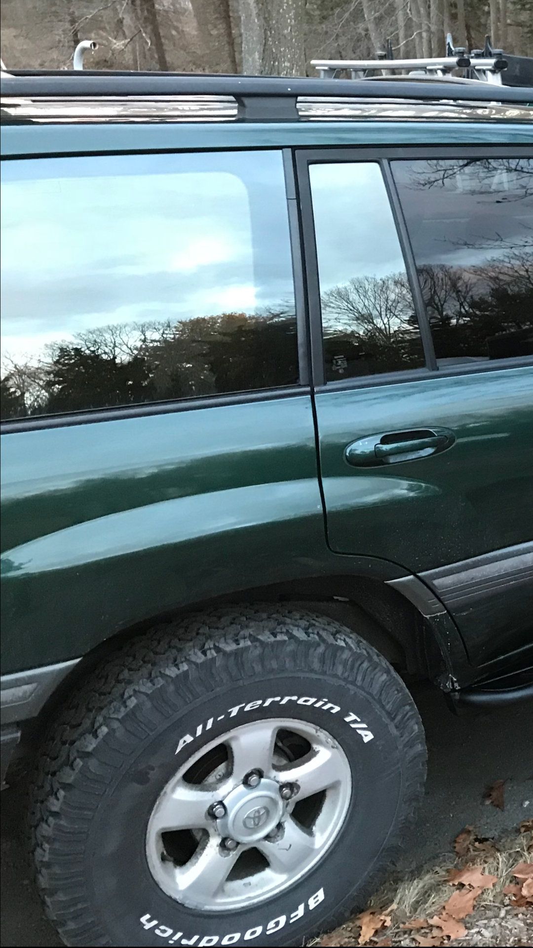

hey guys i want to buy some method NV rims and i was wondering if i can just keep my tires off my stock rims and then mount them on the new rims. my tires are good and i was just wondering what size the OEM RIMS ARE. thanks so much. what size do i need?
here is what i have
Methods for our vehicles are 18s, your running stocker 16s.

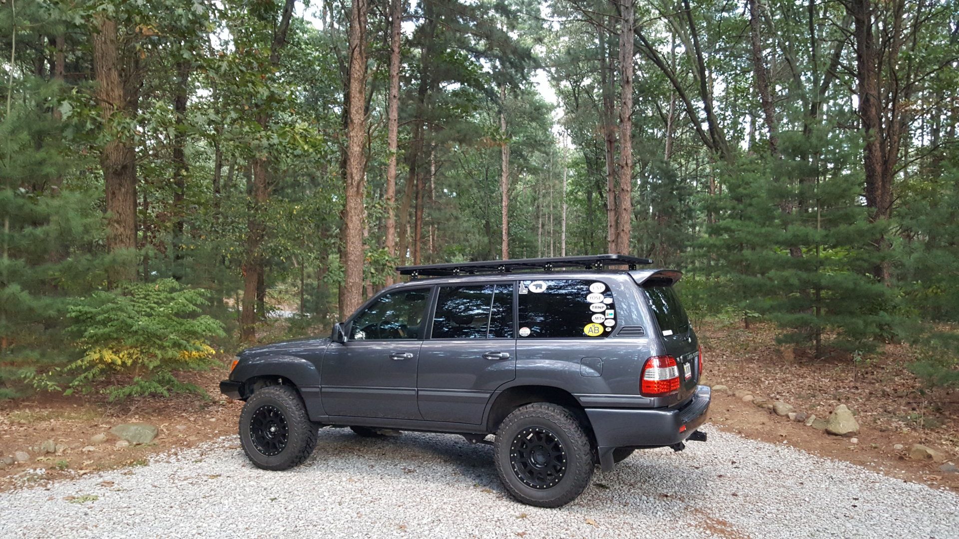

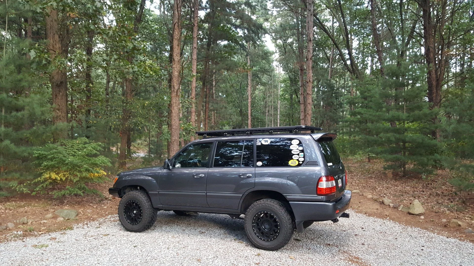

^^^ bunch of people are running method NV in 18s, myself included, +25 offset is perfect, flush with the fenders and don’t rub if you get the right size tires and/or lift.

Maybe not "perfect" but for available wheels and styles in a reasonable price range they work pretty good. I run 275/70-18 and get no rub anywhere. I suspect you would have to go up closer to a 35" or a 12.5" width to encounter issues with these +25 offset.
