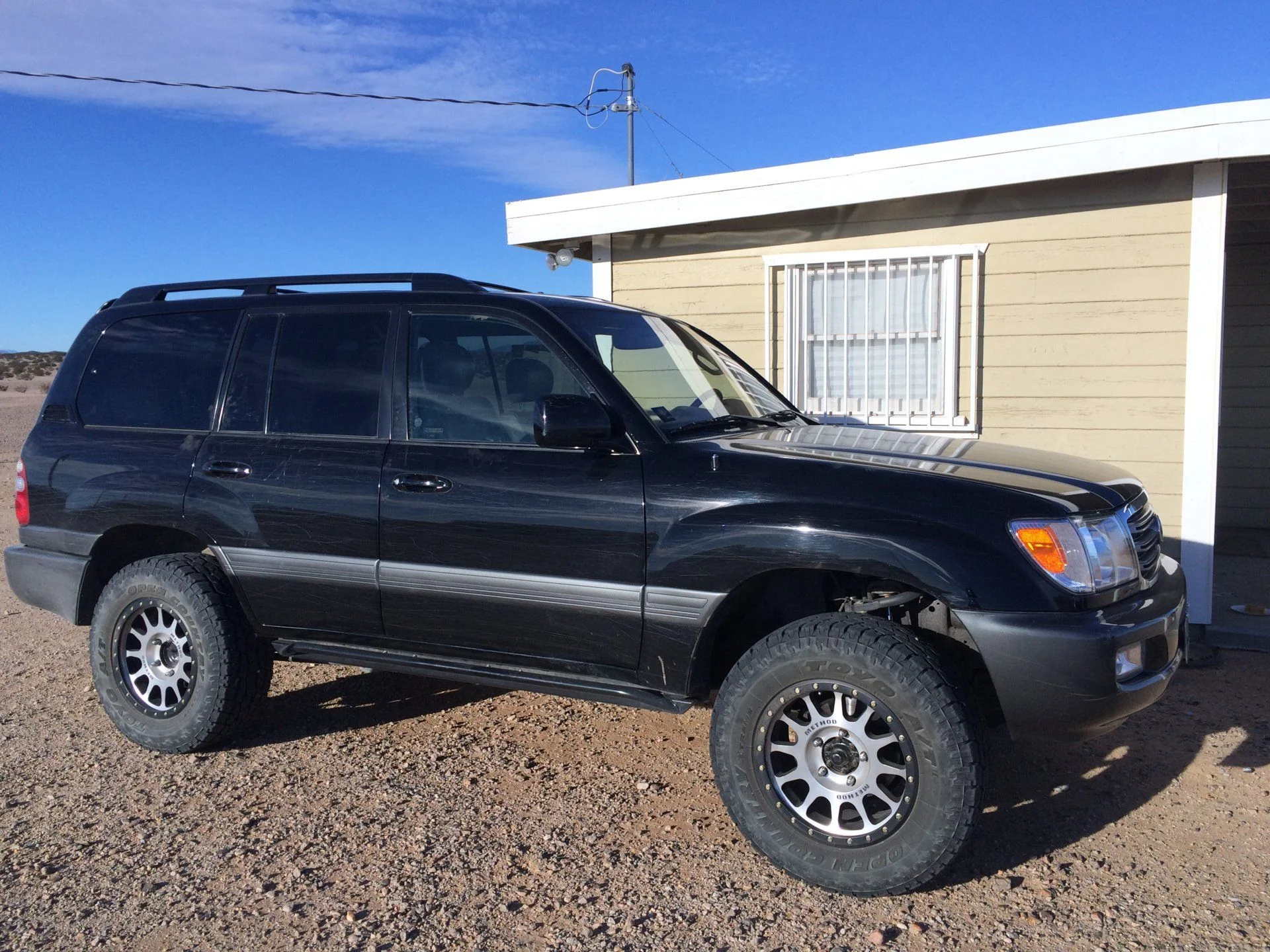

Here we go!
Method 18's with 18mm offset and 295/70/18 Cooper STT Pro's.
I am rubbing a tiny bit on the back side of the front wheel, but I have not gotten an alignment yet. However it is *not* on the pinch weld. Its on the small part of the floor (I am probably calling it the wrong thing) that runs from the outside of the truck to the pinch weld. I will make another post about this... I have researched it but I haven't seen anyone cut or bend this, so I want a second opinion before I do.
However...
I have SPC UCA's, so I am assuming if the alignment shop moves the wheel forward, this should be solved. However... this could cause some slight rub the from bumper, lol. I have a Dissent bumper that I am waiting on, so for me this is no big deal as it will be solved by the new bumper.
All in all... its a CLOSE fit. Keep in mind that the STT Pros are mud tires and have a higher overall diameter than most other 295/70/18's on the market (at least from my research).
My 100 series is the one vehicle I own that I never want to sell. And I am not a guy that is super concerned with stance in my vehicles. My RCF is on stock suspension and wheels, so is my Z3 Coupe. One of my M3's had coilovers and wheels, but it wasnt extreme at all. All this being said, even with the sliders and spacers, the truck still looked like a cross between an old man truck and a soccer mom SUV.... and the brown color doesnt help.
The wheels and stance have transformed the look of the truck. It looks a lot better than I thought and I am very happy with it. I cant wait to get the bumpers on now.
