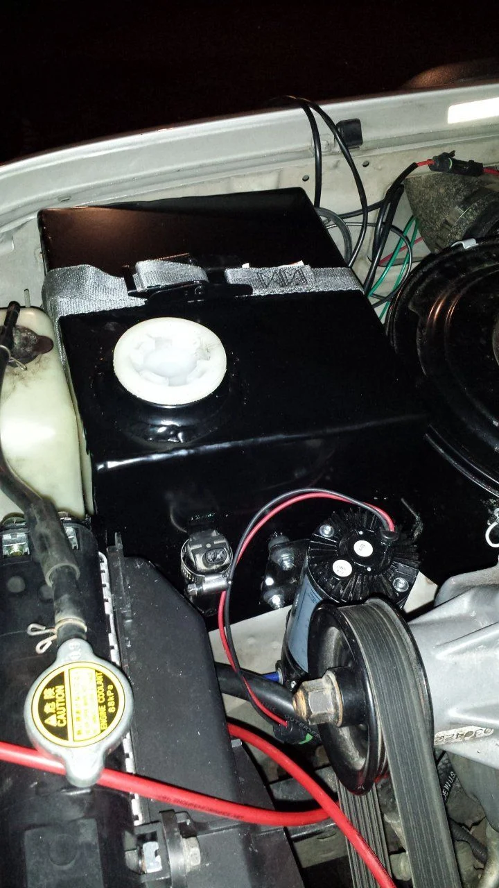

I don't want to deal with the 3 quart tank snow provides, so I'm building my own tank with pump mount. It holds 4 gallons
