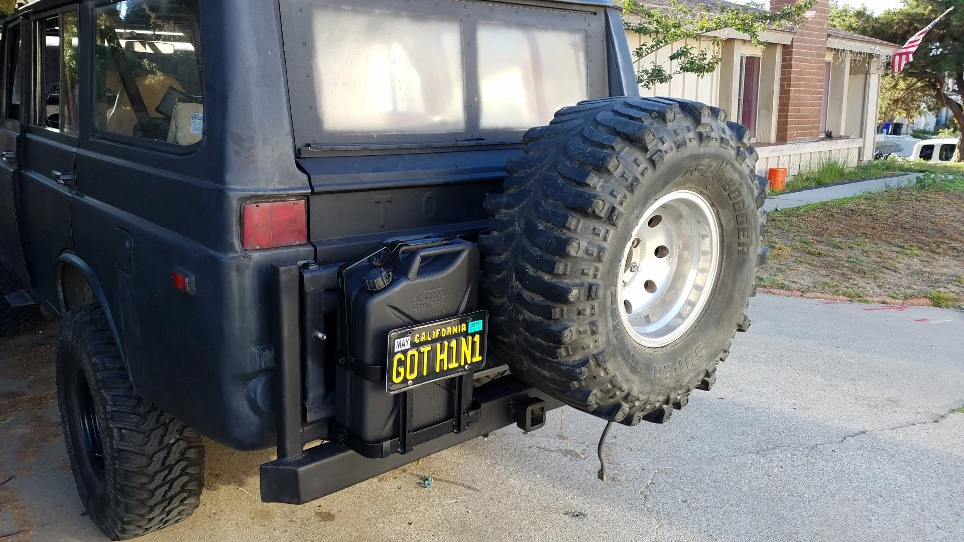

I changed my oil/filter, and tightened my exhaust. I got a second Jerry can and a holder for my swing out gate. I had to move the locking mechanism, which I never liked anyway.

I am mostly packed. Got all the camping gear in just need to figure out the clothes part. I made a jack mount in front. I'm not a fam of the jack being outside but it's a 60 in and I can't put it anywhere else.
Here is the gas can holder.

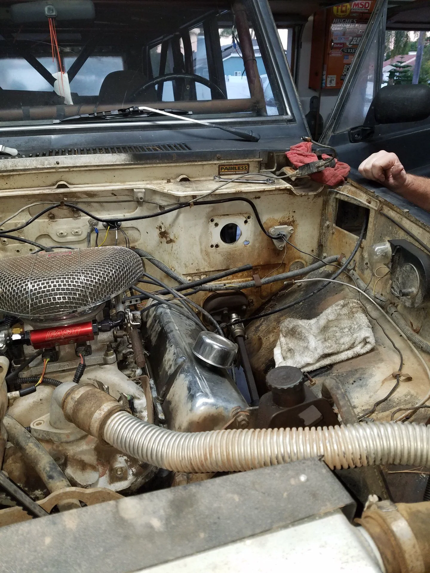

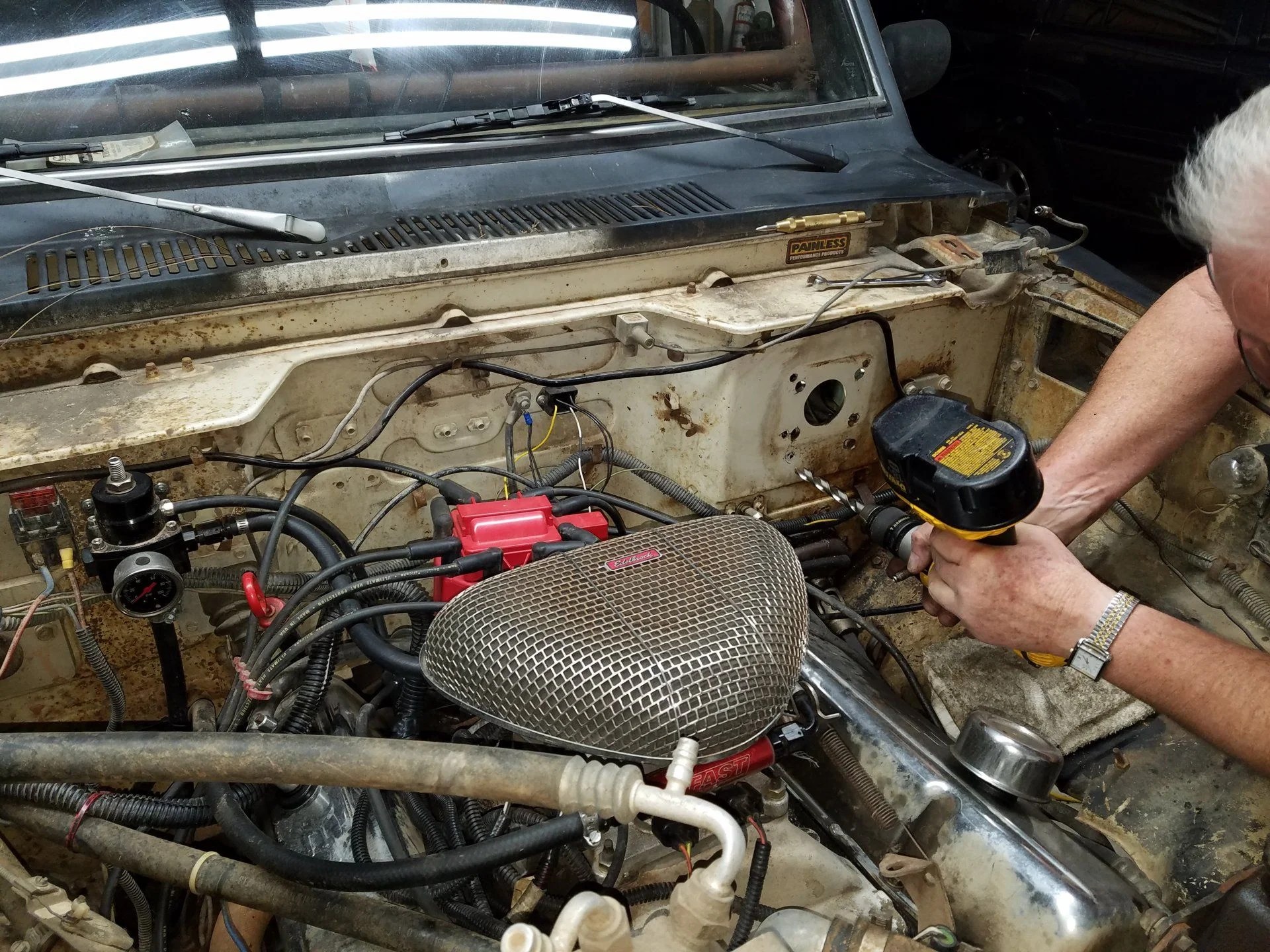

Got a descent start on the brakes.
You can see the original holes along with the added ones for the current booster.
Making yet more holes. I am going to fill the old this weekend.
We are going to cut the rod and tap it to receive the current clevis. It's 10mm 1.25 thread.

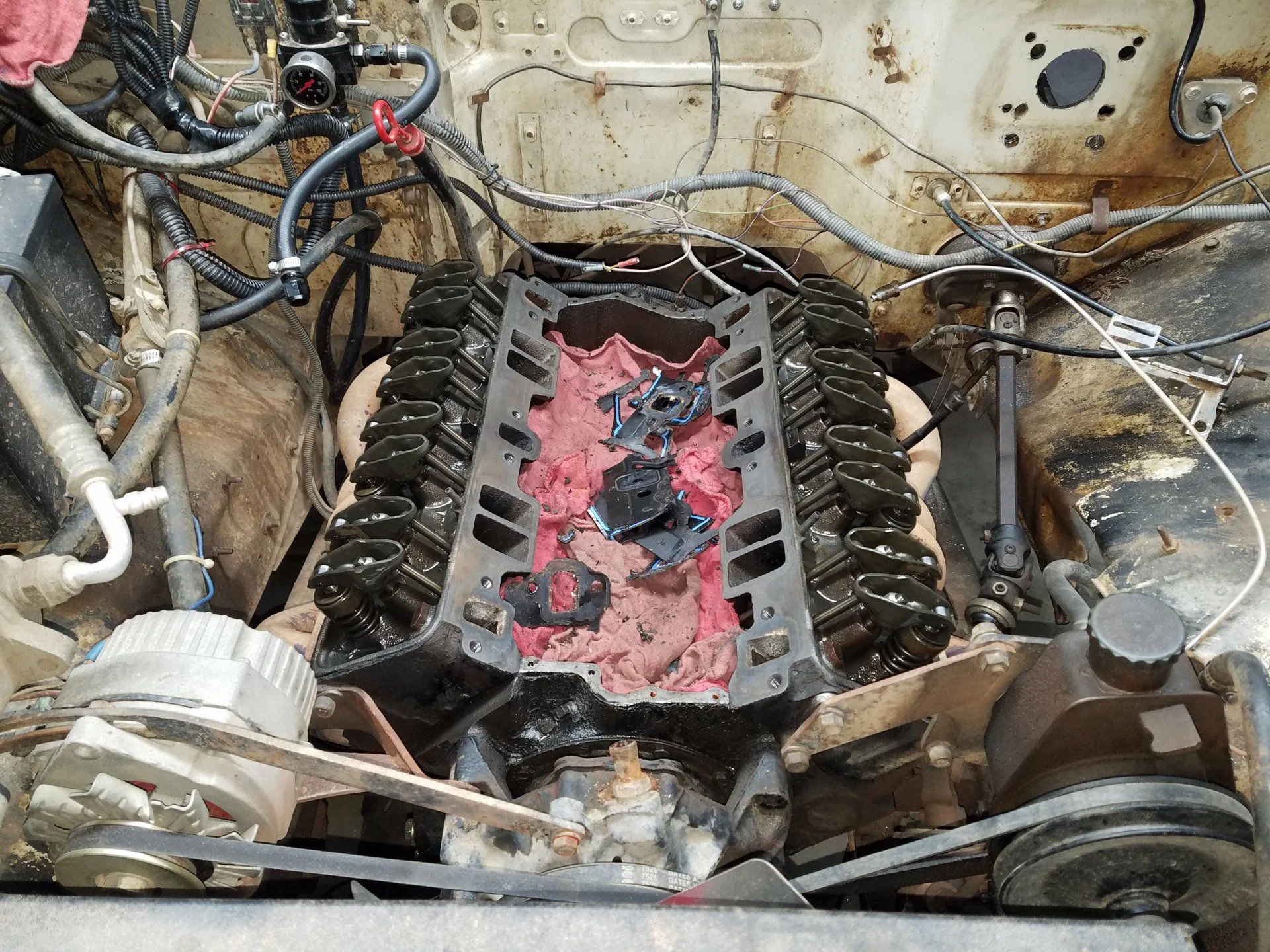

Since we had some time we needed to address the manifold leak. It was leaking oil out of the back pretty bad. There was also a leak in the middle driver side cylinders. Oil and air was getting sucked in to the head.
The heads and manifold were straight and everything looks toight.
There was a lot of sludge on the manifold and valve covers. Used to cans of brake cleaner. It doesn't look perfect but way better.
