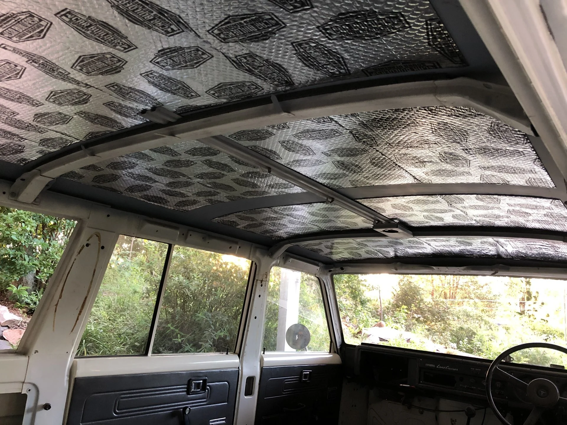

I know your pain on removing the old glue from the roof. I used a dynamat type product on the roof skin, followed by a 3M adhesive sound blanket type thing. The silver stuff made a significant differance in reducing the tin can effect.
