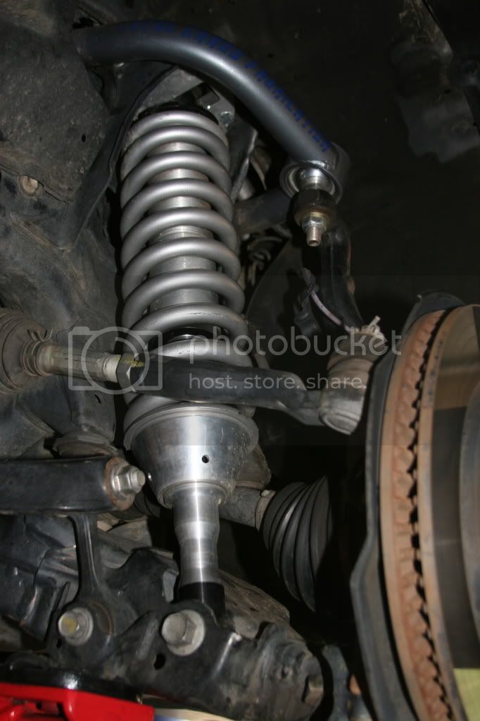

Instead, I am now thinking that the 2.5" Radflo coilovers in the front mixed with Radflo shocks and OME medium springs in the rear will be my best bet. I should be able to retain my OEM upper control arms for now, though eventually replacing them with the Total Chaos arms would give me a bit more downward travel. In total, this should provide approximately 3" of lift in the front and rear. Unfortunately, this setup cost twice as much as the OME, so I will have to wait a while before I can lay down an extra grand. :(
Here is a picture of the set-up I swiped from another thread.

Everyone who has the radflos on the 200 are extremely pleased with them. The OMEs are great, but everyone says that they do NOT drive like stock, and they are too stiff for everyday use. I can't comment on the 100s; just what I have been reading on 200s. YMMV. For what it's worth, the stock suspension needs improvement; I find that since already putting 2000 miles on it since I got it, I can say that driving on the Jackson roads are great, but at highway speeds, the ride is too soft. There's a little wheel hop, and bouncing at highway speeds. Adjustable coil overs seem like a necessity, especially because of the kind of driving I normally do. Again, I am commenting on the 200, not the 100.

I don't have anything against OME, and I had originally planned on buying a kit from Slee, but it looks like spending more money can get you a lot more performance, especially on-road, where it really matters (to me at least). I am not biased one way or another; just trying to get the best performance I can for the amount of money I want to spend. There are exceptions to every rule, but I have seen very little (if any) negative reviews of the Radflos in a 200, and have seen more than a few negative comments on OME 200 suspensions being too stiff for on-road every-day use.
