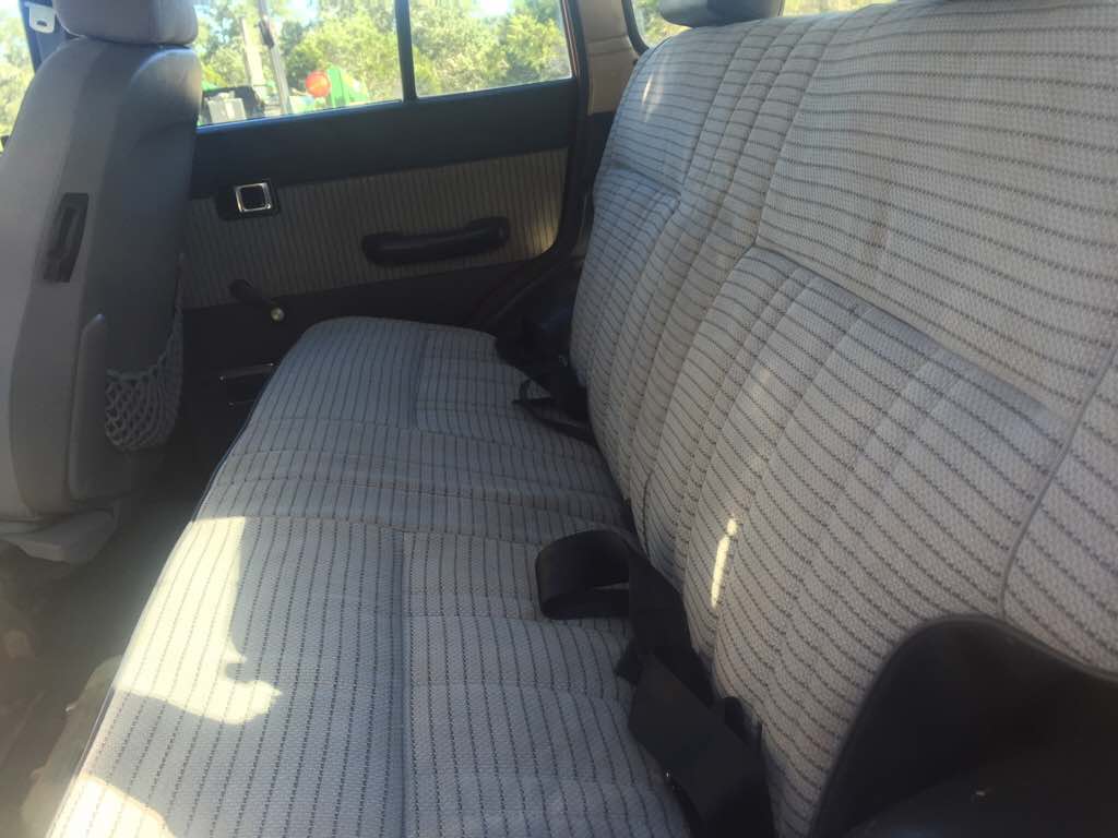

Switched out my rear seat covers for some original style ones that actually match my door panels:
