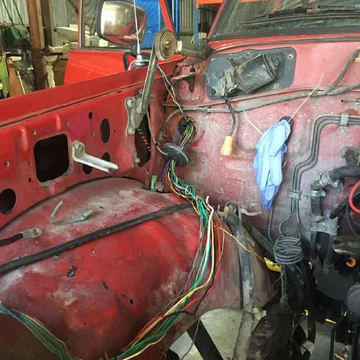

have you decided on a wiring system? 24 volt? 12volt conversion? split system?
I am converting the motor to 12V. Already have the alternator, starter, etc. The past few days I have been tackling the wiring (pulling the old emissions wiring out and splicing the diesel specific stuff in). It looks overwhelming but honestly I haven't had any problems thus far and I am a wiring newb.
