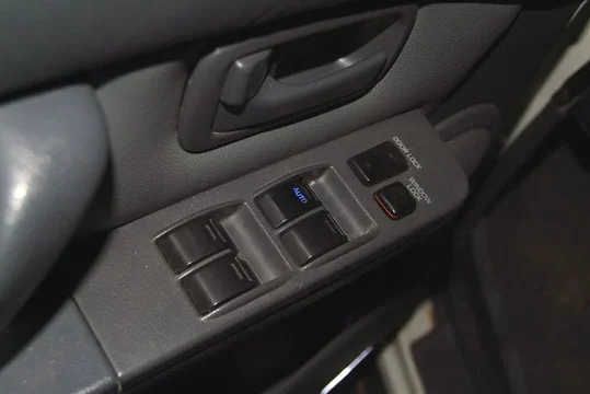

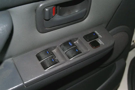

I swapped the 94 into my 95 and it works without issue. The only differences I can tell are some minor changes in the circuit board design and all the buttons light up in the 94 model. The auto up mod works on both even though the 94 style doesn't show the diode on the circuit board.
95
94

So how did you get the LEDs in all the buttons? :P
Technically... You could put a 94 in your 95-97 and it would light up. The only change is if you didn't want green
