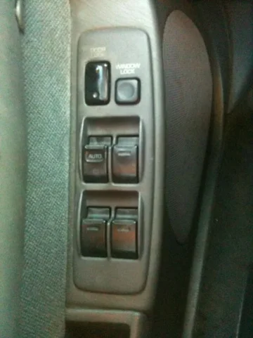

There is the master switch from my camry
typed badly on my iPhone using IH8MUD
Looks about the same from this view, wonder if they have the same mounting depths and functions? This one is out of a 96 80 and is missing the plastic rocker for the door lock switch.
There are two different switches.
84820-32150 91-94 and 84820-35010 95-97.
The 84820-32150 was also used in 89-94 Camrys.
The 84820-35010 was also used in 94-95 4Runners.
