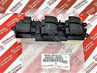

Can confirm the master window switches off some other 90s Toyota sedans are seemingly identical. I have a couple extras from the junkyard if anyone wants an OE replacement
Uh yea it’s already been detailed in this thread dude, but very nice of you. lol
Given how often I use it, I just bought a new one. I see little logic replacing old with old. My time and energy well worth the $140.
Amazing it’s still available.
84820-35010 for my 1997. Thanks, thread!
Ah nice. I’m surprised they’d only charge that little for shipping. In my experience it usually ends up being more. But still less than $160
