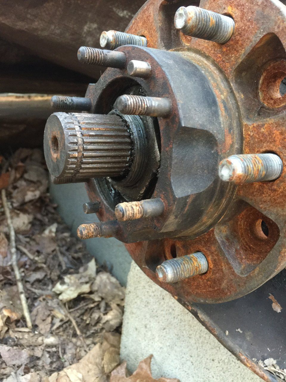

I am interested in the manual hubs for an 80 series axle as well, but for different reasons. My 80 axle is under my fj40 and I would like to have the locking hubs to keep the driveshaft from turning all the time. Is this a bolt on process or is there more to it than that?

The drive plate or flange on the hub is shorter in the earlier models to match up with the shorter CV joint. Take a look at the flanges to see if they both are the same part then take a photo of the flange and hub (no need to dismantle) and post it up.
I know you said no need to dismantle but they were already apart. I hope these are the pics you need.

Guys, this thread resurrection by NC40 starts at post #7, he is not trying to convert an 80 series to part-time, he has a 40 series with 80 series axles underneath. So he already has a part-time transfer case and just wants to install manual hubs on the 80 axles.
