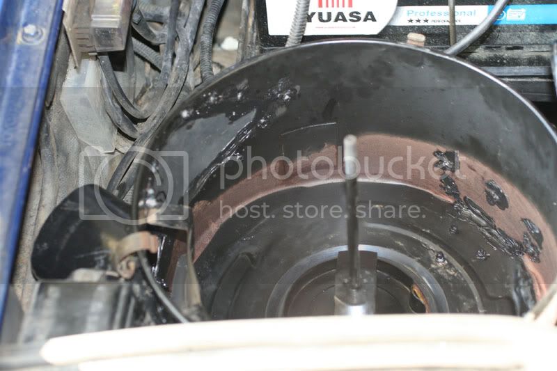

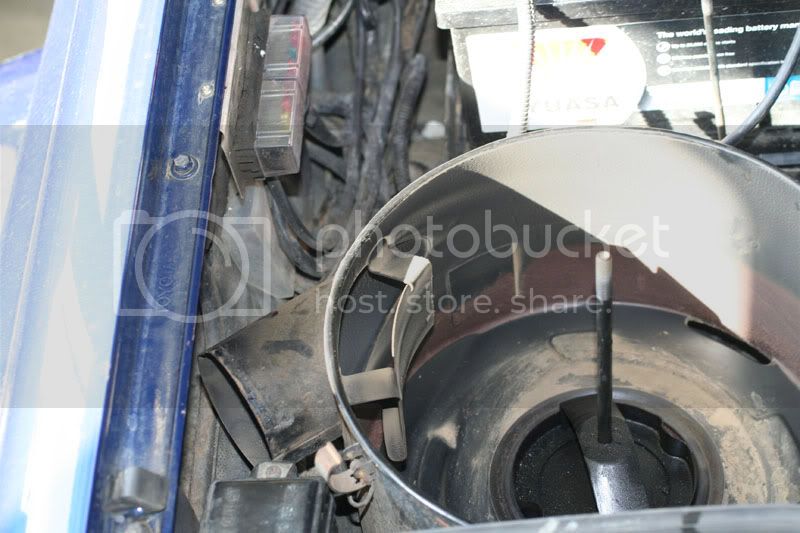

I friend of mine swapped air filter boxes with me so I go a stock one again.
But still I had to modify it ;)
The stock intake is facing forward. That does not sound right when you are having the air coming from the back.

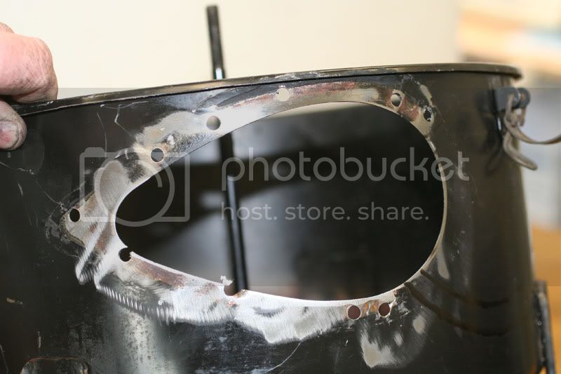

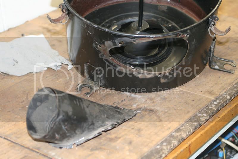

After drilling a few spot welds I had this.
Then I turned the intake pipe around, cut a new hold and used rivets to fasten it to the box, used a aluminum plate to close the old hole.
I also removed the "tuna can" and closed the holes.
Now my filter box looks like this.

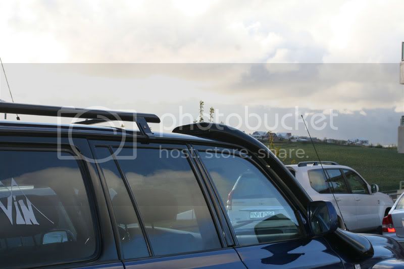

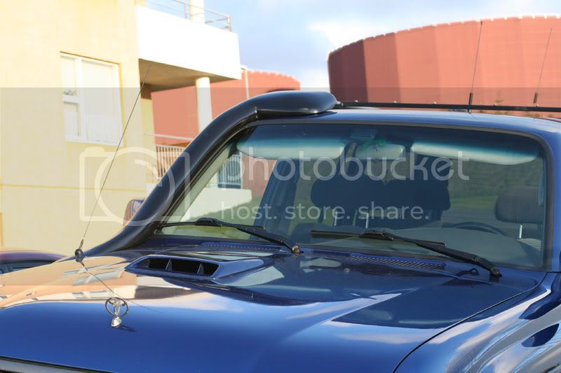

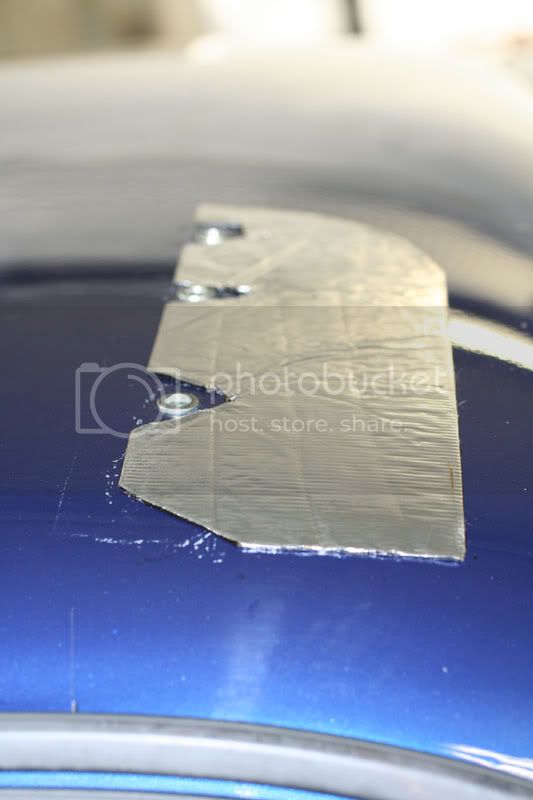

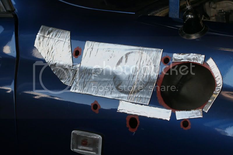

I glued some sound deadening material to the body where the snorkel sits to prevent it from scraping the paint causing rust problems.

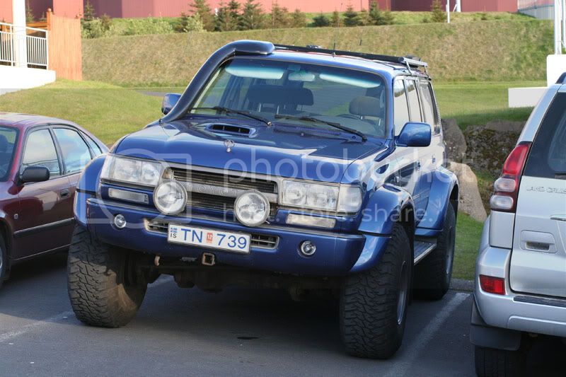

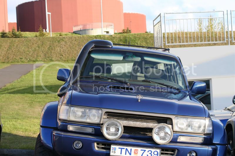

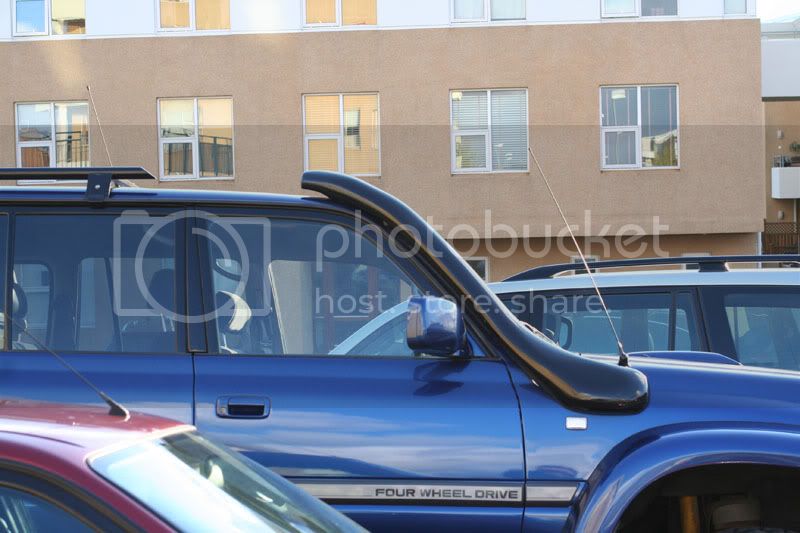

Then I installed the snorkel on the car. The paint job is far from being perfect but now I want to start using the car instead of being working on it all the time ;) so I will worry about the paint later.
I think it looks ok ;)
I haven´t connected it tho the intake just yet, I´m going to do some tests on it first and clean it out, it´s probably full of fiberglass dust from sanding it.

When looking at these pics I see some faults I will have to repair before I can say it is ready. There is an dent in the top of it, it is obvious when looking at the pic from the side. It also looks like the it should line better with the lines on the top of the windshield when looking at it from front of the truck.

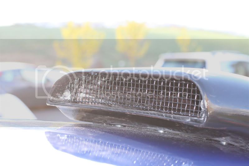

Looks different all right.
Can't help but think that the air passage looks a bit small, though. Ideally, you'd want that to be much bigger than the original parts given the extra length. Is that the case?
