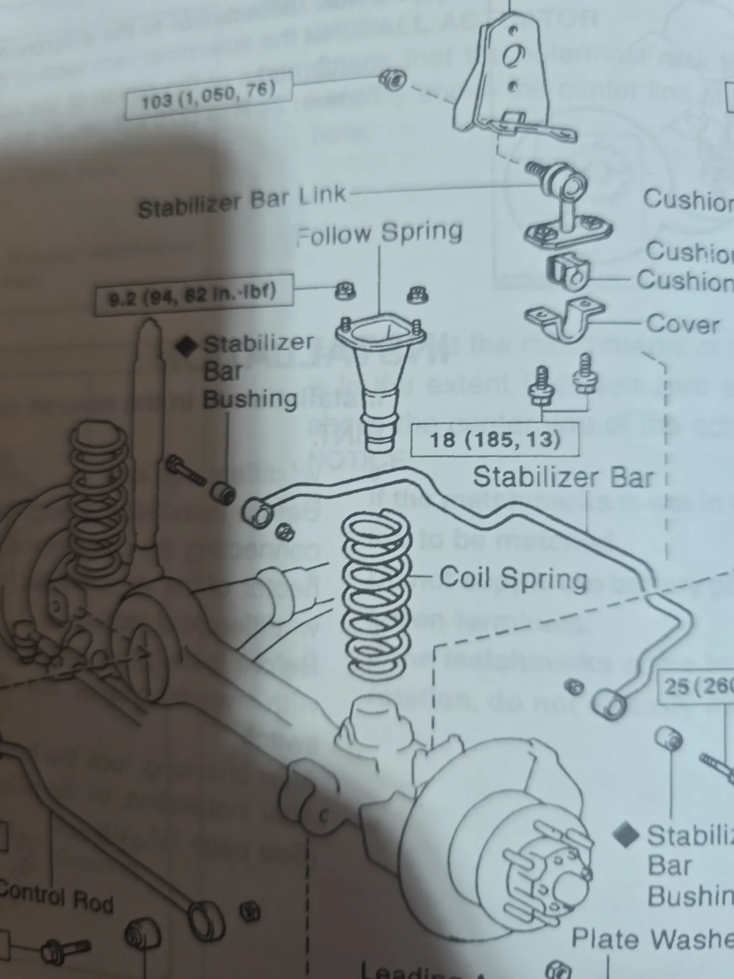

Just a quick sanity check for me, does the spring just ride on the "follow" spring. There isnt a spring isolator in the front?
Removed some spacers and the iron man lift springs and replacing with dobinsons, just wanted to double check.

Both times Ive done suspension work on mine there were no isolators in the front, just rear!

Awesome, I didnt see it in the FSM for the front but it just seemed odd lol. Thanks!
