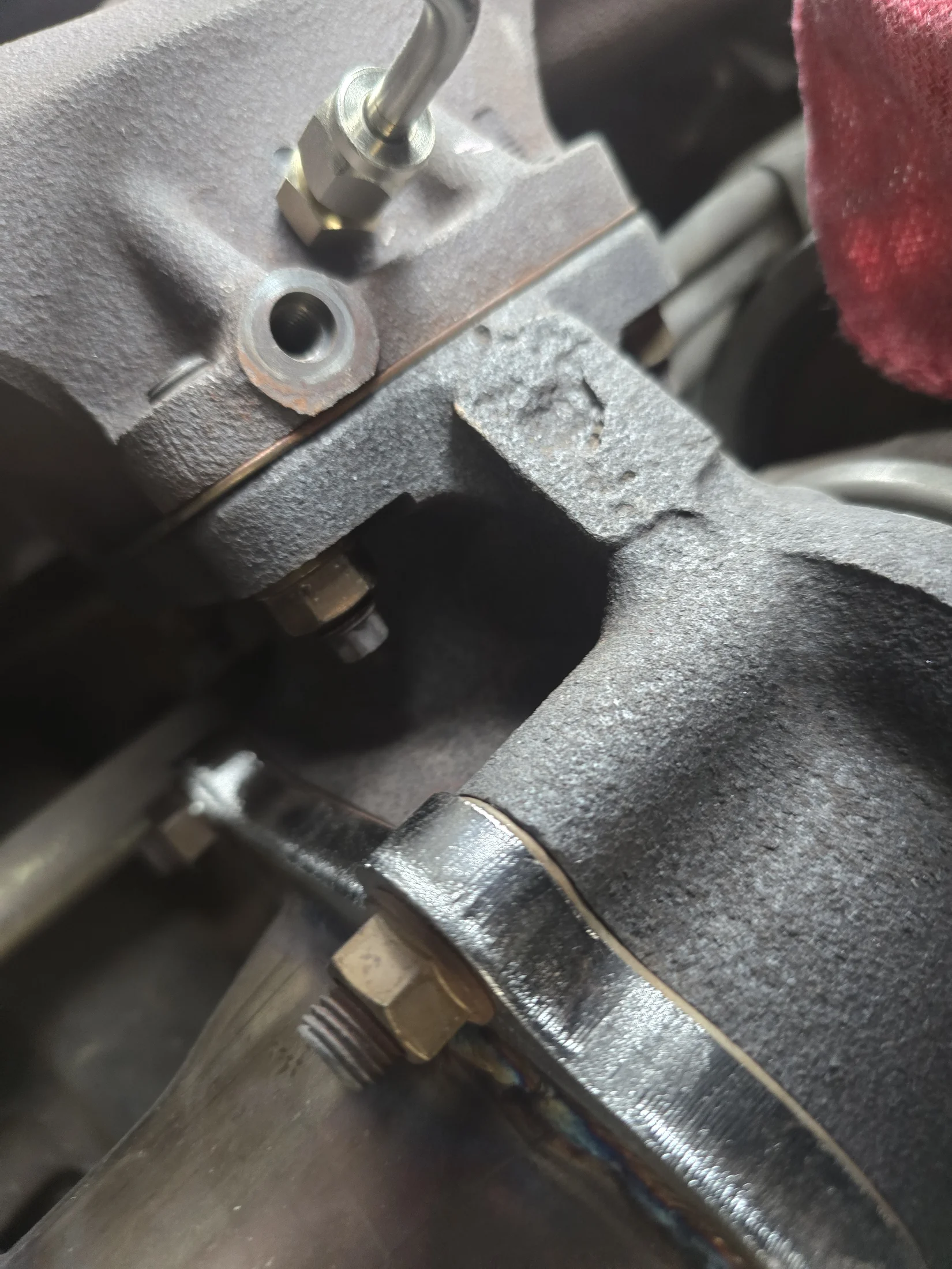

I also noticed two nuts completely backed off and a third was loose that bolt the turbo to the exhaust manifold. Tightened all those...
Then cruised around for bit.

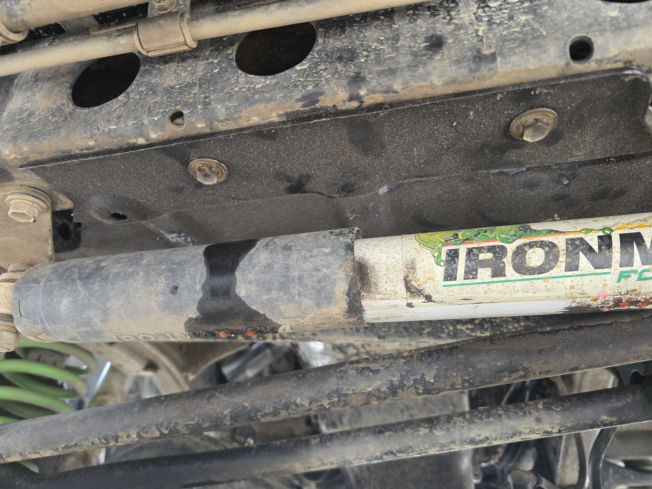

I really need to start looking into new lift springs and shocks. The Iron man lean is killing me.

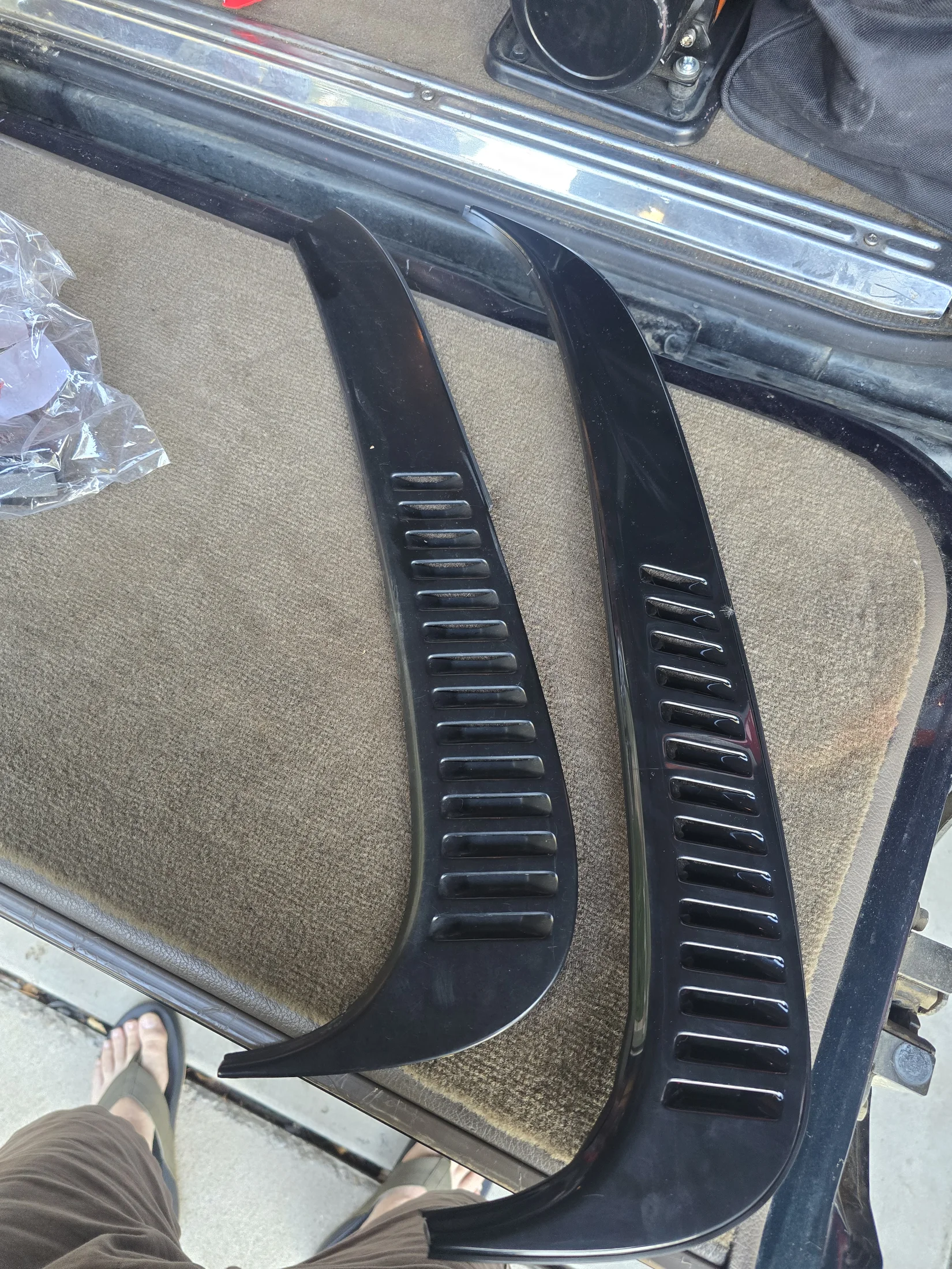

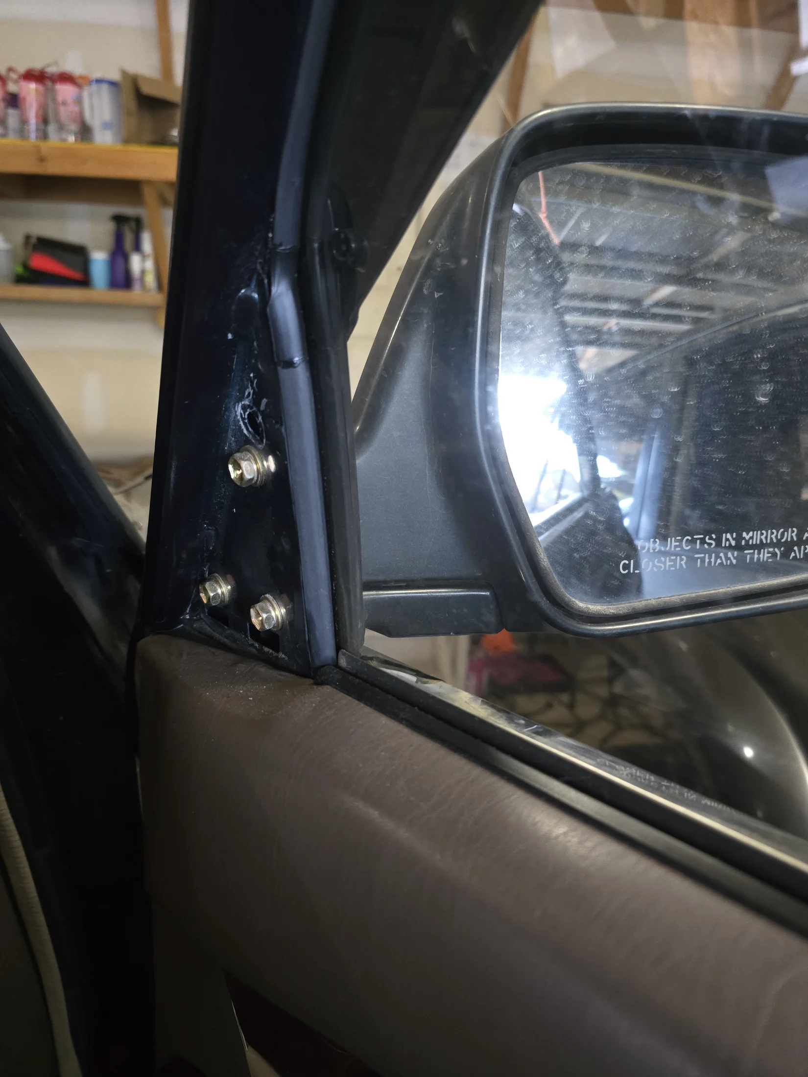

Continuing with the small stuff, trying everything is can to eliminate wind noise, especially since I like to cruise at 80mph. Lol.

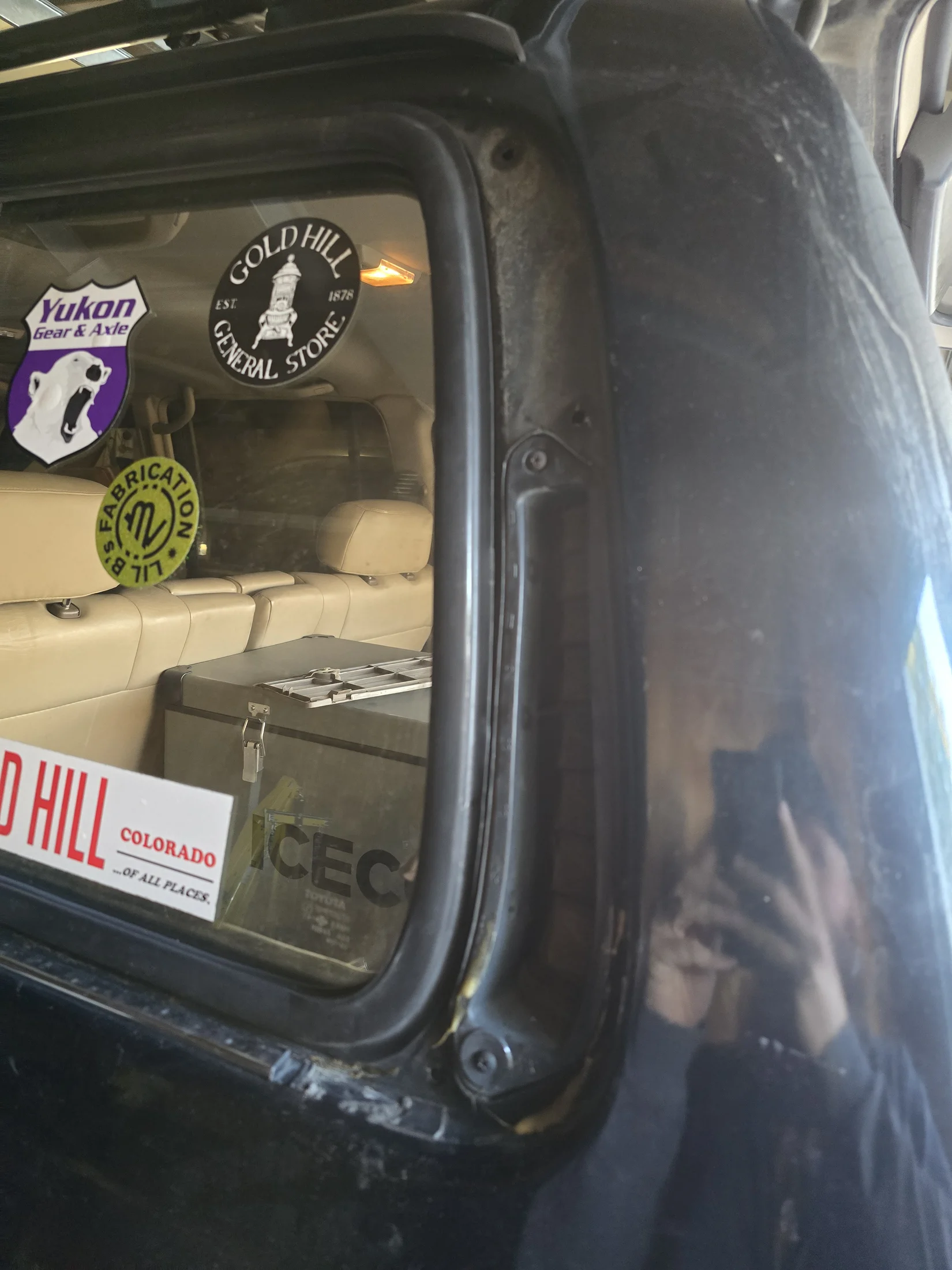

I got a new windshield rock chip on the way back from colorado a couple of week ago. Quite a few new rock chips on the paint though.
My wife wants to move back to colorado, but one thing I don't miss is having to annually replace windshields due to salt/sand blasting them to uselessness, or worse the rock chips ruining them.
I should probably look into sourcing a new seal soon, so I can be ready though.
I got mine from stevenson toyota west I believe. They have pretty good prices.
