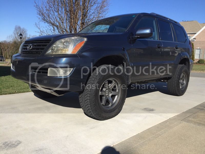

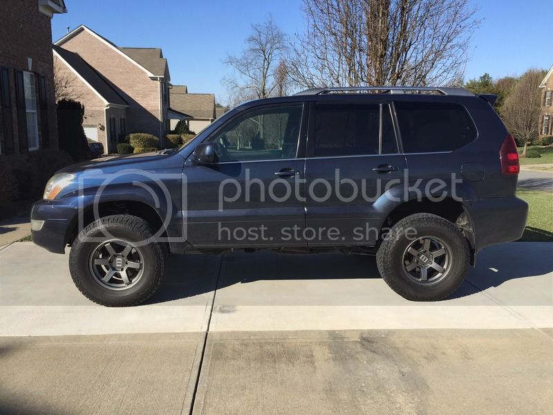

Is it the camera angle, or did the rear lift pull your axle forward closer to the doors? You running the stock control arms?
They are closer to the doors just by nature of the arc of the control arms, but the camera angle makes it look like much more than the minuscule amount it really moved. Stock control arms for now.

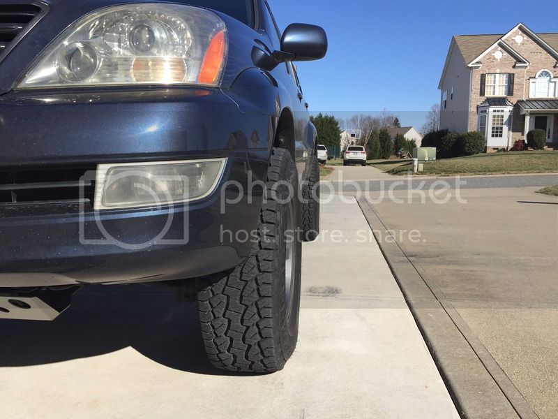

Added some new wheels to get the tires out of the wheel wells a bit.
Level 8 MK6 17x8 -10 offset.

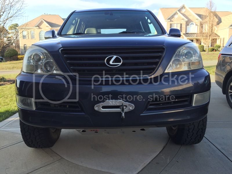

Mounted the winch today. Still need to finish the lower bash bar, but waiting on some more metal...
