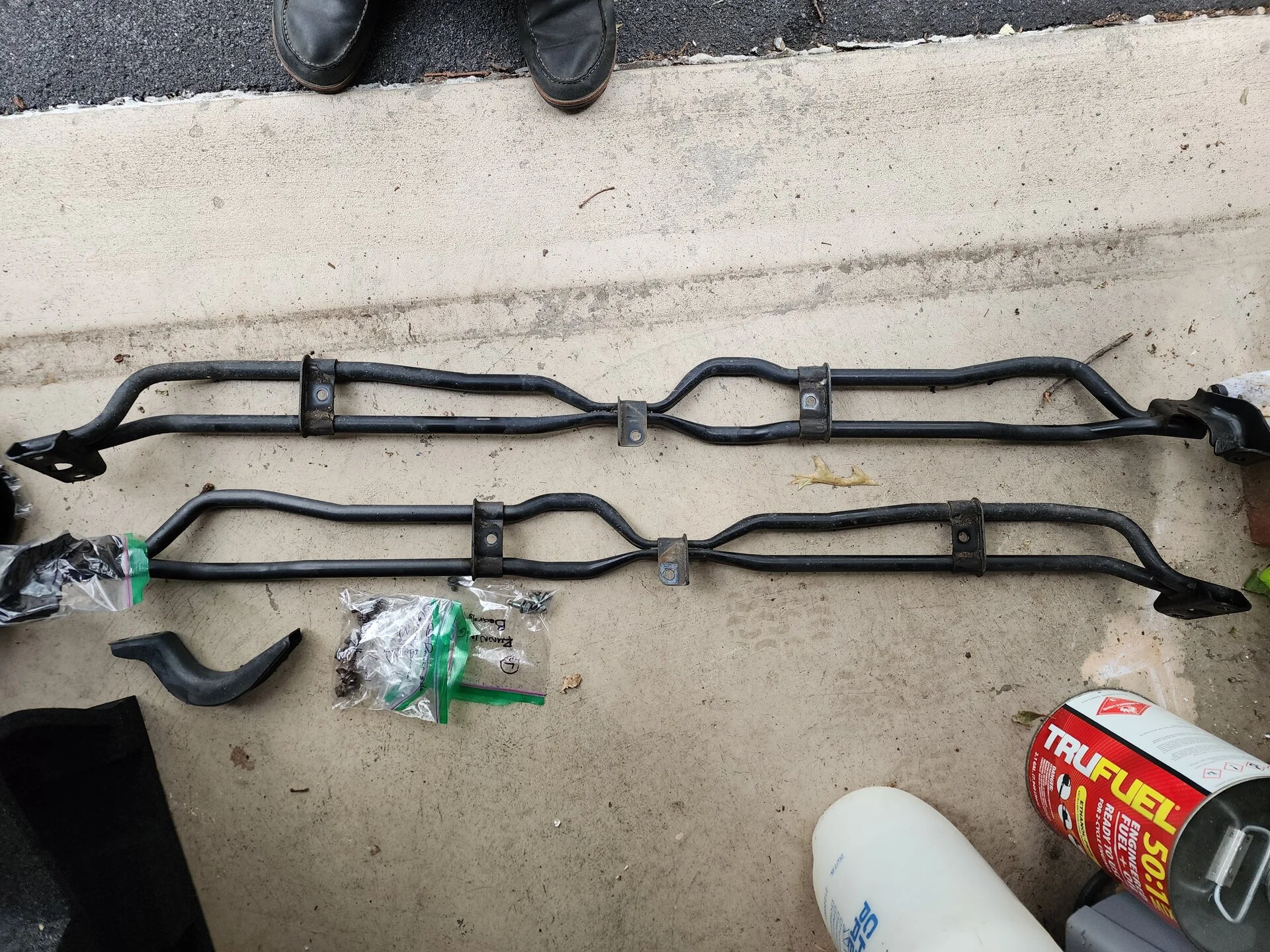

So I did mine this weekend tip #1 don’t mess with that back bolt on the rail guards, you can just bend it down and work around it. You’ll have to turn the globe sideways to put it in and rotate it but it looked easier than the hour I’d have spent trying to get that last bolt out.

The key is to remove the bracket from the running boards to access that pain in the butt bolt from the rail guard armor. Angled socket can be helpful as well. I would take them off so you don't take a risk of threading those globes at too much of an angle and strip the threads.

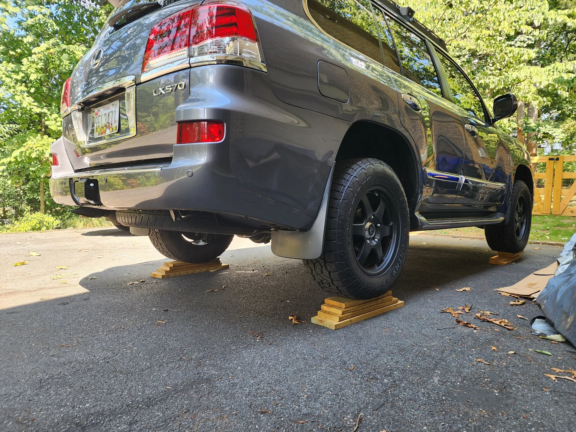

I drove mine up on wood blocks. Worked out well. Defintely remove that front running board bracket and fully remove the armor next time. Can't imagine doing it with rails in the way.

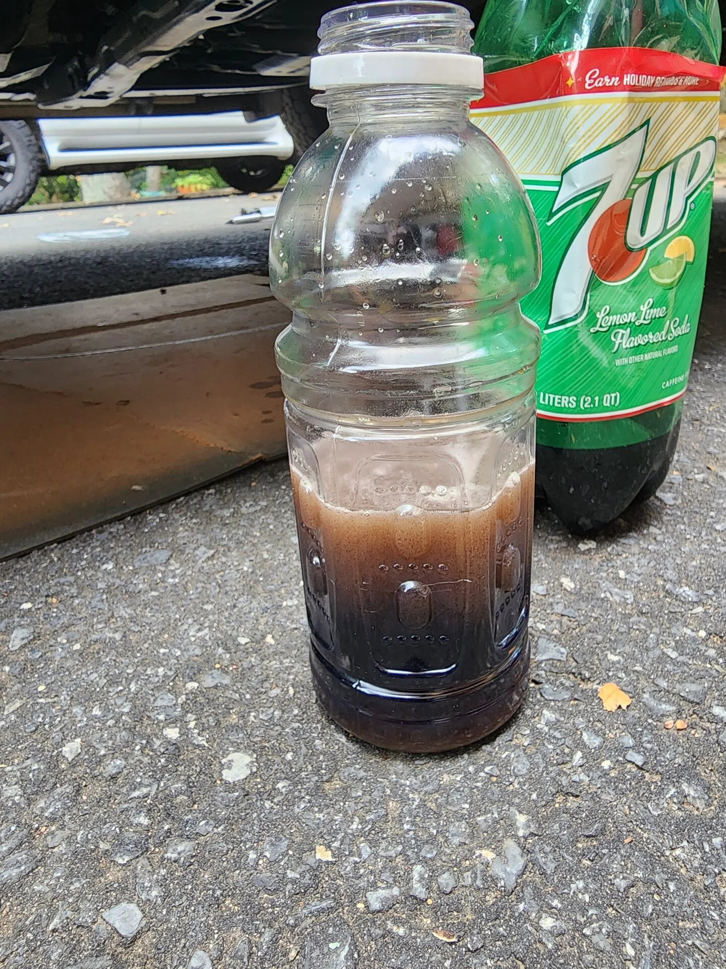

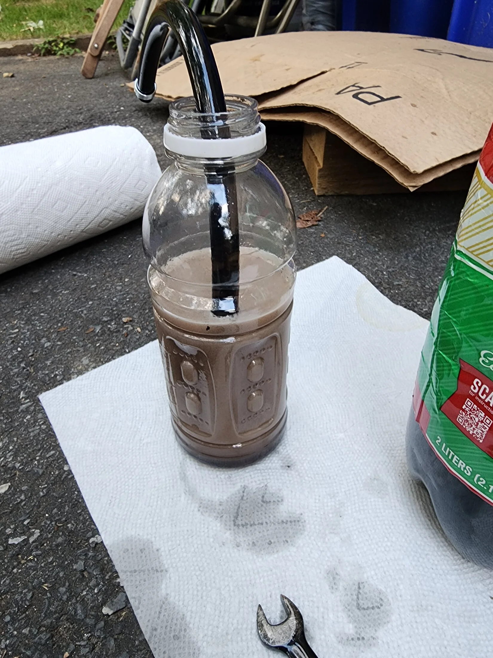

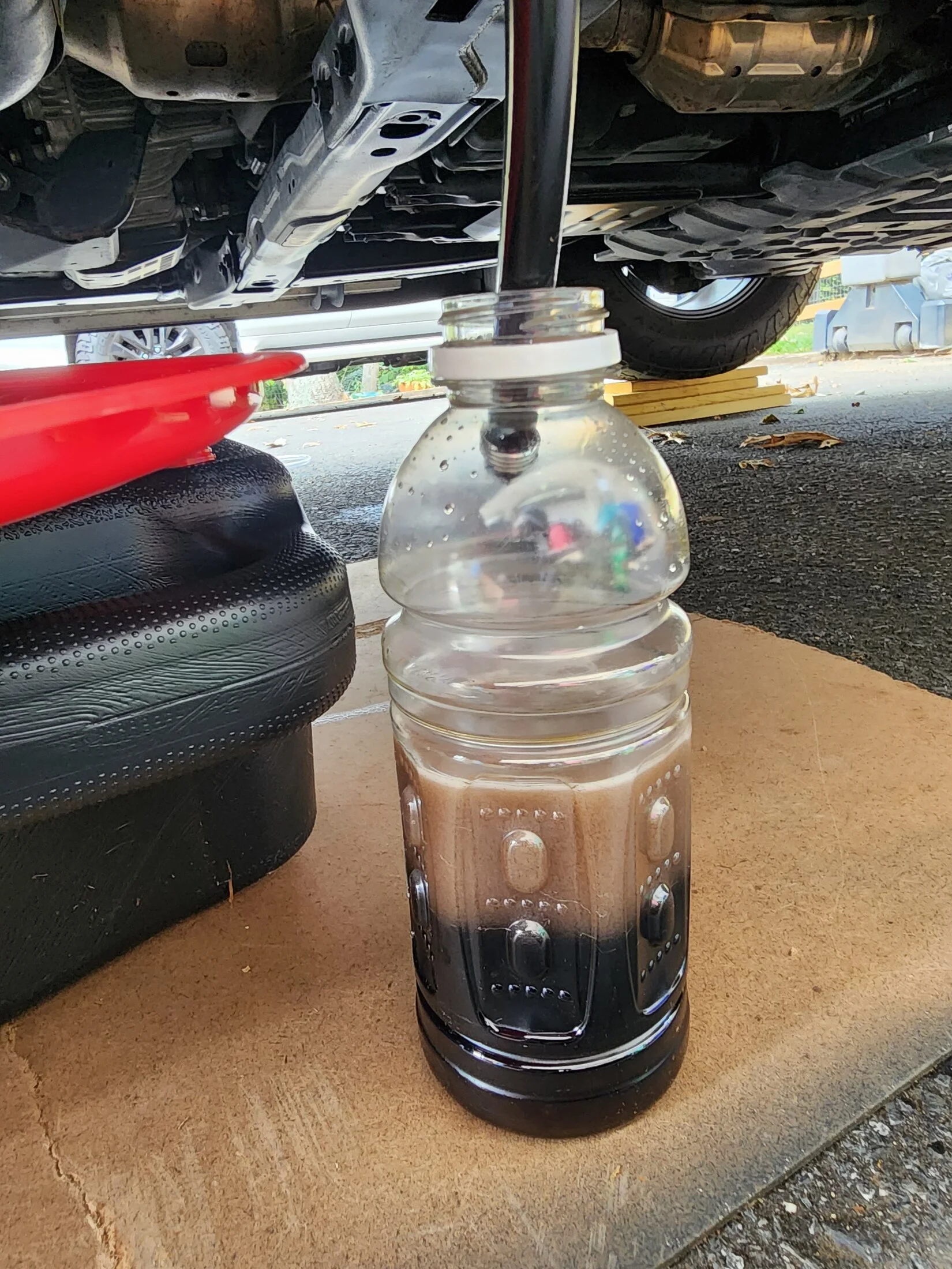

I replaced globes and bled the AHC system today. PB blaster and a breaker bar got my old globes off.
EDIT: I too found that a 13/16” socket had a much tighter fit on the heads of the globes than a 21mm.
I bled a few times. Looks like new fluid coming out now. Used almost two cans. Drove it around. Feels more responsive. Might go ahead and bleed again if it acts like there’s air somewhere in the system. I still have an unopened can.

Good call. I think you did the right thing. I would error on the side of bleeding those lines and adding additional fluid if you have it. I got a vacuum lock and had to get creative during the process. Within the lines, at 89,000 miles, were chocolate milk AHC fluid. Which is indicative of air. Mine was a process getting to red AHC fluid. It took forever!

IMO. Dont blow off bleeding the 5th.

Wow. Mine looks like your second pic but not as dark.
