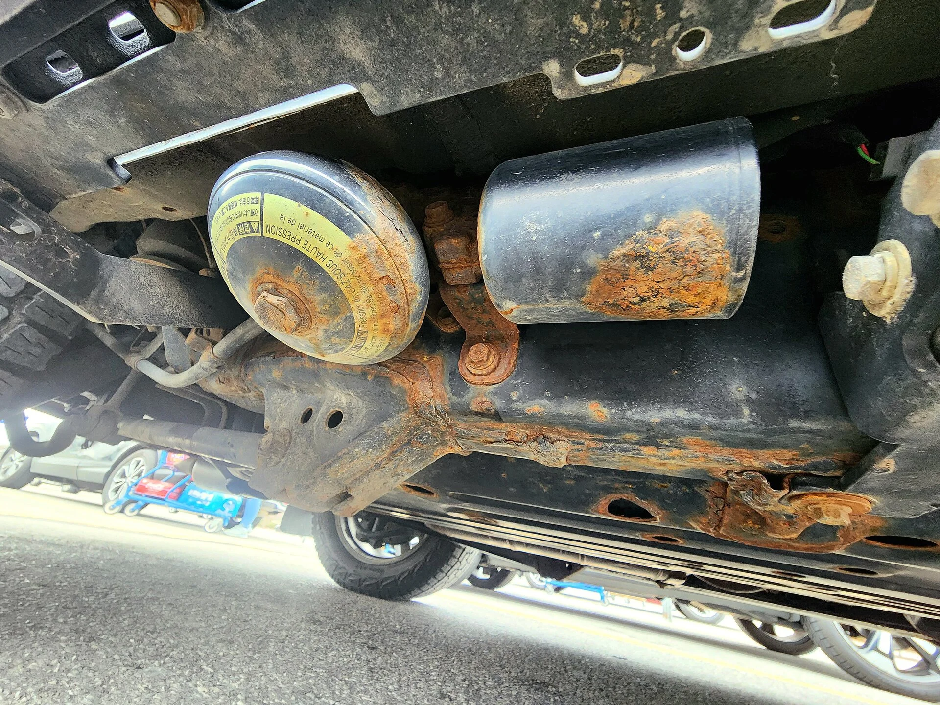

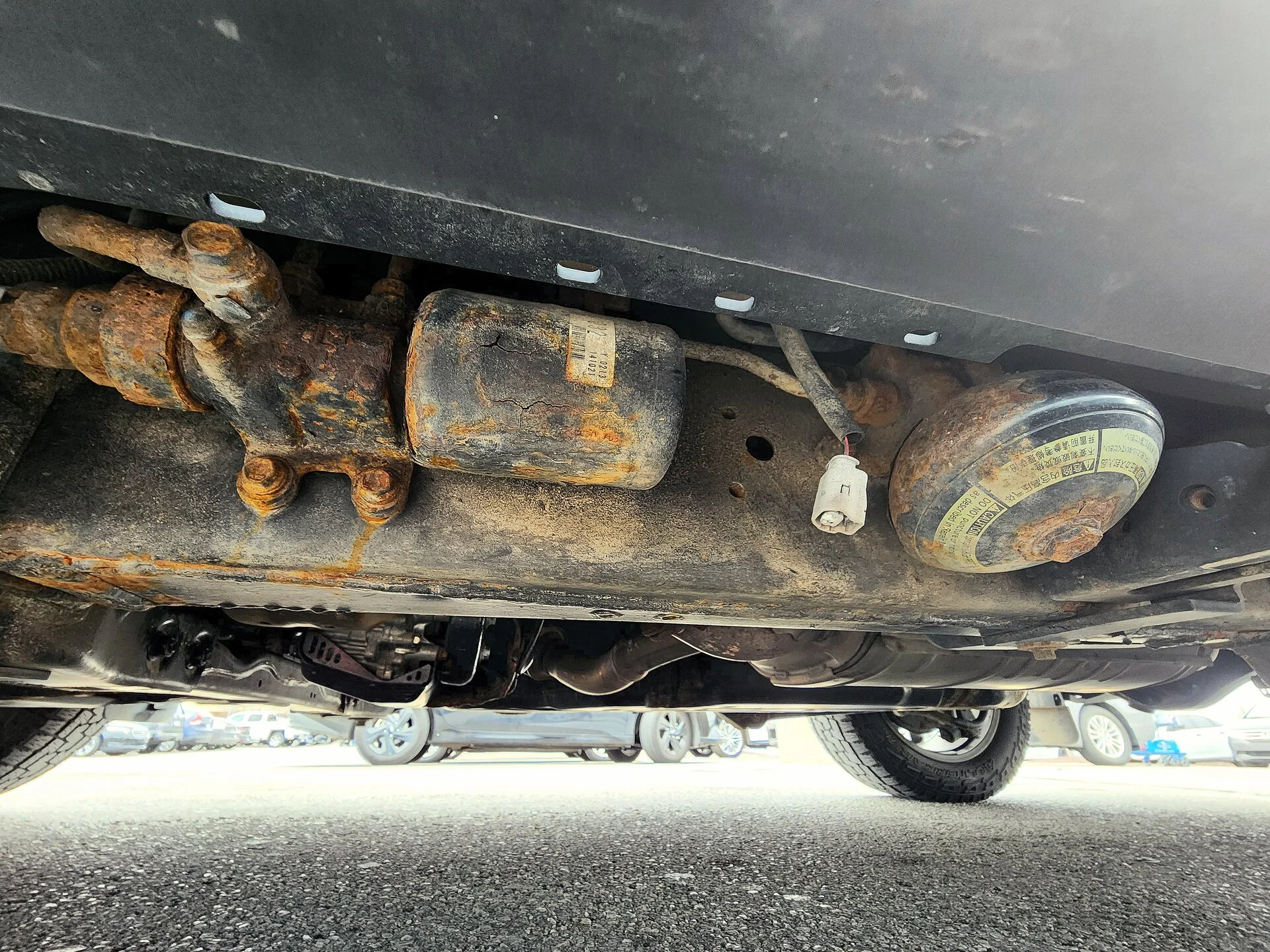

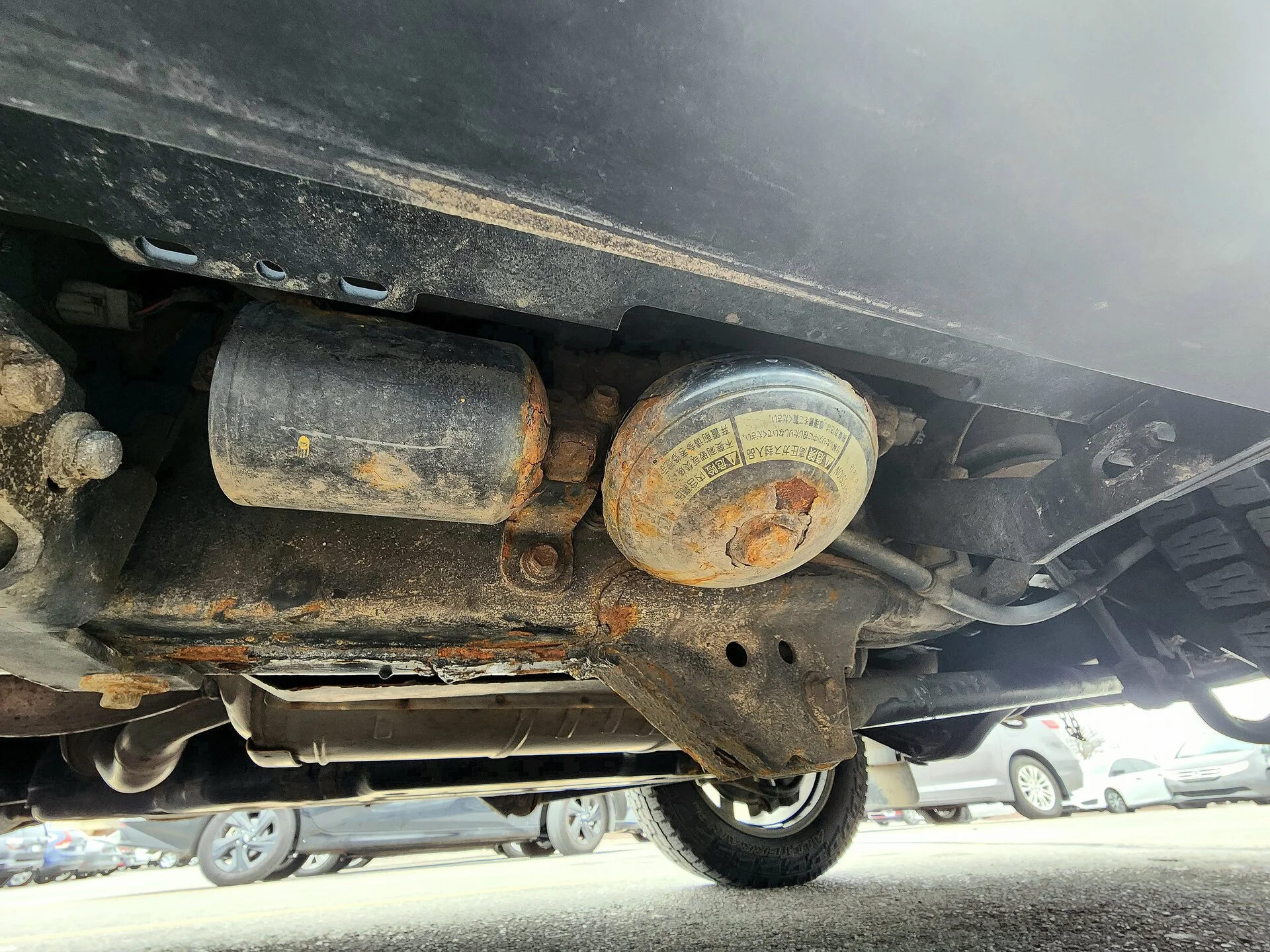

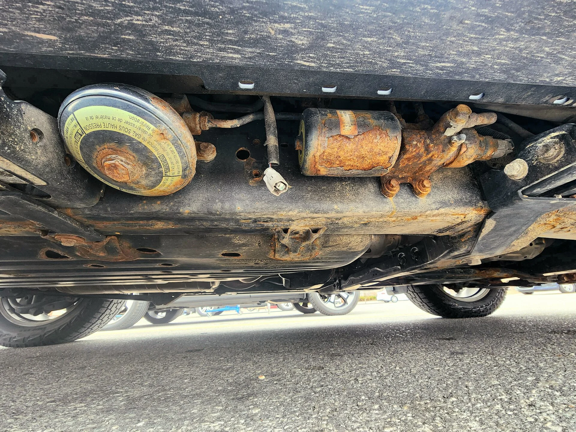

Here's an update of where I'm at with my AHC repair job. I posted this in a few other threads as well.
I spent 4hrs in the garage last night, wrestling with this line that needs replaced, and it will not budge! The connectors on both ends of the line that needs replaced, are so seized on. But it's not just line.
After removing the plates from the Slee rock sliders, and actually being able inspect the accumulators, and bleeding valves, and being able to climb under the rear to work on the busted line, it's blanantly obvious that $6k-$7,500 was not spent replacing anything on this suspension system. Everything suspension wise is rusted! The rear passenger side shock, has a hole in the top of the shock.
I've pretty much accepted that I'm going to have to convert my LX570 to traditional suspension. This isn't how I wanted things to play out, but it is what it is.
Plus, the local Lexus dealership quoted me 8.5hrs of labor for replacing the line, and 4hrs to fill and bleed the system. I was told to be prepared to spend at a minimum around $2k to replace the line, and around another $400 for them to bleed the system. They also told me, that if my bleeder valves and accumulators look bad, or are rusty, then they will pass on the work. Here's a few pics of my accumulators.

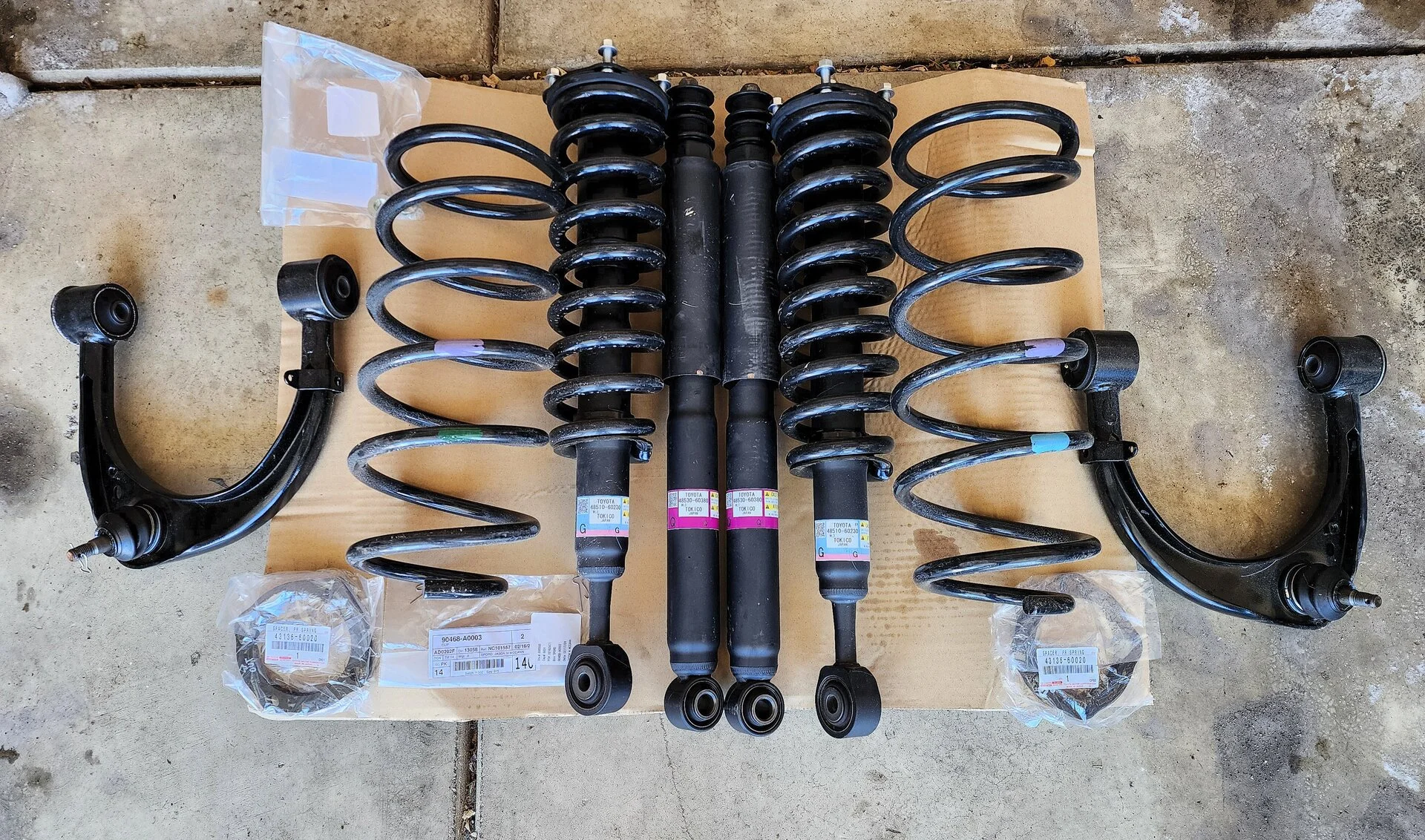

I ended up getting a pretty great deal this past Friday on a set of 200 series L.C. suspension that has maybe 5 miles on it. The Cruiser it came off of had OME BP-51's installed on it fresh off the truck at the dealership before the Cruiser went out on the lot. It may not be a set of BP-51's, Icon's, or King's, but it will get my Lux back on the road until I can get a suspension system installed that matches the comfort the AHC suspension had.
Now comes the fun part of removing all the old suspension...😬

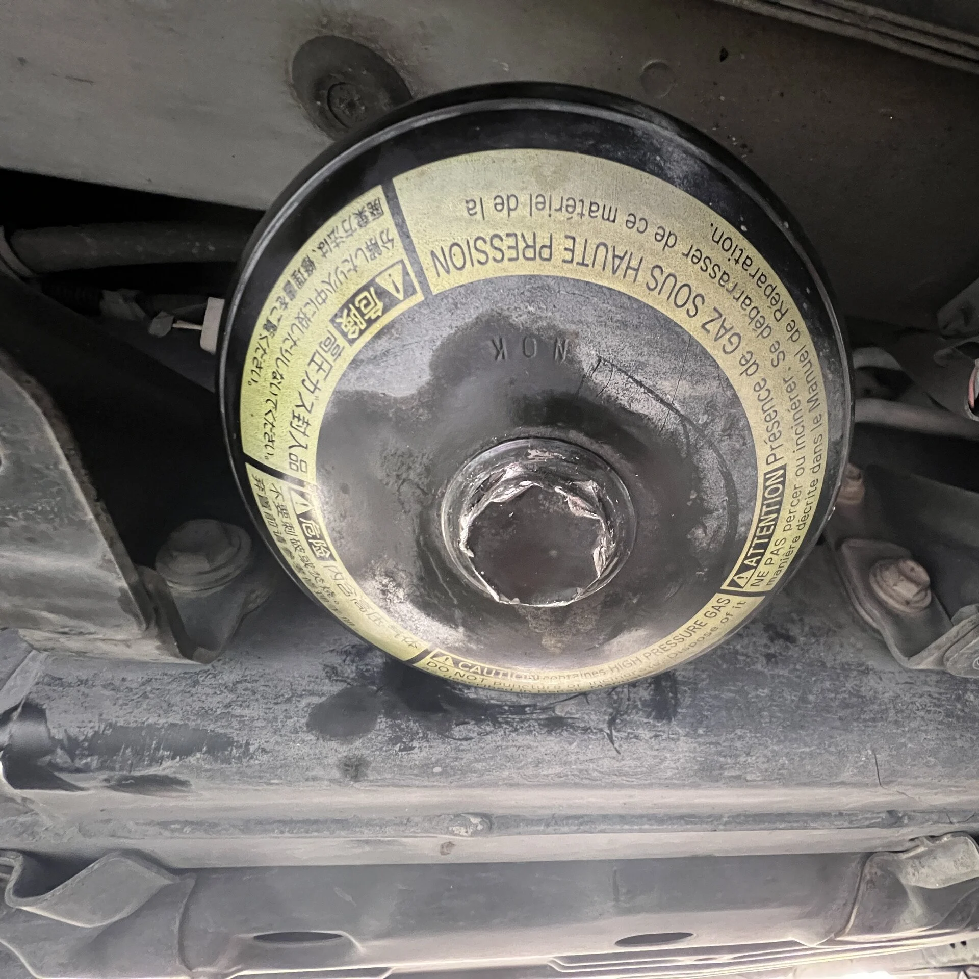

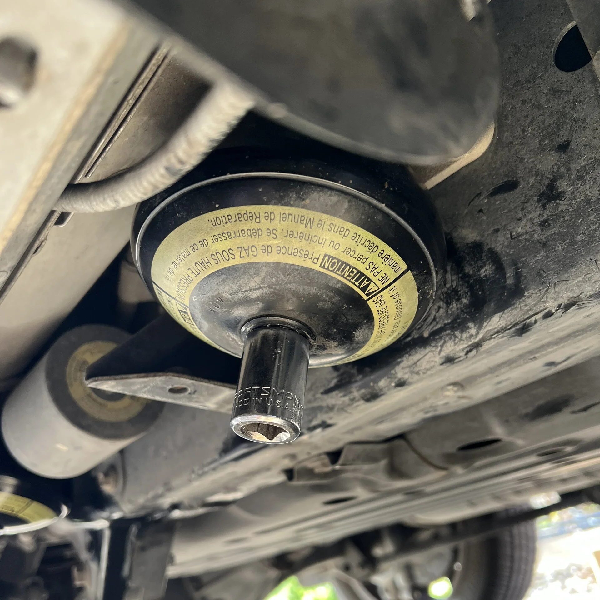

Gah. Replacing globes on my new-to-me LX this weekend. This process was flawless on my last LX. This time, not so much.
Successfully replaced 3 out of 4. Managed to strip the bolt on the front passenger globe. Used a Dremel to grind it down and hammer a smaller socket on there, but that stripped as well.
I tried drilling into the side, so I could insert a bolt for leverage and loosen it with a wrench. I got a few millimeters deep and had to give up. Never penetrated the gas chamber. LX was already bled and on the bump stops, so I had no leverage with the drill and I kept sheering off bits.
Called it quits. Heading to a trusted Toyota fella in the AM to see if he can spare a lift and a tech for 20 minutes.
Career-wise, I’m 7 for 8 on these things. Could’ve done two full swaps with the amount of time I’ve messed with this one trouble globe.
Don’t be afraid to punch a big hole in them. The nitrogen will drain slow if you drill slowly. I ended up making a hole big enough for a pry bar.
I’m not afraid if it - that’s exactly what I was trying to do. I’m just out gas and time. I don’t think my bits were the right ones for the job
Which globe was it and what did you use to make the hole? Any chance you have pictures? I’d like to see your angle of attack.
Not a great pic
Another option is to put a 3/8-1/2” hole in the red circle and use a flat end punch and hammer in a counterclockwise direction to knock it loose. This is what I had to do to remove the accumulator stuck onto the KDSS valve I dissected that was riddled with cancer.
Thanks @tbisaacs for the pictures. Definitely used that post as my point of reference for attempting to drill it out, but didn't realize they were your pics.
And same brain, @bloc. That's exactly where I started my punch/drill process. I just ran out of daylight, drill bits, and kid-free time to get the job done before an upcoming camping trip. Already booked time with a local toyota mechanic to make fast work of this last one.
