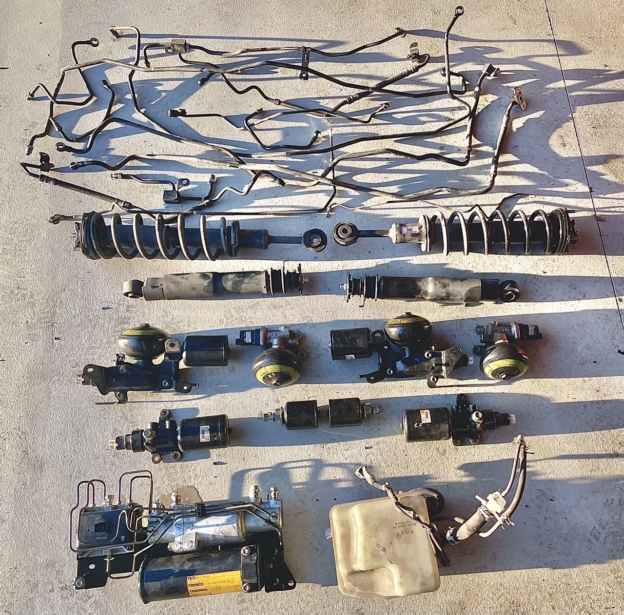

Hi,
For anyone curious what the system looks like out of the vehicle, here it is!
While I was ripping it all out, several things went through my head, including how nicely engineered it all was in the vehicle, but also how complex it is, and also how I could not see how one would do a successful flush without major disassembly.
Not pictured are the under sill protective guards or ecu.

Hi,
Greg.

Hi,
Greg.
It certainly is more complex than a traditional suspension. But it does more than a traditional suspension.

My main thought it the length of some of the lines, particularly those going to each shock, with them being a dead end with no bleeder. As opposed to say brake calipers with the bleed at the destination.
Obviously any flush is better than none.
Just noticed you are in Australia, was going to offer to send you a shipping label to dispose of all those spare parts.
