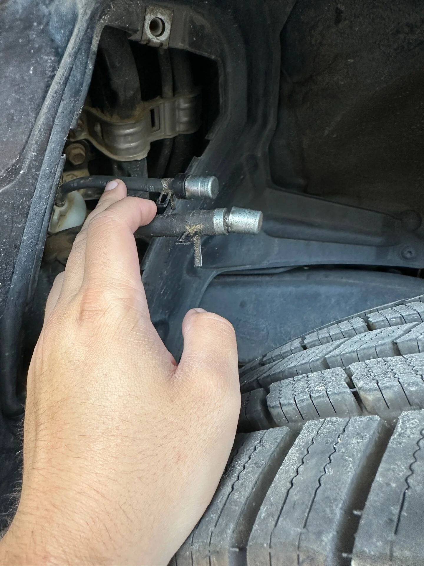

After helping @paulunm I decided to bleed my system again, I saw an earlier post about cleaning breathers and noticed mine are broken. Anyone know if this has any affect on the system?
I bought new ones as they are cheap but am curious.
PN are 90930-03097 and 90930-03159
I didn’t even know there were 2 of them, now I have to find the other one, not sure the effect. Sorry.

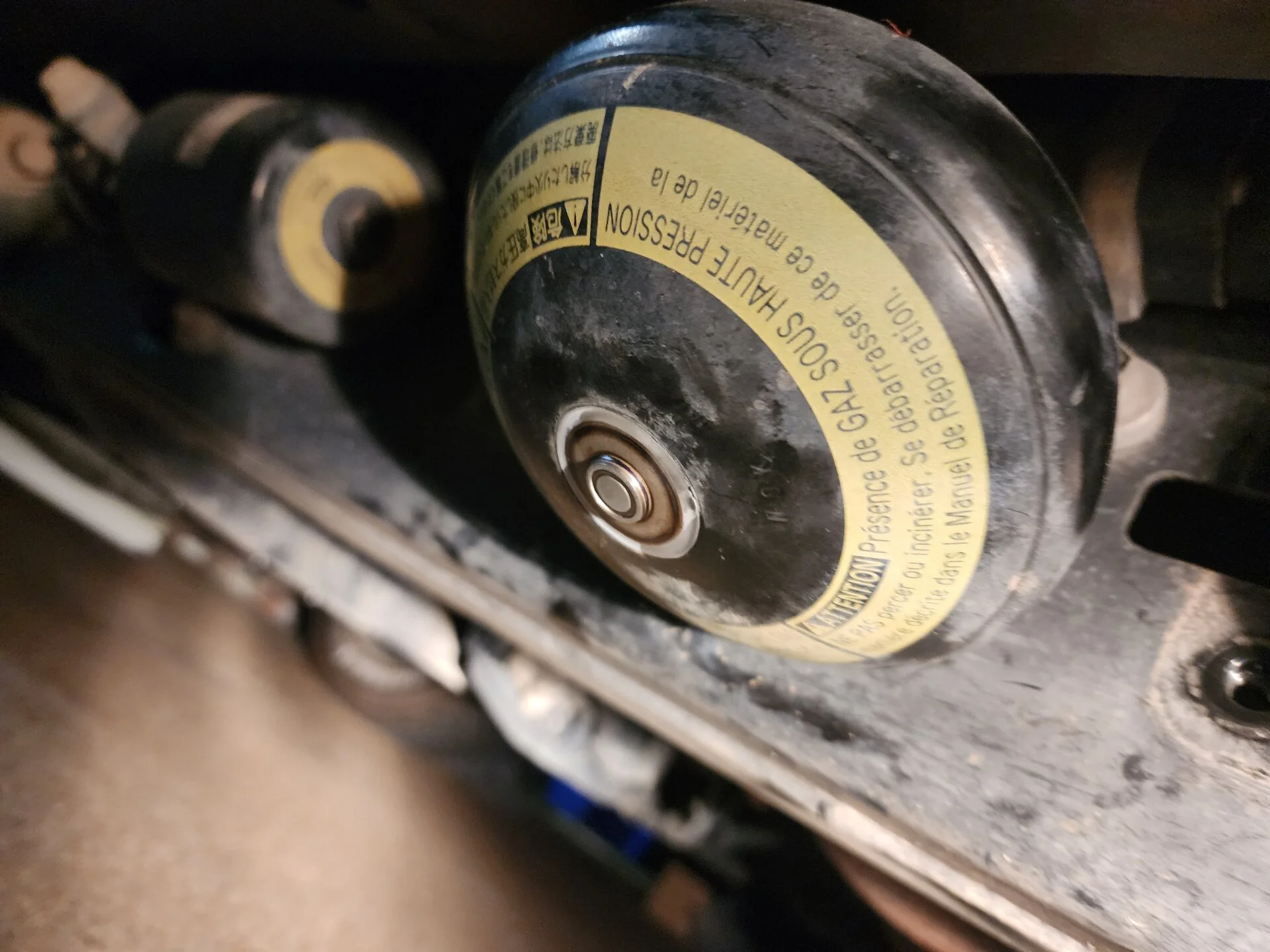

Help!
I used a 12 point 21mm and stripped one of these. Any methods that don't involve a special extractor that's not available this time of night?
drill a hole into the globe, jam a huge screwdriver into it and turn
Well I was able to get some vise grips on there and a pipe. It held . . . Held so well that this happened
I mean if it will break that thing off and not budge then F me. It's going to the shop for something else tomorrow and I may have to pay them to do it. Other 3 globes are on fine.
If I drill a hole is it drivable if I can't get it off? I wouldn't think so.
You’ll get it off! I had to drill a hole in mine and jammed a pry bar in. Came right off.
