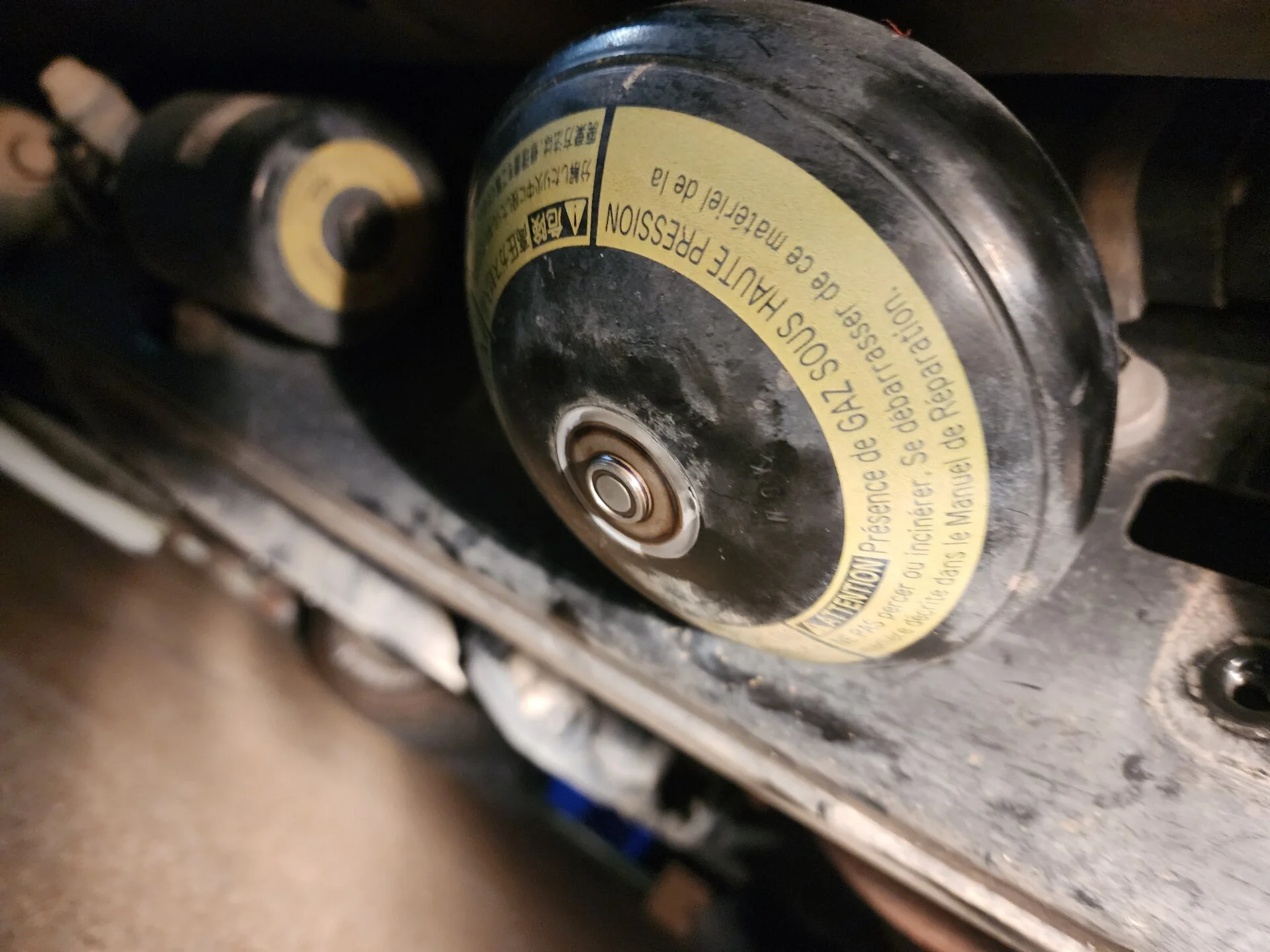

I used a 12 point 21mm and stripped one of these. Any methods that don't involve a special extractor that's not available this time of night?

My rear globes came off without a problem, but I rounded off the bolt heads on both front globes. Hammer and chisel eventually got them off.
Well I was able to get some vise grips on there and a pipe. It held . . . Held so well that this happened
I mean if it will break that thing off and not budge then F me. It's going to the shop for something else tomorrow and I may have to pay them to do it. Other 3 globes are on fine.
If I drill a hole is it drivable if I can't get it off? I wouldn't think so.
Same thing happened to one of the rear accumulator last June when I replaced the accumulators. I ended up drilling two holes into it and use a long metal pipe to turn it loose. What a pain it was!

Once broken free, they turned out by hand.
