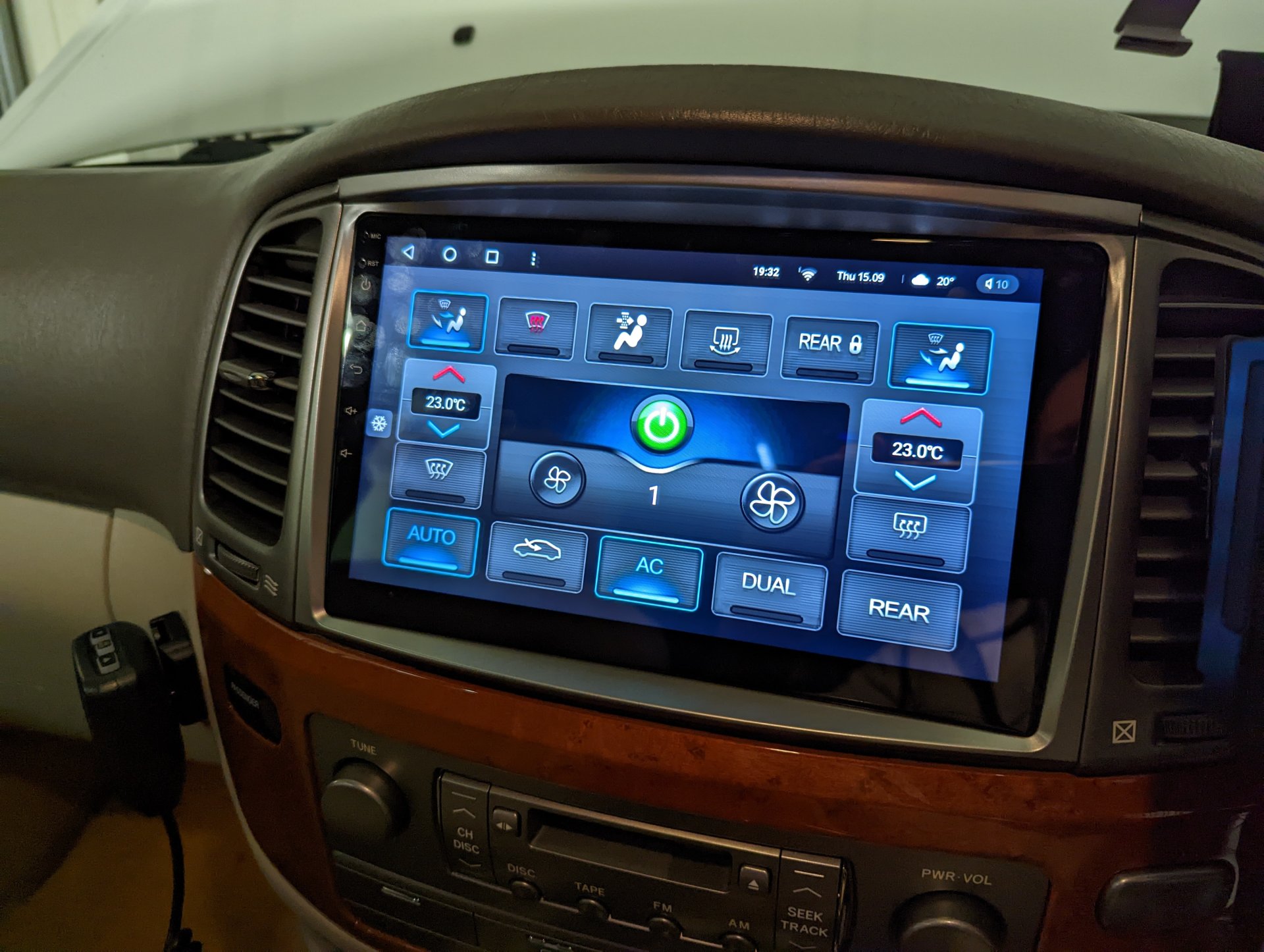

I finally received my CC3 (6 + 128) this week and got around to installing it yesterday with the help of my installer.
When we were wiring it up, everything was working perfectly! Steering controls, AC, Carplay etc. No hiss, excellent sound quality, power antenna etc.
However, once we connected the camera (into acc) and buttonned up the system, the AC controls stopped working completely. We didn't make any change in any of the connectors so I am guessing it's some software setting that's gotten messed up.
Removed the camera completely and now we have bare bones AC controls. It's very strange, it can only control the temperature and nothing else. But when you change the temp up or down, you can see the fan speed change as well.
Any idea how we can fix this? I am not sure how to reset the system or factory reset it. I tried the 168 code thing but it gives me three options.
If I select the first 2 (network reset / app preferences reset) nothing happens. The last option says factory reset but I haven't tried it as yet (unsure whether the teyes launcher / firmware etc would vanish)
If someone has successfully factory reset their system, would really appreciate the steps on how to do it.

Ok so I have updates.
I factory reset the teyes and for around 5 minutes the AC controls worked perfectly, but then it reverted back to only controlling the temperature. Did a reboot as well at this stage but it didn't help at all.
After the second factory reset, it was exactly the same as above.
I then went into the teyes app and updated the canbus following the instructions on the screen and BAM. everything is working now!! I took it for a short drive around the block and it all functioned normally including all AC controls.

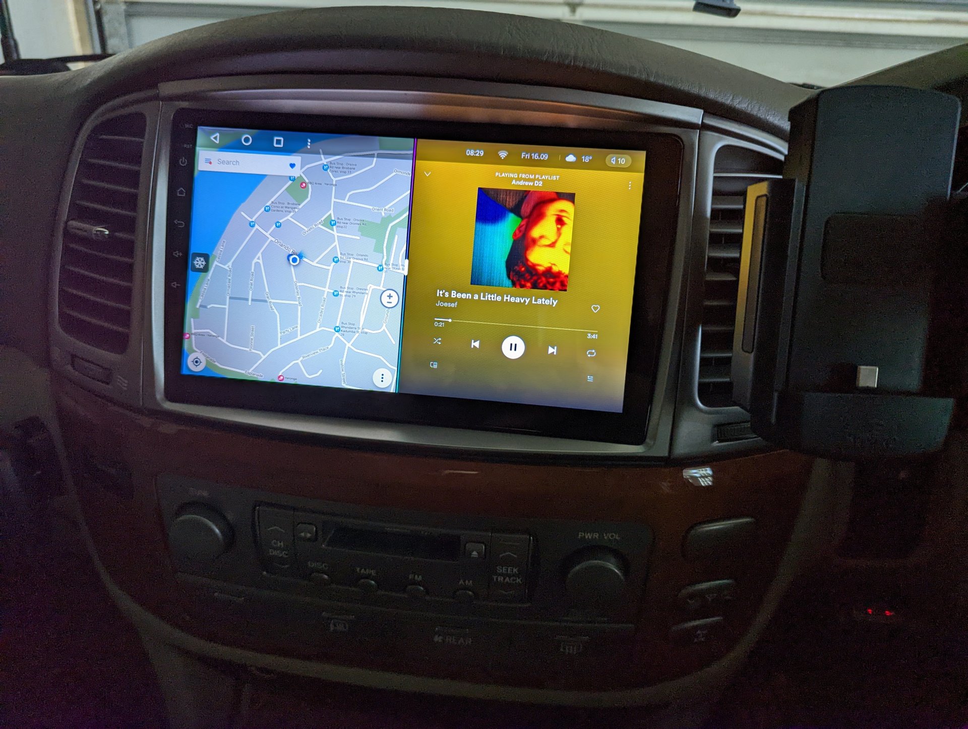

07 LX470 here. Install today, along with phone cradle, Oricom UHF in the ashtray cut out, and rear USB ports.
  • Sound - YES (and much better than factory), Spotify installed
  • Phone - YES, USB 1 wired into phone cradle, Android Auto tickety-boo
  • Steering wheel controls? - YES (remember not to go over halfway, otherwise some weird distortion) - use main volume knob and work out best mix
  • Climate - NO (Canbus is LX(HZ) - Toyota - LC100 - High. and assistant has climate
  • Climate - YES for rear (the switch at the bottom of the console)
So will need to work on swapping a redundant plug maybe. The T'eyes photo on their page for option C is for an LC, not an LX.
  • Climate - NO YES (Canbus is LX(HZ) - Toyota - LC100 - High. and assistant has climate
When youtube starts working again, I'll share a short video of the sound. It's very good indeed.
SUCCESS. ashkapur you're a legend. Did the canbus updates, from left to right.
Edit - replace UHF photo with split screen of Spotify and Sygic (which has offline maps unlike Google Maps)

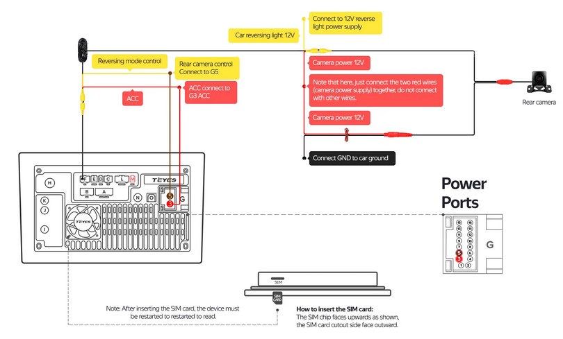

Will the Teyes Sony AHD fit in the factory location of the OEM backup camera. 06 LX470
Not sure, getting the Sony rear cam in next week, audio installer seems to think it won't be hard, having done a few other Landcruisers.
How about your backup camera? is it still working?
Backup camera doesn't work with the CC3, apparently the CANBUS adapter doesn't get a reverse feed.
My installer looked at this wiring diagram, and is also going to tap into the reverse wire at the rear of the LX when he comes back.
Also - here's the rear cam wiring diagram from Teyes website:
Also - here's the rear cam wiring diagram from Teyes website:View attachment 3124424

I had the same problem with my install initially. The canbus adapter absolutely does not send a reverse signal which is also what I originally thought. You need to tap into the reverse lights where your camera is (not the OEM camera which is the wrong voltage) and use that as the signal. The wire that comes with the Sony cam has everything you need to supply power to the camera, get the reverse signal back to the head unit, and the video signal itself.
Installer came today, and after running a wire to the CC3 harness, said:
"Do you want to reuse the factory camera - I tested in on my screen and image is fine". He noted he found a reverse trigger wire in the camera harness, tapped it and "voila".
Call me surprised - what about the 6V camera (HU is 12V)?
He installed a 12V -> 6V converter somewhere near the CC3, and then tapped the black/red wire in the camera harness, which is easily accessed in the tyre tools storage area.
The only issue - the CC3 has these guidelines which I can't find out how to remove. There's a "Cam REC" app which shows the image without the lines...
