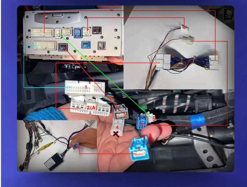

So I just got mine in. Attempted to install just matching plugs to whichever plugs fit. Now I have this random plug that has no home. Unit powers on but I have no AC or Sound. Does anyone else have this issue with a random plug from the vehicle without connection? Or am I unlucky and received the wrong harness? I wish these came with better install guides.

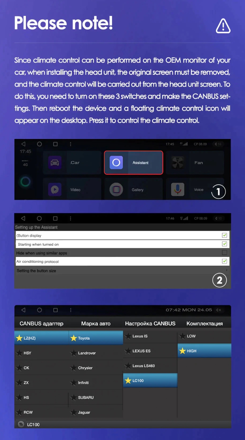

Make sure you run the Teyes app thing i forget what its called. The canbus settings for your model car. Its critical.

@xswl That connector from the vehicle side goes into a "conversion" connector. See pic below from the link below the picture.
Also, TEYES again updated their website with some additional instructions on getting A/C controls to work with a few options selections and a reboot.
Setting the canbus to LC100 (as pictured in quoted post) was critical to getting mine to work properly. Previously, I had set it to an LX470 setting (I have a 2005 LX) but the A/C controls would not work. Tried multiple factory resets with no luck. Then I stumbled upon this post, changed the canbus settings exactly as pictured and it worked.

I had to change the canbus setting to LC100 for it to work with my LX470 2004. Worked like a charm.
